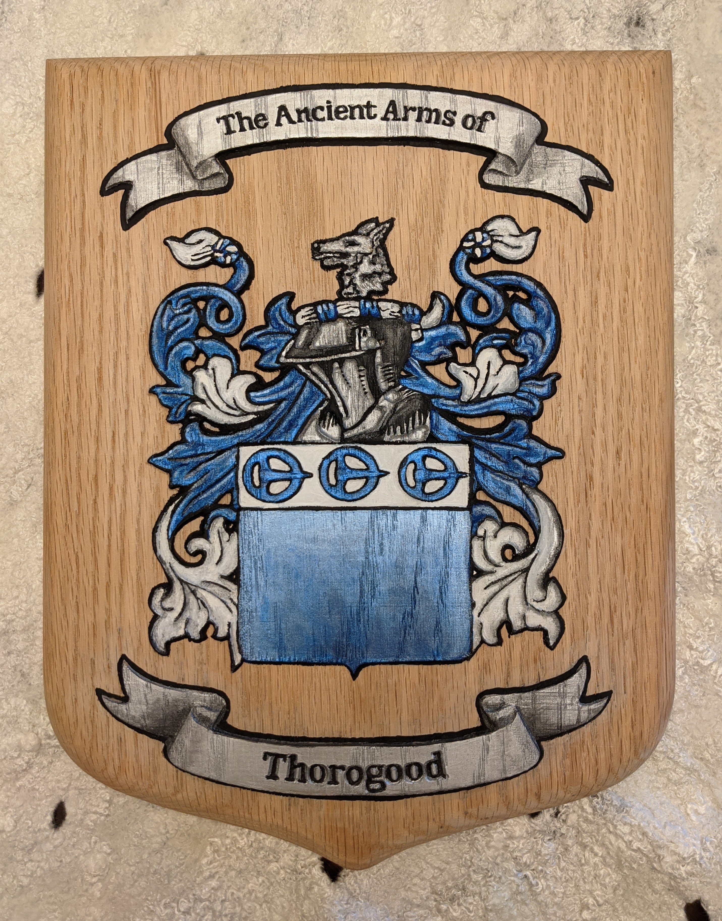

After successfully testing my vertically mounted longmill with some simple pine pockets & cutouts it was time to see if it was up to a much greater challenge - a 3D family crest made from 3/4" oak.
Milling required 4 tool changes.
Layout & Toolpaths: VCarve
3D Roughing Pass: 1/4" 2 flute UC
3D Finishing Pass: 1/8" ball nose
V-Carve Text: 90 degreee v-bit
Profile Cutout: 1/4" 2 flute UC
It’s amazing how little sanding was required to finish the piece. A quick once over with 120 followed by 220 grit and it was ready for paint.
The machine has proven once again that even the forces of gravity can’t stop it from producing amazing works. Very happy.

Very nice! Is that a metallic paint?
Yes, it’s metallic paint from a local craft store.
