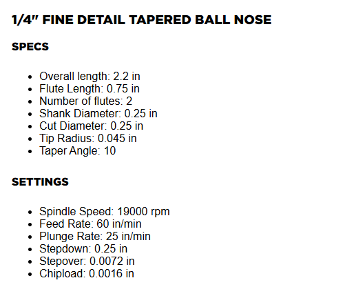

What feeds and speeds do people use for a finishing pass in softwood?
If I follow the IDC chip load calculator for softwoods, I should aim for a chip load of 011"-.013".
But if I follow their bit specs for a similar bit, I should go with a chip load of 0.0016". But this doesn’t take into account the material.
A chip load of 0.01" translates to :
a speed of 10000 RPM and feed of 200 in/min, or
a speed of 20000 RPM and a feed of 400 in/min.
400 in/min is within the Altmill’s specs so should I go with that to reduce machining time ? Or should I go with 200 in/min? Or even slower at 60 in/min as per the bit spec?

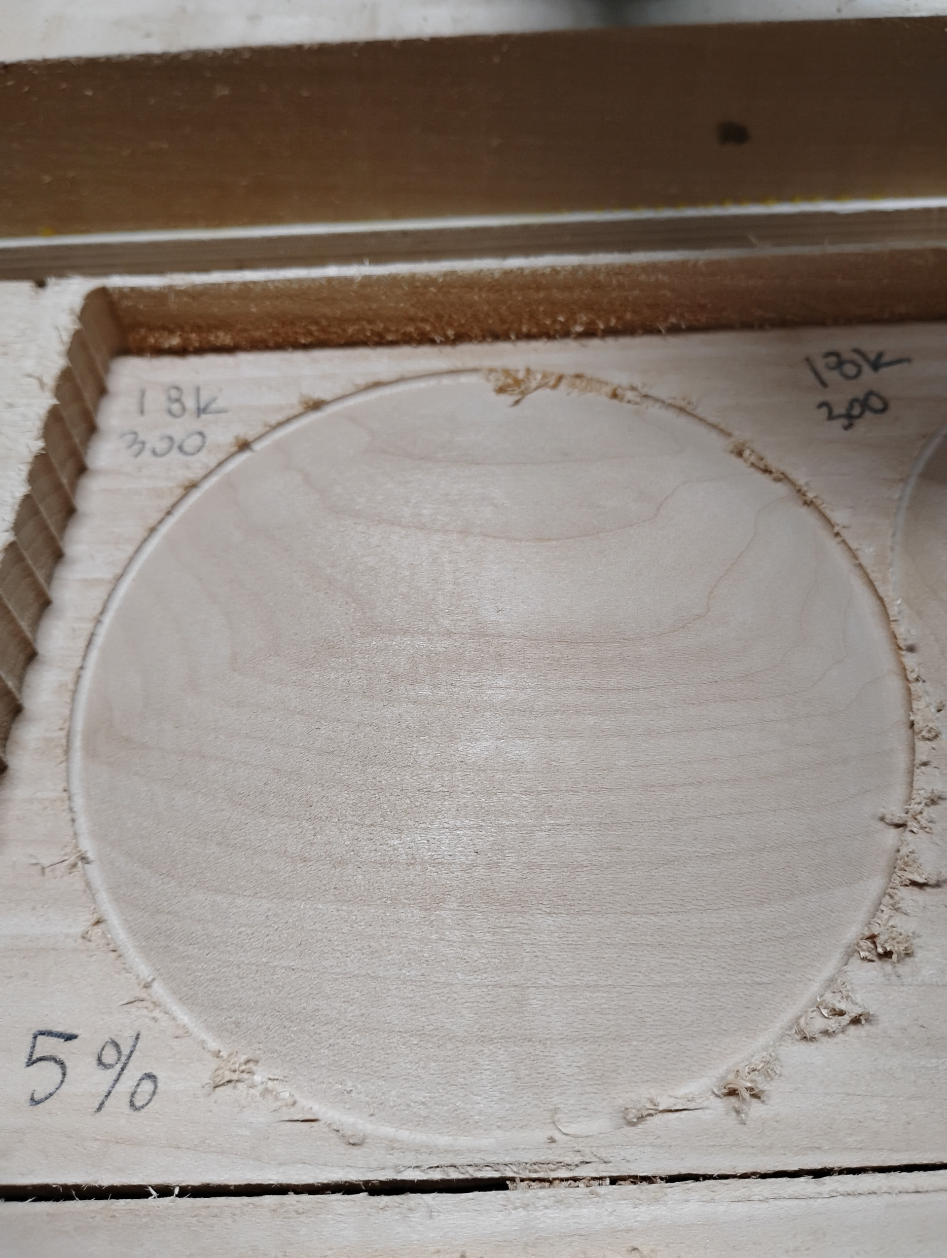

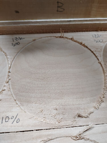

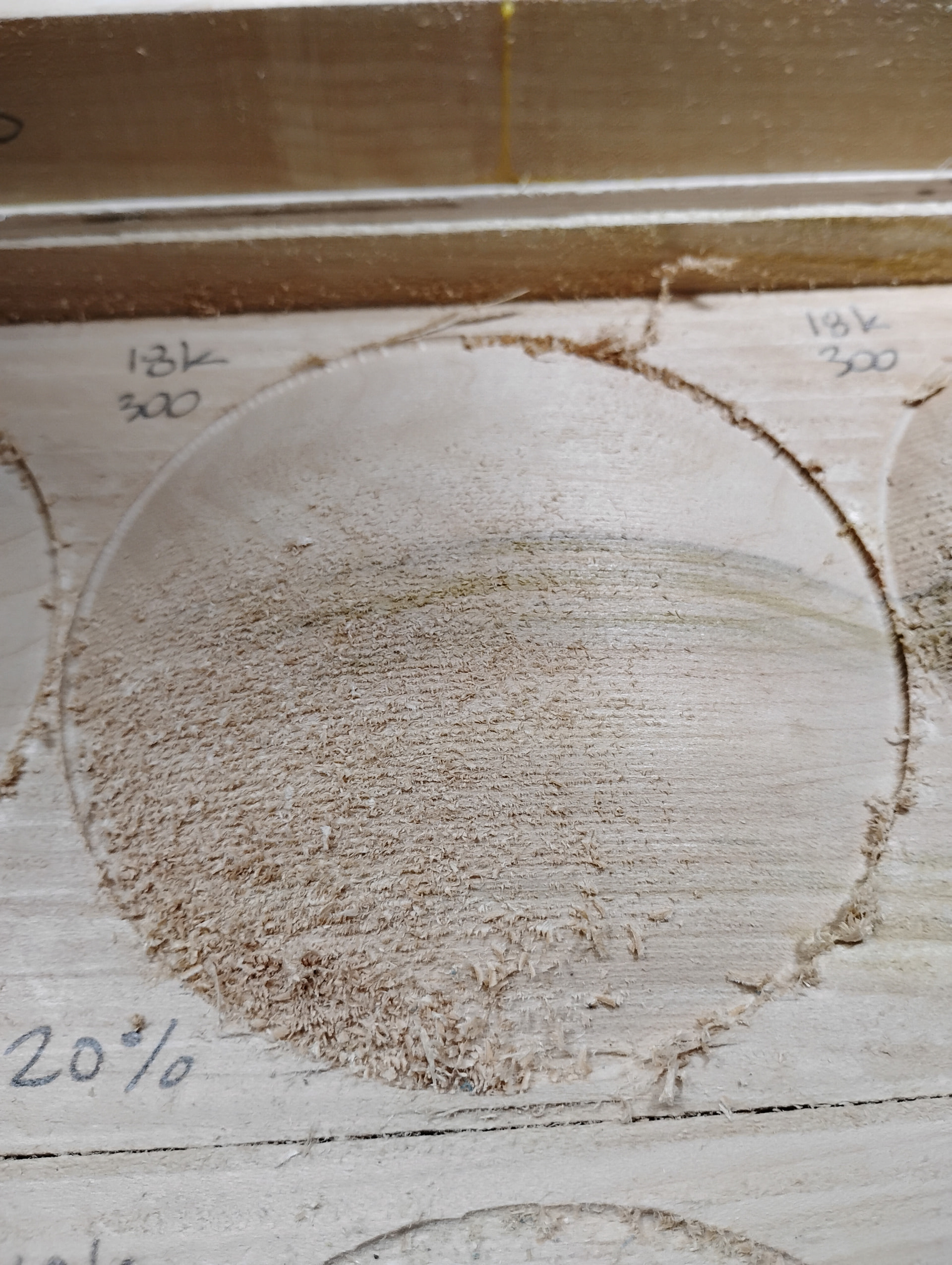

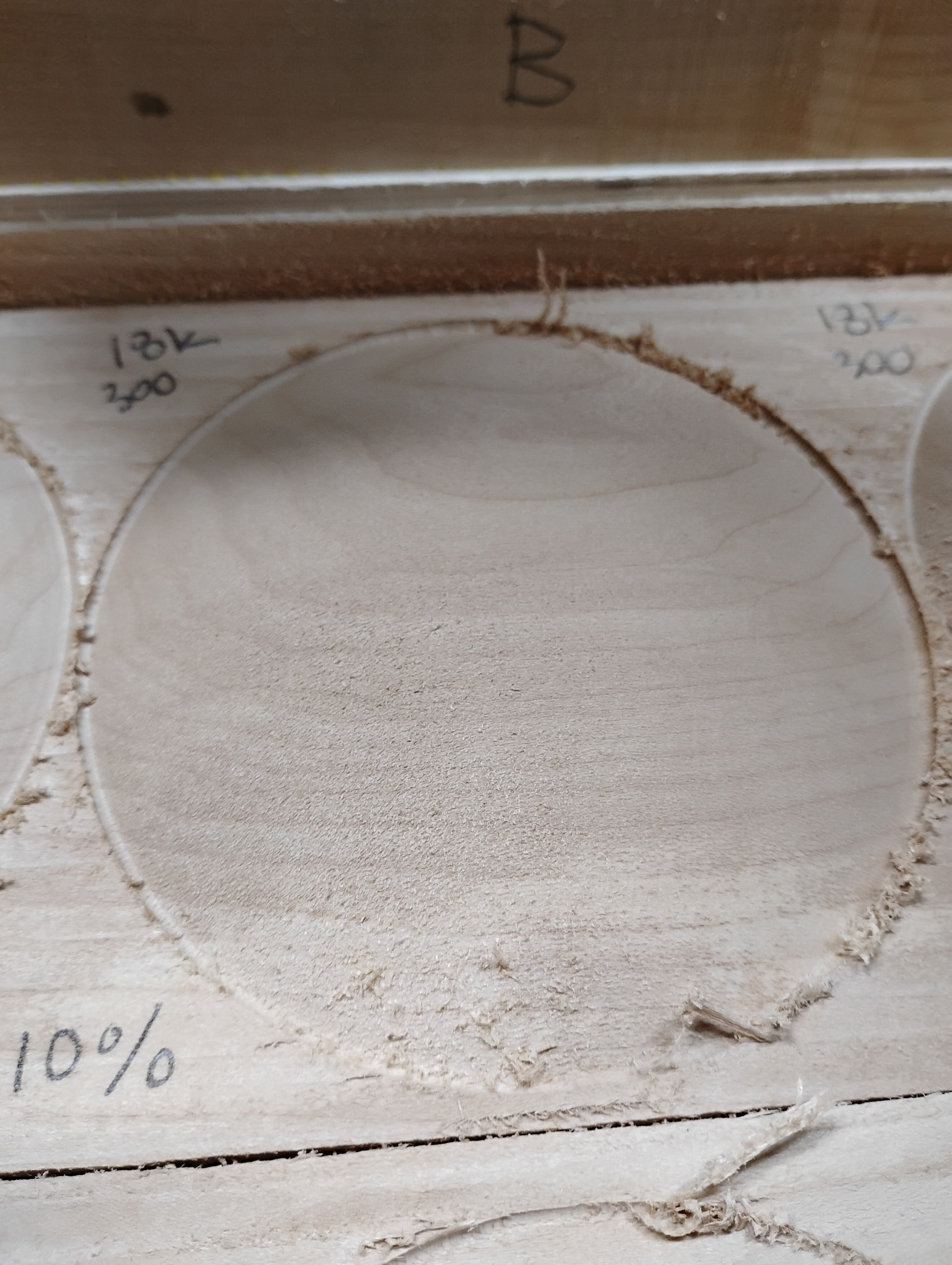

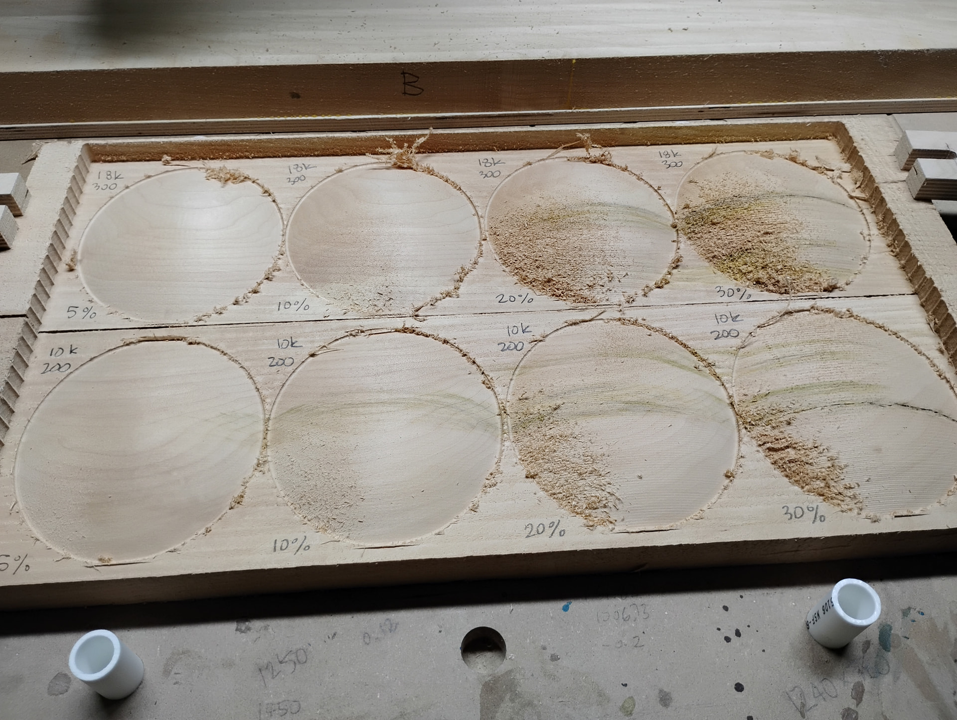

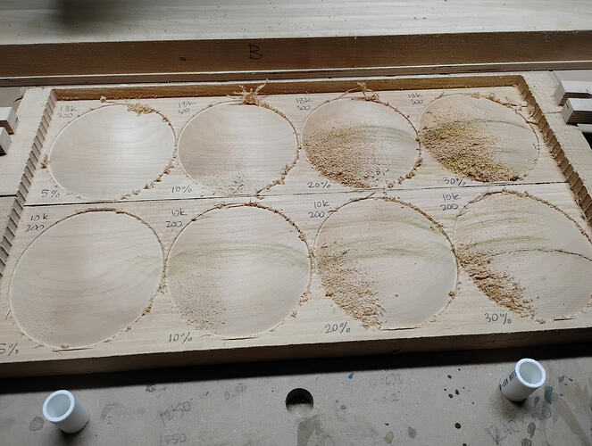

I just did my first series of tests with the following parameters. It’s on a 4" diameter dome carved in basswood. 1/4" TBN with a 1/16" tip radius. Raster cut at 0 degrees (along the grain). In the picture, starting at the top, from left to right:
5% stepover, 18k RPM, 300 IPM
10% stepover, 18k RPM, 300 IPM
20% stepover, 18k RPM, 300 IPM
30% stepover, 18k RPM, 300 IPM
5% stepover, 10k RPM, 200 IPM
10% stepover, 10k RPM, 200 IPM
20% stepover, 10k RPM, 200 IPM
30% stepover, 10k RPM, 200 IPM

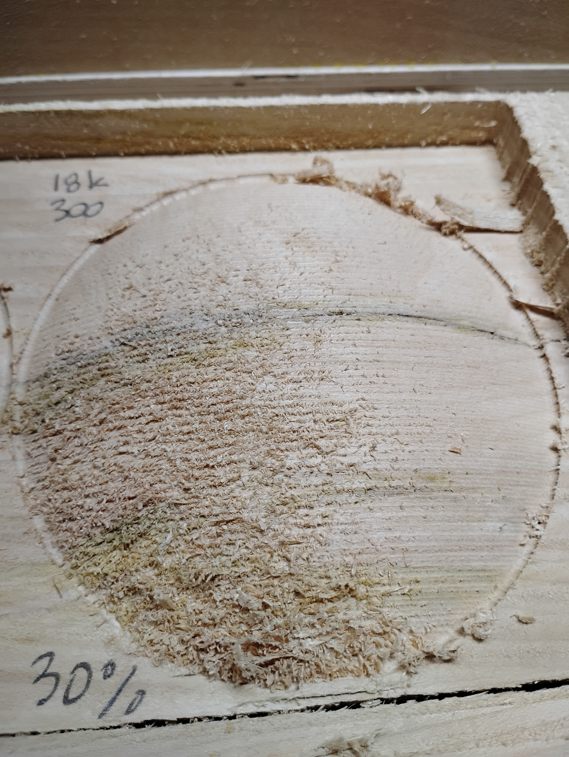

And some close-ups for the 300 IPM feed
Very small difference in quality between 5% and 10% stepover. Perhaps a bit more fuzzies at 10% but the ridges are very small. No noticeable difference between feeds and speeds. Forget 20% and 30% stepover. Ridges are very noticeable and a lot of fuzzies on one side of the dome.

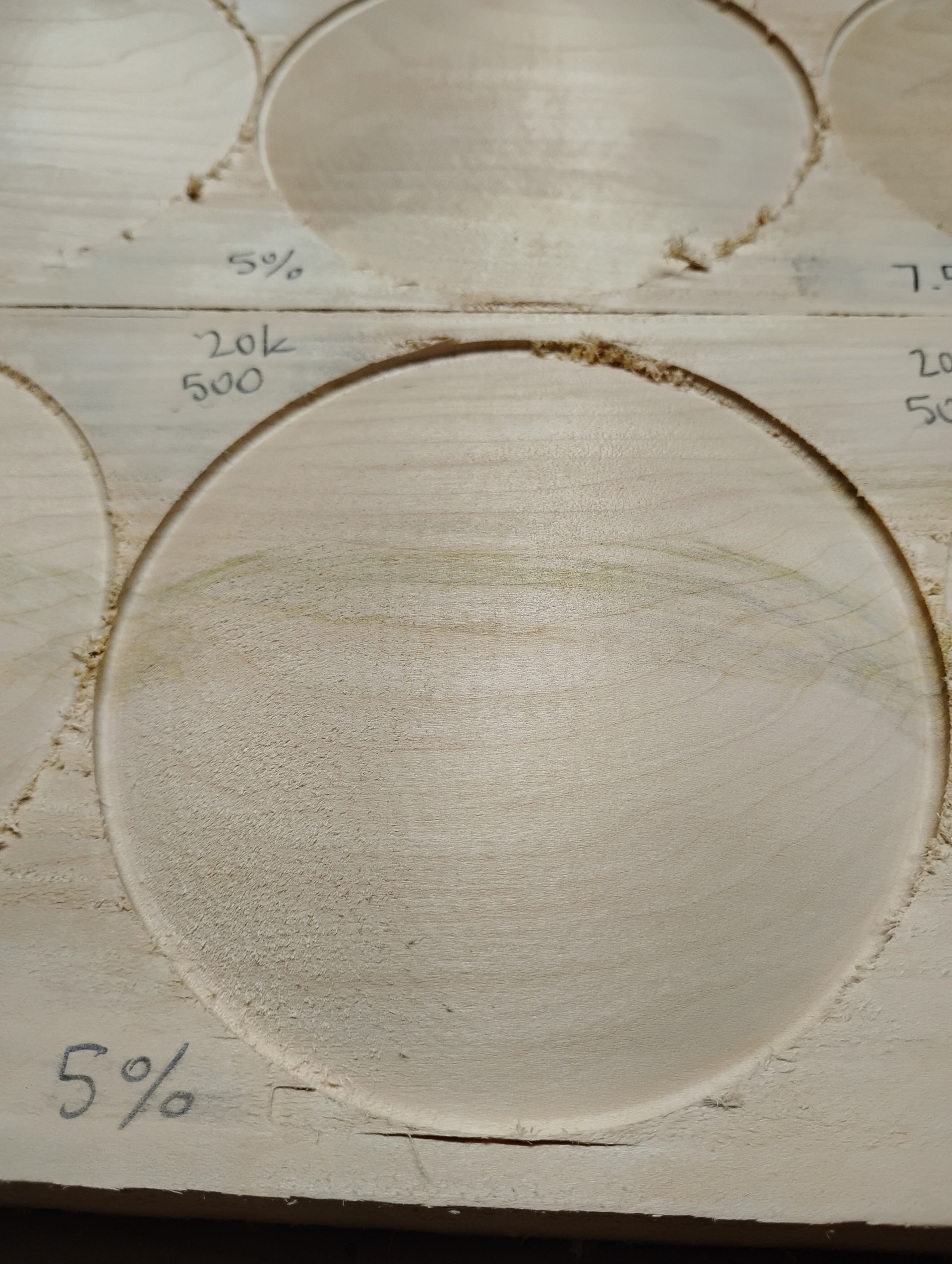

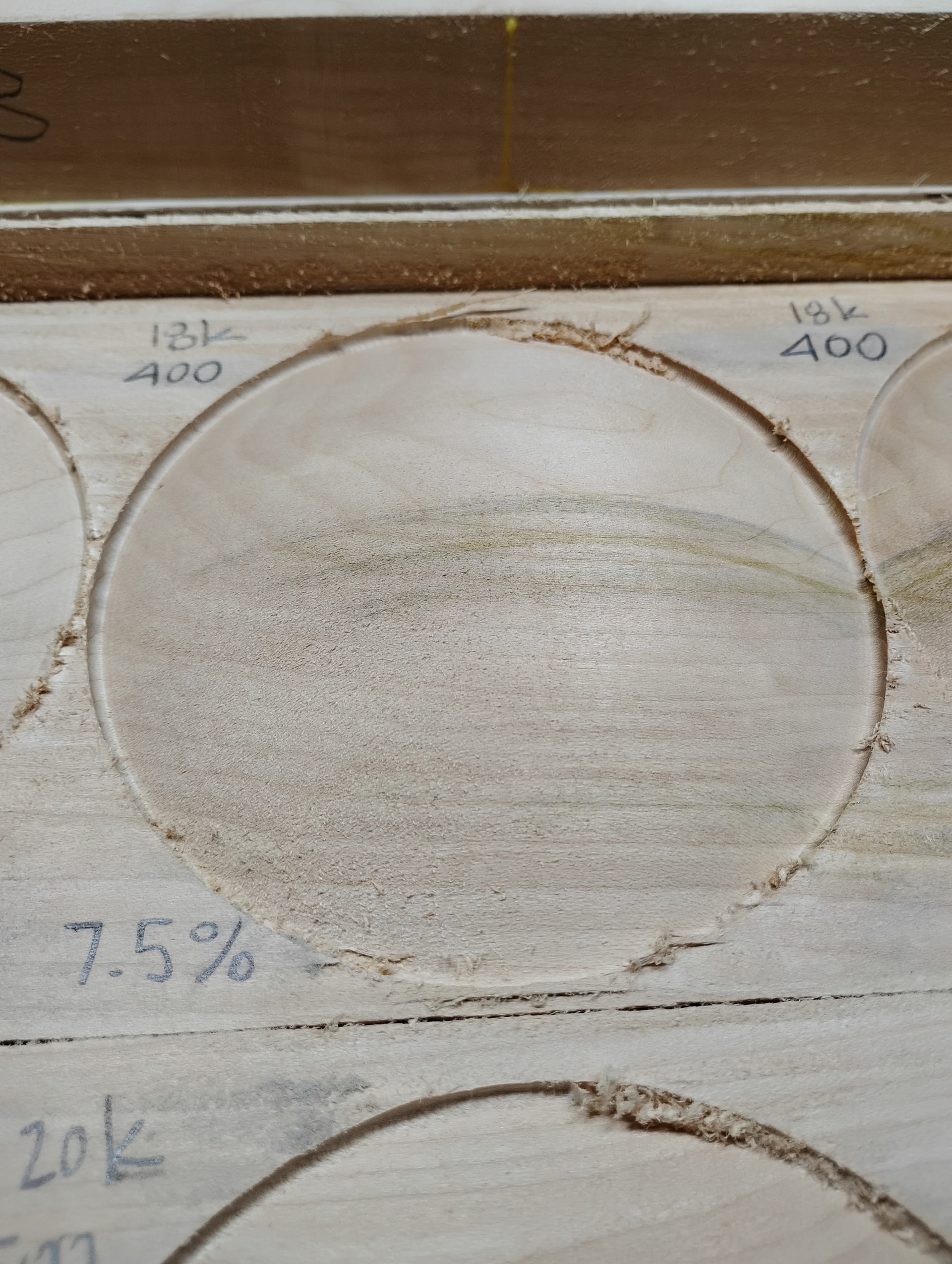

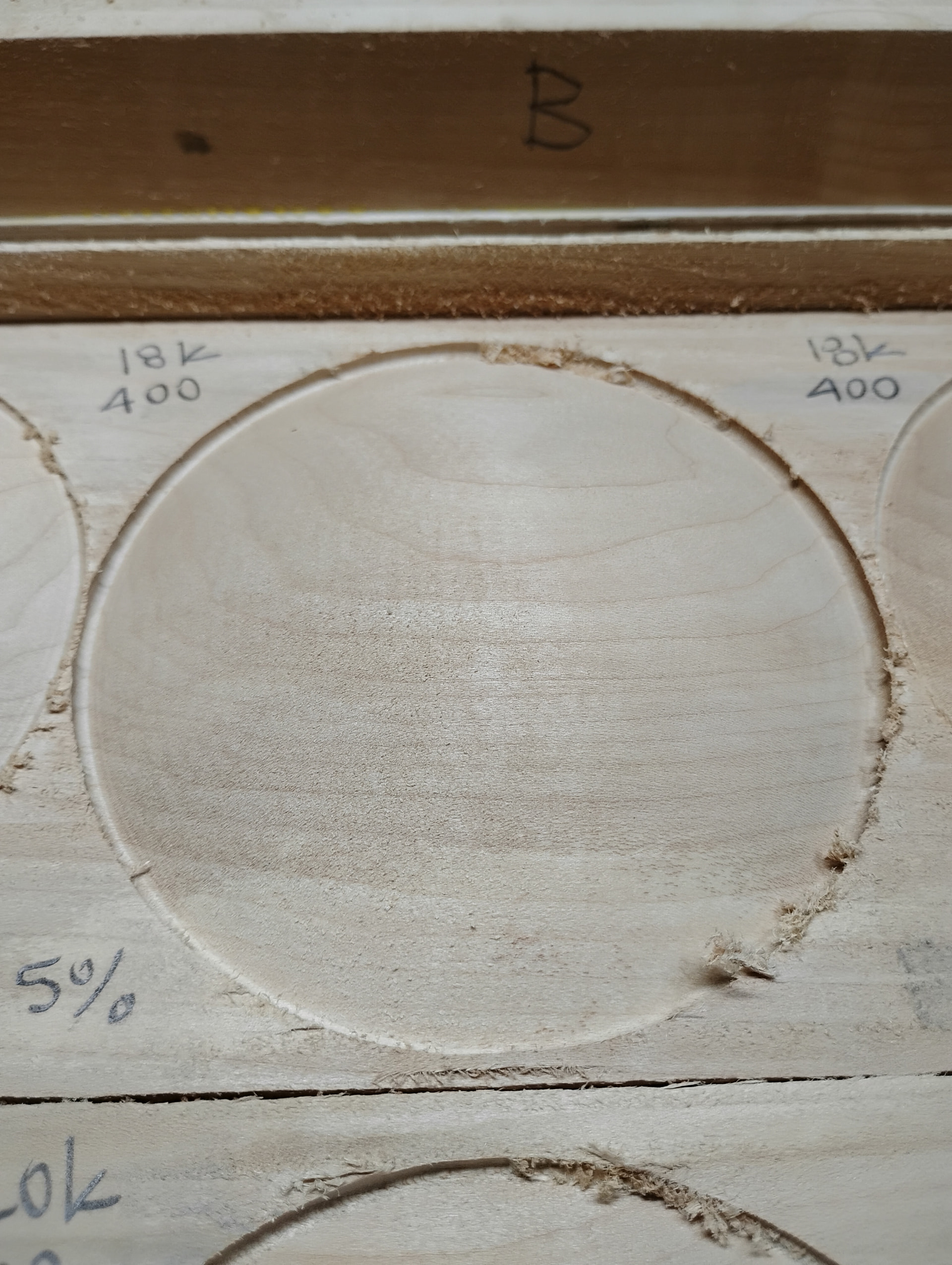

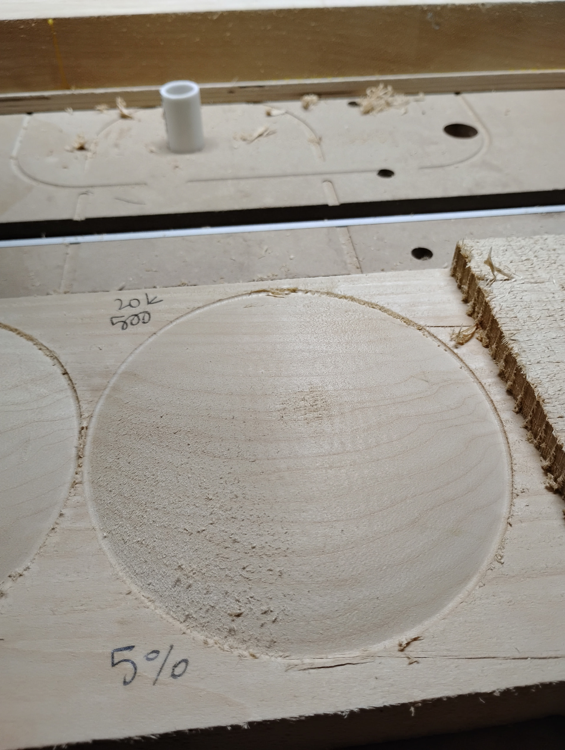

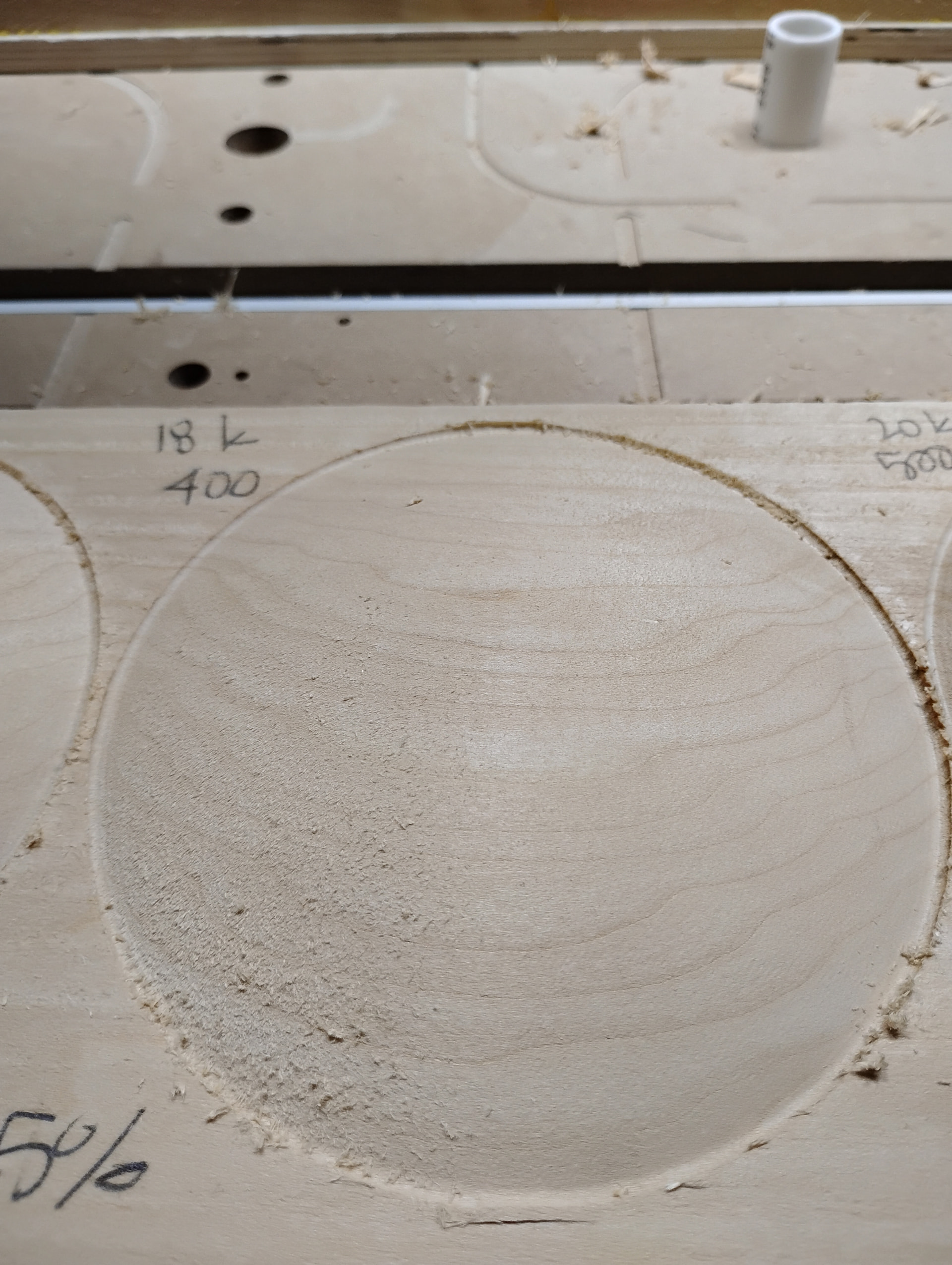

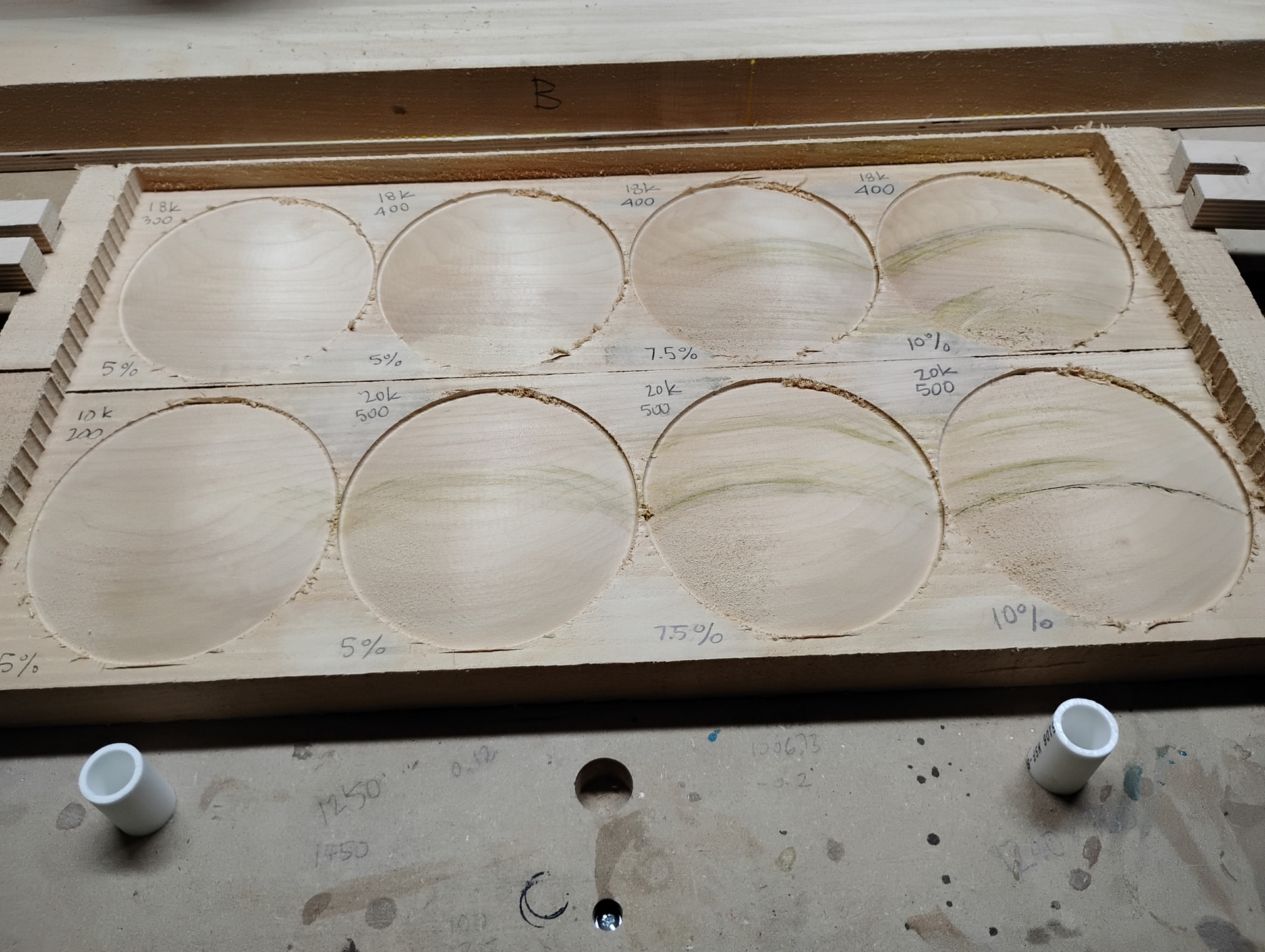

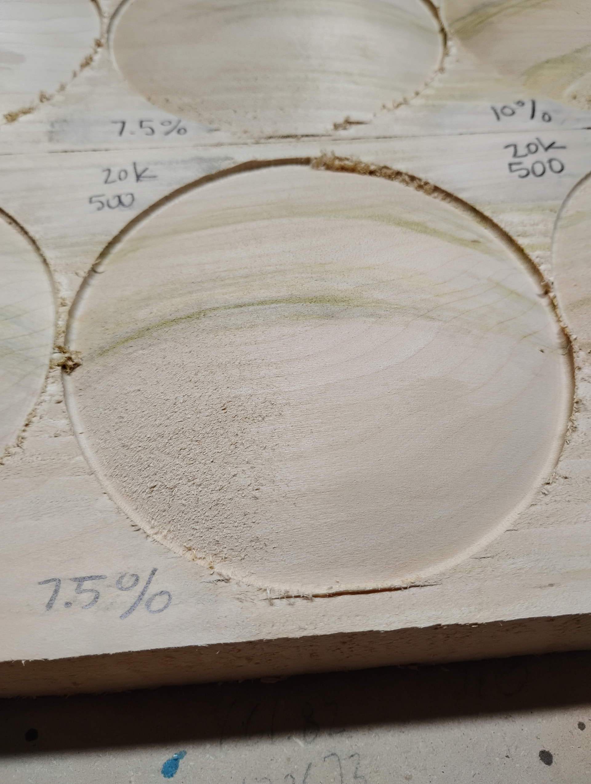

I dropped my Z by 1.5mm and went over the 6 domes on the right with different stepovers and feeds and speeds.
5% stepover, 18k RPM, 300 IPM (from prior test)
5% stepover, 18k RPM, 400 IPM
7.5% stepover, 18k RPM, 400 IPM
10% stepover, 18k RPM, 400 IPM
5% stepover, 10k RPM, 200 IPM (from prior test)
5% stepover, 20k RPM, 500 IPM
7.5% stepover, 20k RPM, 500 IPM
10% stepover, 20k RPM, 500 IPM
7.5% has negligeable ridges but there are more fuzzies. That could be just because of the stepover or it could be because of the location of the carve on the piece of wood and the resulting grain pattern there.
If I had to choose based on the single test, I’d probably go with 5% stepover, 18k RPM, and 400 IPM. But I might repeat the test for a 5% stepover on a different piece of wood to confirm.
That’s what I expected. The other factors that will contribute a lot to the cut quality is the species of wood and angle of cut. With the AltMill and TBN I think you’ll be safe to cut really fast on all but very hard woods.

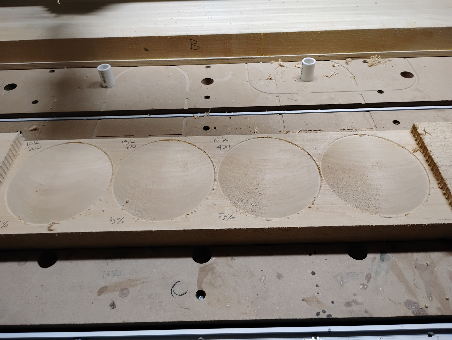

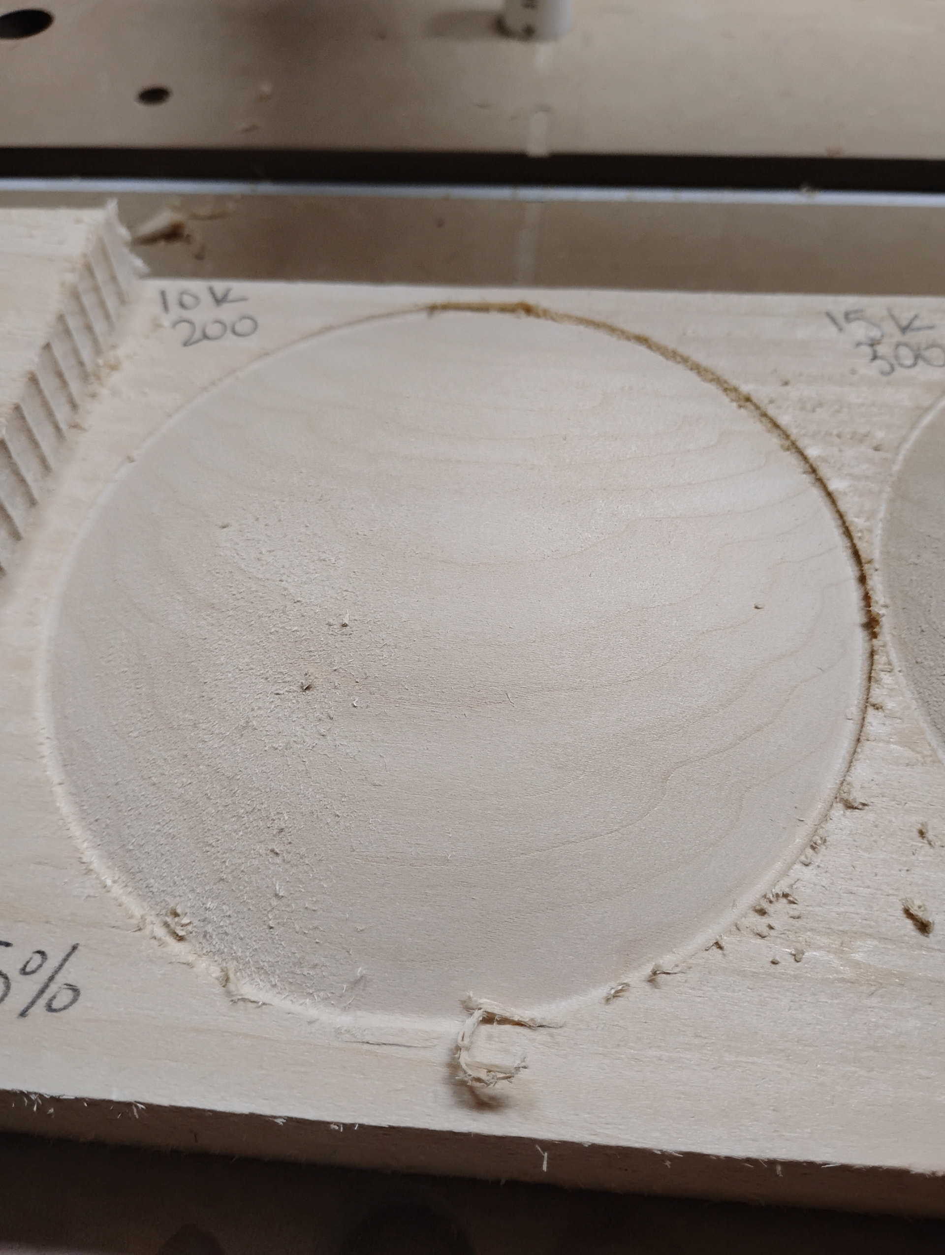

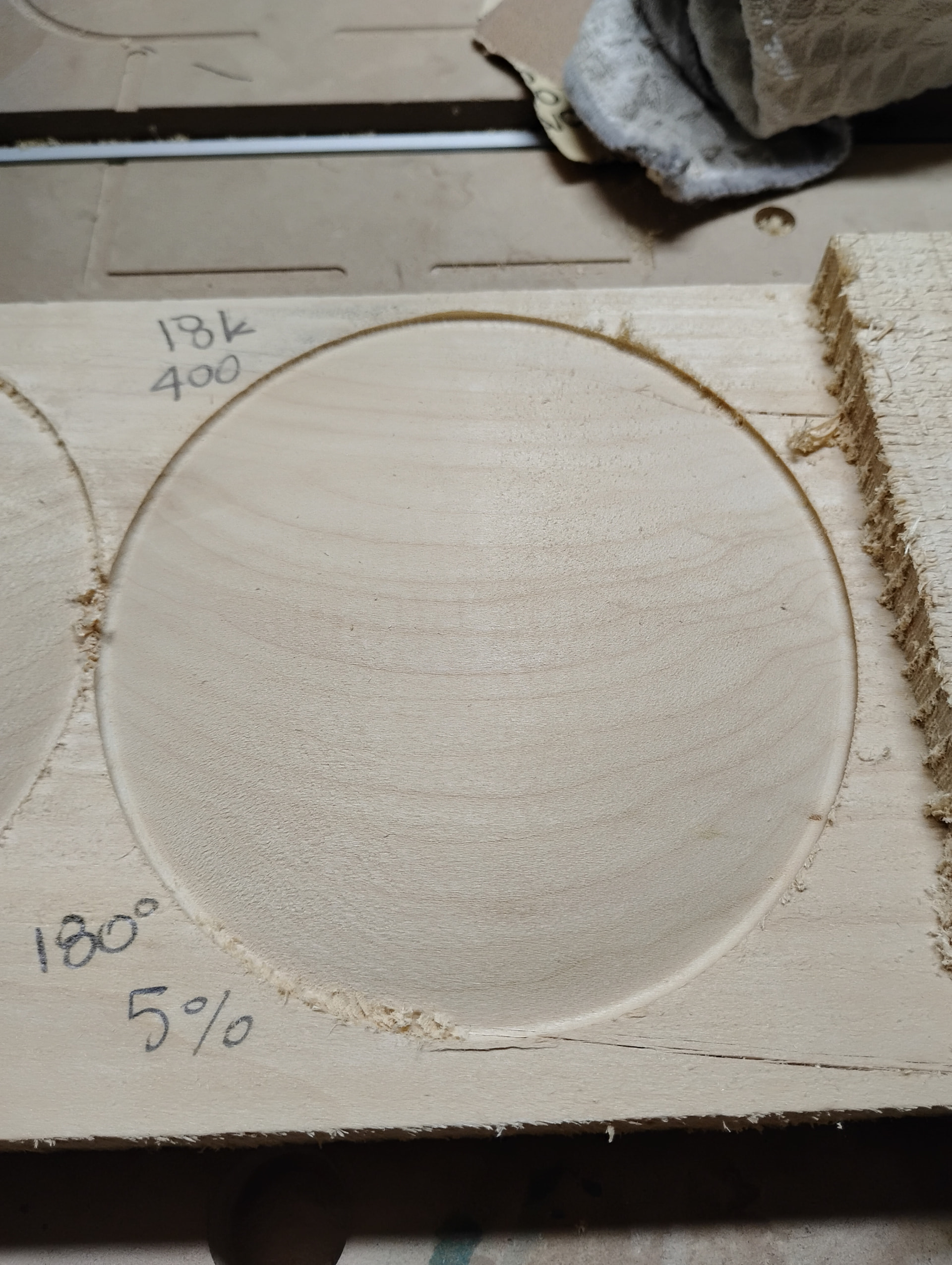

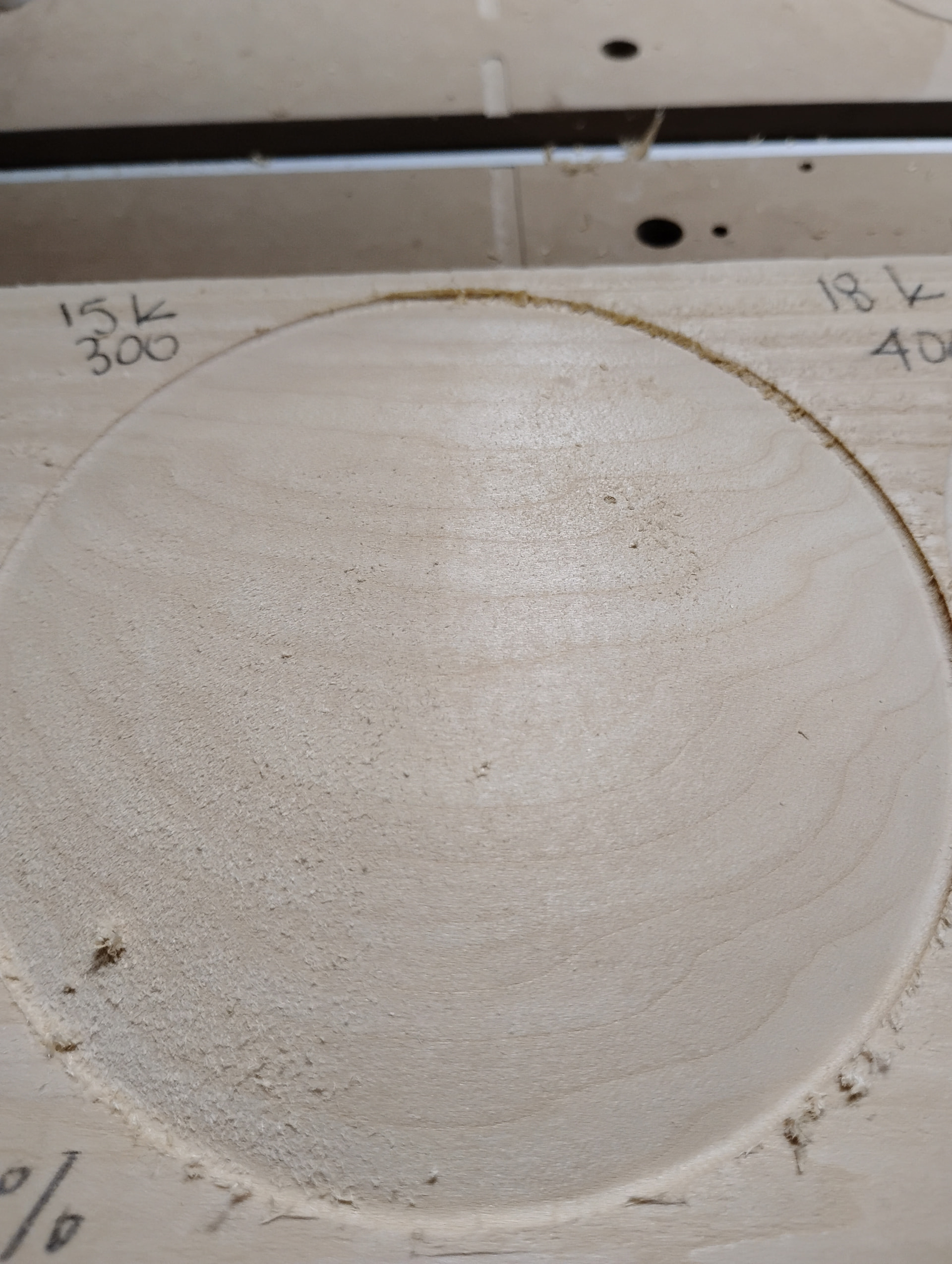

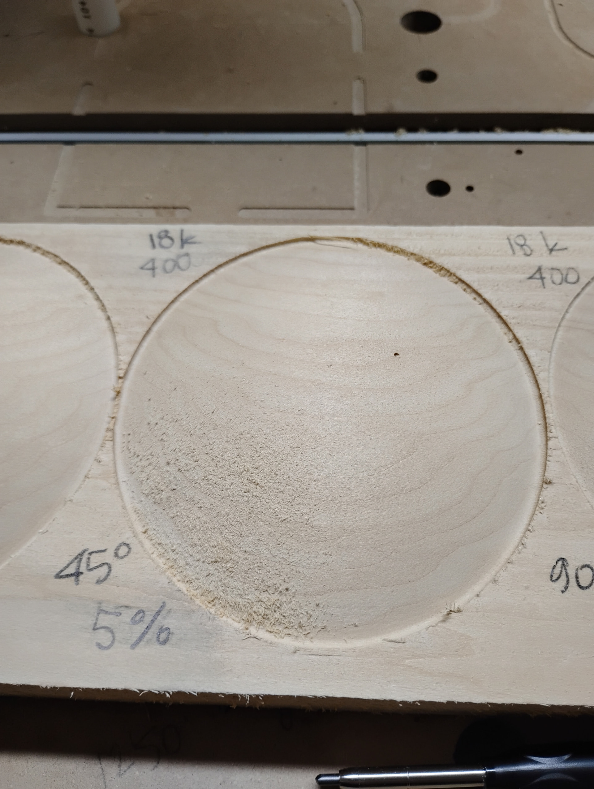

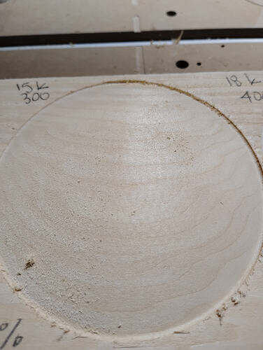

Final two tests. One at 5% stepover with different F&S; the other at 400 IPM but with different raster angles.
5% stepover, 15k RPM, 300 IPM
All 4 gave similar results but with progressively more fuzzies in one quadrant of the dome as the speeds go up.

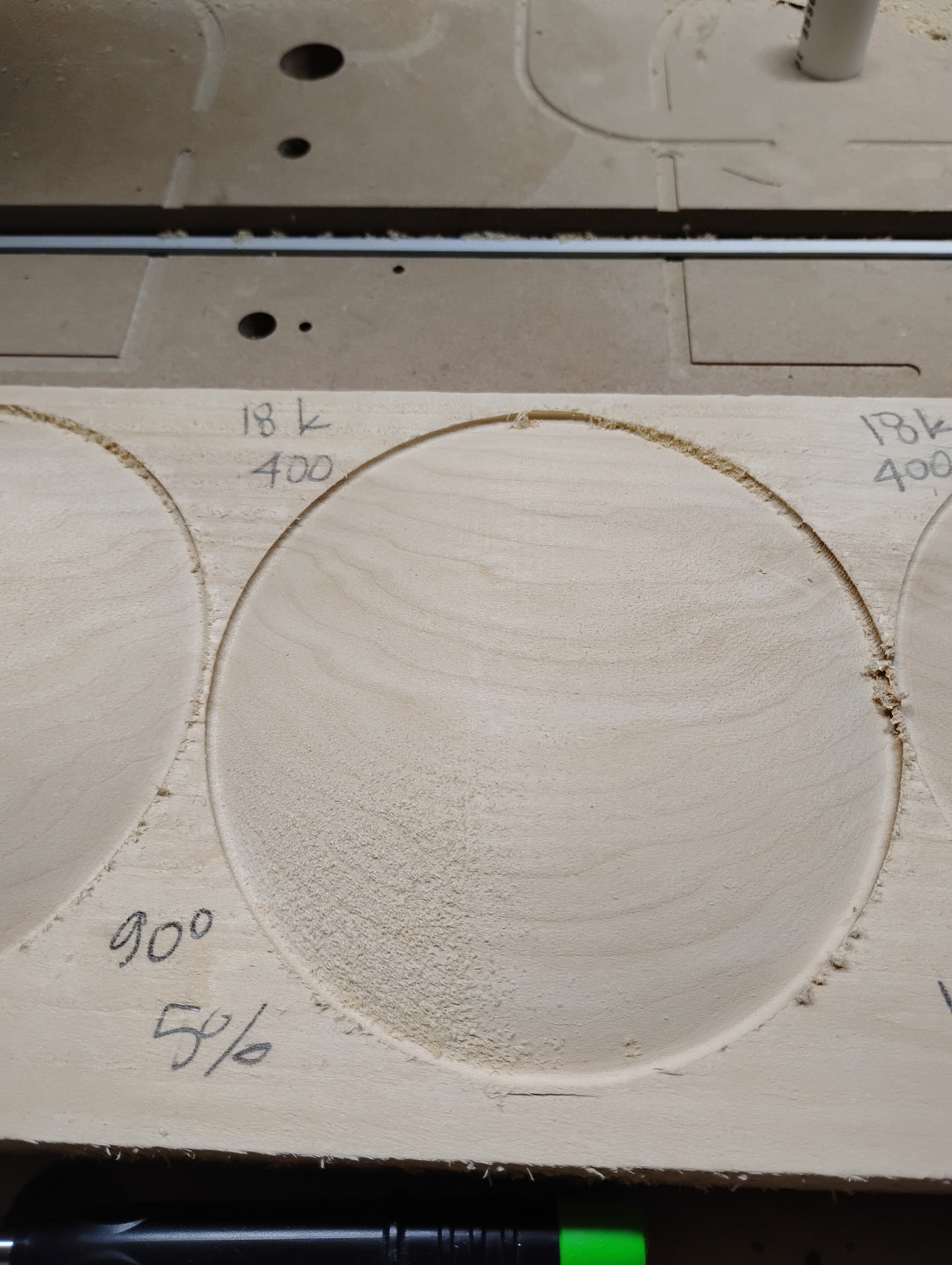

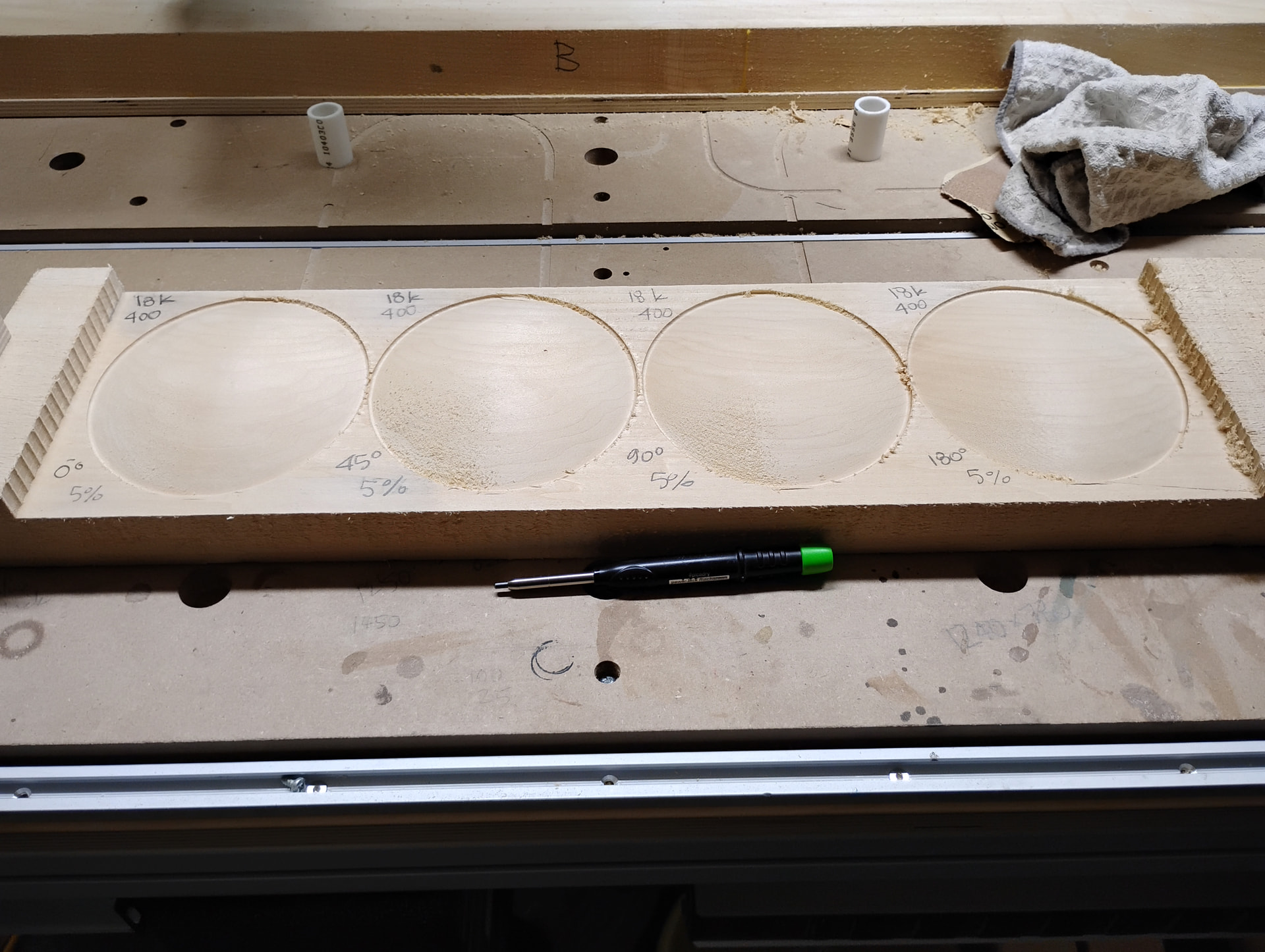

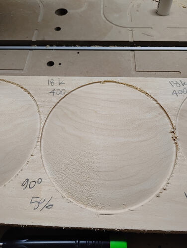

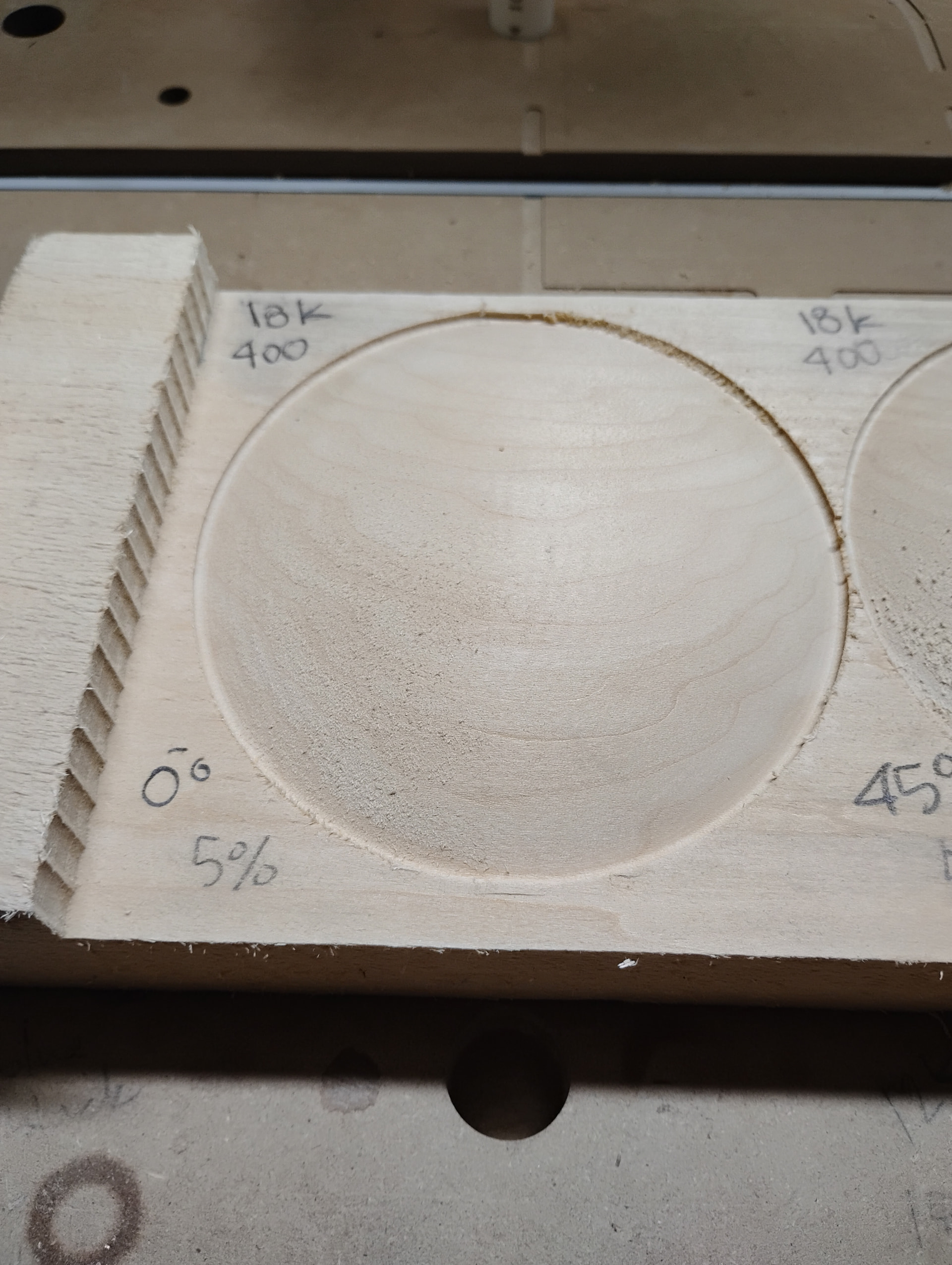

Now with the various raster angle. Same sample as before but with Z dropped by 1mm.
5% stepover, 18k RPM, 400 IPM, 0°
5% stepover, 18k RPM, 400 IPM, 45°
5% stepover, 18k RPM, 400 IPM, 90°
5% stepover, 18k RPM, 400 IPM, 180°
A raster angle of 0° and 180° (parallel to the grain) gives the best results. 45° is the worst. The 0° and 180° cuts were at opposite ends of the board and gave similar results. This would indicate that the grain pattern that I suspected before had limited impact. The 400 IPM 180° cut was at the same location as the 500 IPM cut but gave a better finish. So 500 might be a tad too fast.
That settles it. The carve of the mountain I’ll be doing will have a finish pass at 400 IPM, 18000 RPM, and 0° (or 180°) raster angle. Estimate is 9 hours for a 30" x 48" carve.

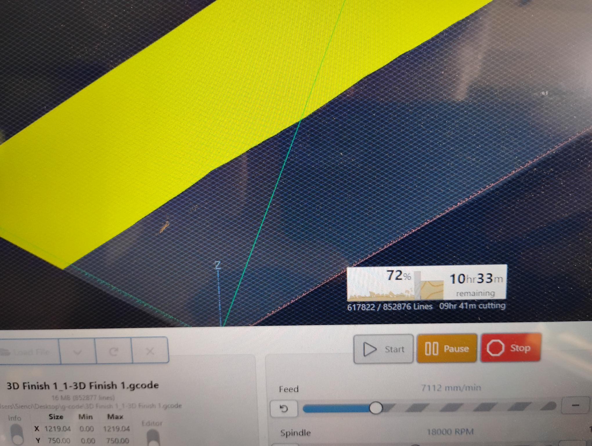

Carve went well. A bit more than 9 hours as per vCarve estimate. Not sure what’s going on in gSender. It initially gave a 16 hour estimate and at the end of the carve, it showed that it was at line 617822 of 852876 (which is the actual total line count).
