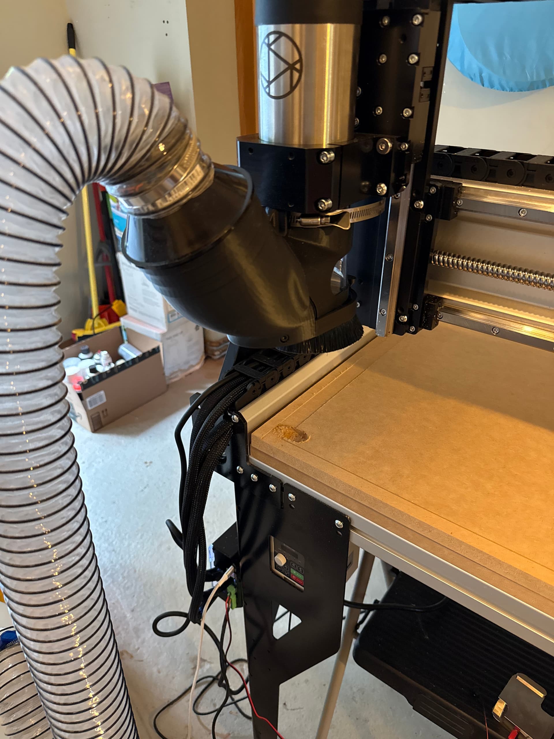

The first issue arose when setting up the cut to surface the wasteboard. The dust shoe crashes into the side rails when you’re at the limit of the cutting area. So I detached the shoe, and decided I’d start the job without it then add it back on once the perimeter had been cleared. First, that flung MDF dust literally everywhere. I do not at all recommend using this machine without dust collection for any duration on any material (but especially not MDF).
Then, when I stopped the job and installed the dust boot I discovered that I didn’t properly understand GSender’s “restart at line” function. Not exactly sure what went wrong (I’ll be researching that in the coming days), but on restarting the job it zoomed very quickly to the front-left corner and buried the bit in the wasteboard, stalling the spindle. A bit spooky, but I was able to recover and finish the job, albeit with an ugly scar on the wasteboard.

I’m less enthused with the dust shoe, it’s a bit cumbersome to work with and I may change it out for another before too long. On a similar note, I was playing with the AutoZero touch plate and found it very difficult to get an XYZ reading on. Z is easy, but when probing for X and Y it puts enough lateral pressure on the plate to make it jump off the corner it’s on, even with me holding it down. I didn’t get a single successful probe out of 10 or so. I probably just have to do some more learning on that tool, however.

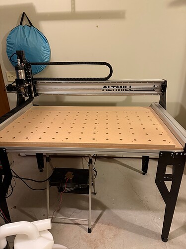

After some more difficulty, we have a wasteboard!
I know I could have made this a lot easier on myself by just cutting some MDF with a saw and screwing it down, but I really wanted to do as much of this as possible on the machine and I did end up learning a lot in the process (including learning what I don’t know and need to read up more on).

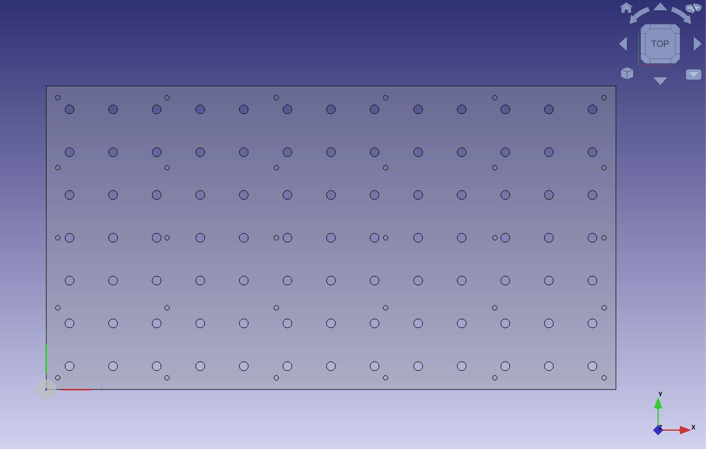

I measured the surfaced area on the sheet on the table, subtracted a bit to give myself a little margin, and laid out a wasteboard in FreeCad. The most critical things here were:
  • the size of the dogholes (I ended up undersized, had to change the design and run the program again)
  • the distance between them. I have doghole clamps that have 4 inches of travel, so I needed the offset between holes to be less than 4 inches. I played around with my design until I had good offsets and (importantly) no collisions with screwholes. There’s probably a better way to do this, but I’m still new at CAD.

To begin with the MDF was just clamped to the table in the area where the cutter doesn’t reach. I did the screwholes in one pass, then put a screw in each one so we’d have much more security during the bigger operations.
Then I did the dogholes. I started off with the nominal 19mm that the dogs are advertised as, then test fit. They could go in, but I needed pliers to pull them out. I stepped it up to 19.1mm, generated new G-code, and ran the operation again. That resulted in a perfect fit, snug but easily removed when needed.
Finally, the profile. Since I’d already surfaced the MDF down 1mm to begin with, I set the depth of the profile to 18mm. This left an onionskin at the bottom which I was able to slice with a box cutter and pull away the leftover MDF. The profile was done in 2 passes, and made an awful high-pitched racket (most of the cutting up until now had been completely inoffensive). Not sure if my speeds or cutting direction were wrong, if that was just the sound an endmill makes when slotting MDF, or something else.

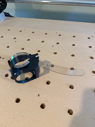

Snuck out at lunch to run a surfacing pass on the wasteboard and disaster struck again.
Dust boot crashed against the side of the machine and disintegrated. Even with my wasteboard off the edge of the cutting area by a bit, this boot is just too wide to surface with. Looks like I’m out of commission until the replacement dust boot gets here.
