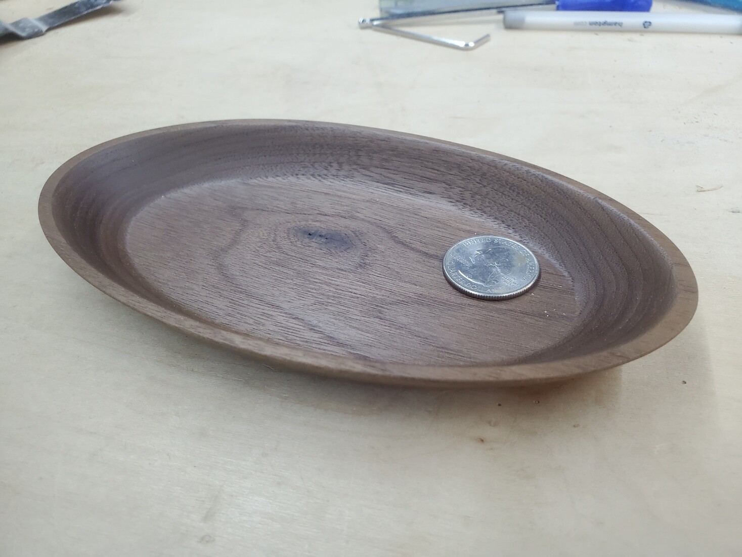

First project on my MKII
Modeled this little tray in my 3D program (TopSolid). Revolved an ellipse, then took a 3/4" slice out of it where I thought it might look good. Exported as .stl and imported to VCarve desktop. First test was on a piece of mdf which resulted in a bottom that I put my finger through the first time I touched it :rofl:. Took me awhile to figure out “limit planes”, but I am pleased with how this came out in a scrap of walnut :grin:. In retrospect, maybe I shouldn’t have started out with a 2-sided, 3D project

I too did a 2-sided 3D project first and I think I learned more from that then if I would have slowly worked up to it. Can’t wait to see whats next
Looking great!
I have to agree - dive in! You learn so much from just going for it.
Thanks. Yeah, I learned a ton about Vcarve. Looking forward to more!
I’m also in agreement with tackling challenging projects as a rule - regardless of your experience level - as it’s a wonderful way to learn how best to use your CNC.
