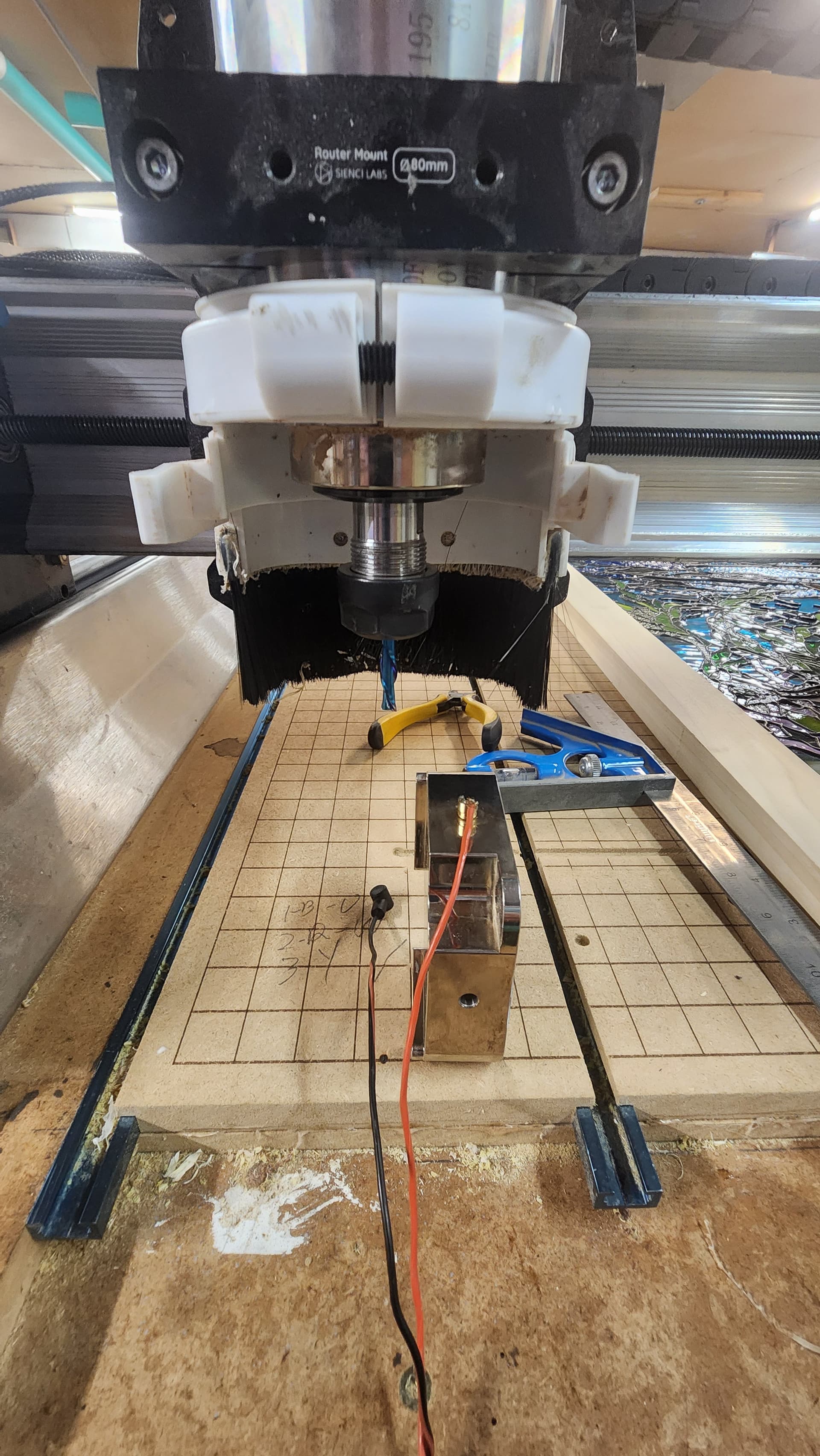

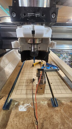

I run a spindle mounted dust shoe on my Longmill Mk2 that has a 2” brush and do that kind of thing a lot. depending on your dust collection system it still works effectively to minimize the chips. I can always swap in longer brushes if necessary.
