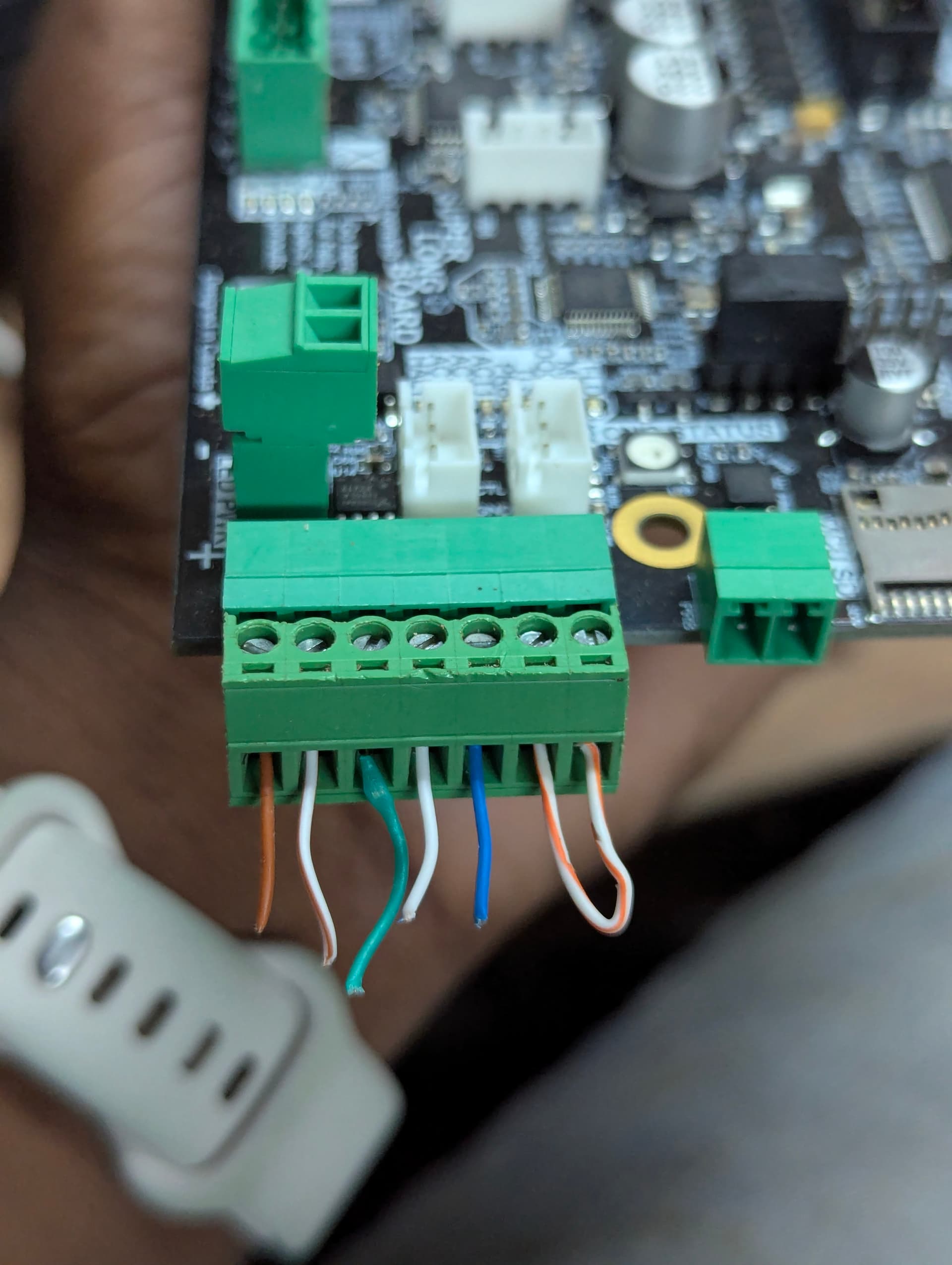

Getting “ALARM 10 - Estop asserted” even after bypassing Estop
Longmill 30x48
SLB
Gsender 1.5
Been getting Alarm 10 at random moments (during jobs, when idle).
Did several rounds of troubleshooting and testing. Tested connectivity on the Estop unit (connector to Estop mini board), changed Ethernet cable, even bypassed Estop altogether and still getting the issue.
When resetting Estop or rebooting the board works sometimes. Right now it is t (x20 times).
@desonalleyne I’d suggest sending us in a ticket about this, since after all the testing you’ve done it may be likely you’ll need a replacement board: Contact Us | Sienci Labs
