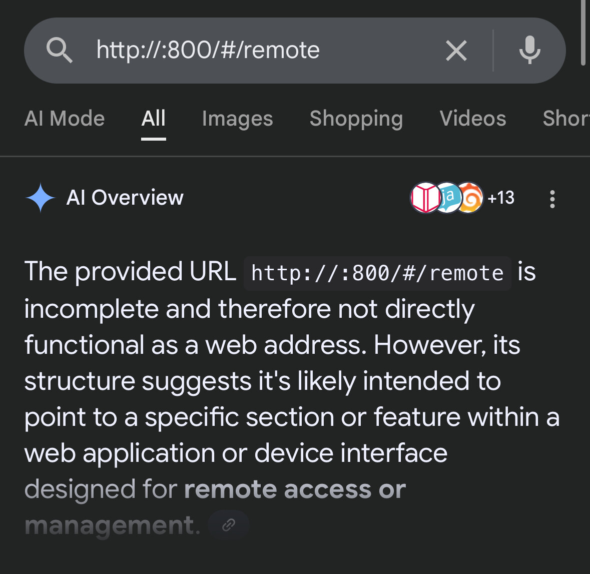

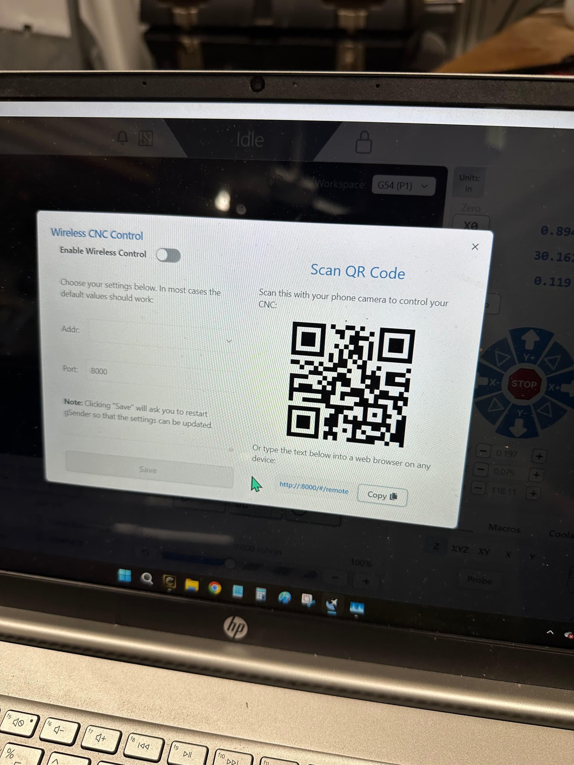

QR code linking to where you connect your phone to gsender is incorrect.
As of right now you don’t have remote control enabled, you need to select an IP address and toggle on wireless control, then click save. That’s why it’s not taking you anywhere with the QR code

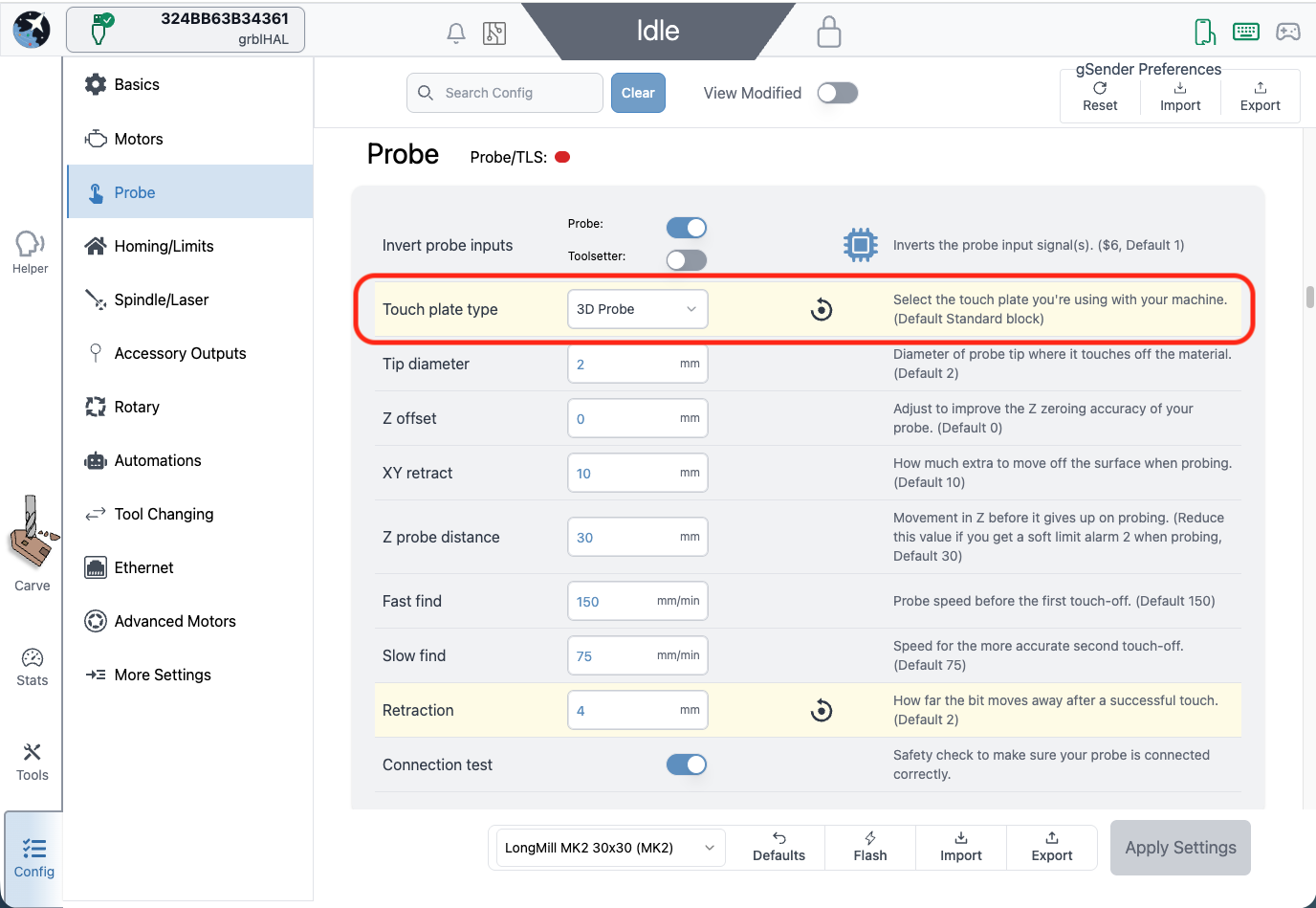

  • Probing & Tool Setup:
    • Added support for a new 3D Probe, with plans to support more than standard XYZ probing in the future.
      Screenshot 2025-09-24 at 11.27.52 AM
      Screenshot 2025-09-24 at 11.27.39 AM
    • Each probe block now has an individually customizable Z thickness including the AutoZero touch plate
    • All probing cycles now sped up with reduced delays and reduced default retracts to 2mm from 4mm

Excited for the 3D probe support!
Question tho, if we have a spring-loaded tool length sensor, how do we switch from a probe to a tool without messing up the Z zero point? If I try to treat my probe like a tool then it will trigger too soon since my tool length sensor is spring-loaded (rather than an electrical contact).
look promising with the new update, especially with the new 3d probe :star_struck:
for everyone that look forward to use the small Chinese probe, the tip is 2 mm but you need to set it to 1,9mm , reason is, when the probe switches it moves outwards about 0.1mm
i spend only 2 hours to figure that out :sweat_smile:
on the Z, please don’t use it with the ER collets, only use it if you have tool holder found in ATC spindles (EX: BT Holders)
If you plan on using that, you’ll have to probe the Z, change to a tool with a known height, manually drive the tool on a peace of paper and calculate the difference on probed Z with the shown Z height from the tool on the paper, that way you can set the length of the probe itself
Hope that makes sense
Sounds like a collet keeper will be needed so it’s always the same length in the collet.
