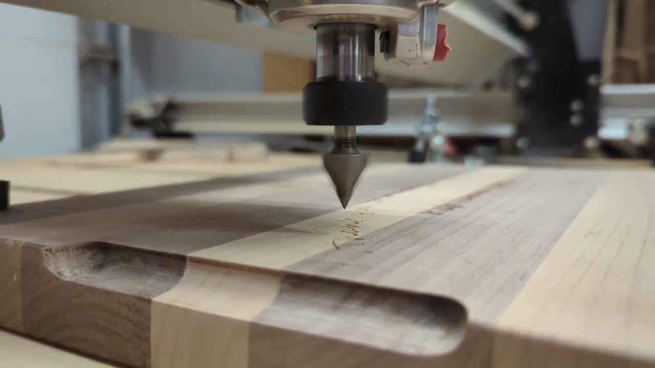

The crux of it is that I’m carving on the back of a cutting board and the letters on the “zero” side are less deep than the letters on the right side of the machine.
I have the safe height set to 1mm and the router is bouncing up roughly 15mm every movement. I don’t know why or if that’s even part of my issue.
So I re-did a toolpath to only include some of the letters that weren’t deep enough and asked it to go .1" deeper. It didn’t cut any deeper, so I told it .3", no joy. .5" deeper that the initial run, doesn’t look any different.
At this point, it must be that the machine needs adjustment, but no idea where I should start. Re-flash maybe? Ideally, I’d like someone knowledgeable to give me a place to start looking
Here is a video of the machine in action (turn off the volume, I didn’t disable it in the video,… it’s LOUD)
Thank you very much for any hint of what I should look at.

  1. Carbide Create build 652
  2. Carbide Create
  3. Forgot that that exists in Carbide Create, and it’s set to .5" there. I was referencing the “safe height” in gsender 1.1.7 (as seen in attached picture)
  4. my poorly described left side of machine (when facing it) and right side
  5. changed Max Depth in the Carbide Create Vcarve toolpath. Then generated the gcode and loaded that into gsender

If one side of your carve is cutting deeper than another, the odds are that either you have not surfaced your spoil board or the material is not of a uniform thickness
I suggest that you read the gSender documentation. Specifically, you will see that the safe height setting in gSender only affects when you are jogging the machine. It has no effect when you are running a tool path. The safe Z height then is whatever you set in Carbide Create.
Finally, if Carbide Create is like VCarve, a vcarve tool path will carve as deep as it take to have the carve touch both vectors that the bit is carving between. You can set it shallower, but not deeper. I suspect that is why changing your depth did nothing. Again, I suggest that you read the CC documentation.

I have surfaced the spoilboard and the cutting board has been run through my thickness planer, but your help has sent me somewhere and I truly appreciate it!
@short I’m glad that this helps a bit. Feel free to post more questions. It’s odd that you are getting different depths across your spoil board.
I just thought of one more thing. If you are running vcarve tool paths, the depth will vary with the width of the letters. So, if you have wider letters on the left than on the right, the letters on the left will carve deeper than those on the right. This is just the nature of a vcarve tool path. Again, I’m assuming that CC works in a similar way to VCarve Pro. You should check the CC docs, though, and not take my word for it.
