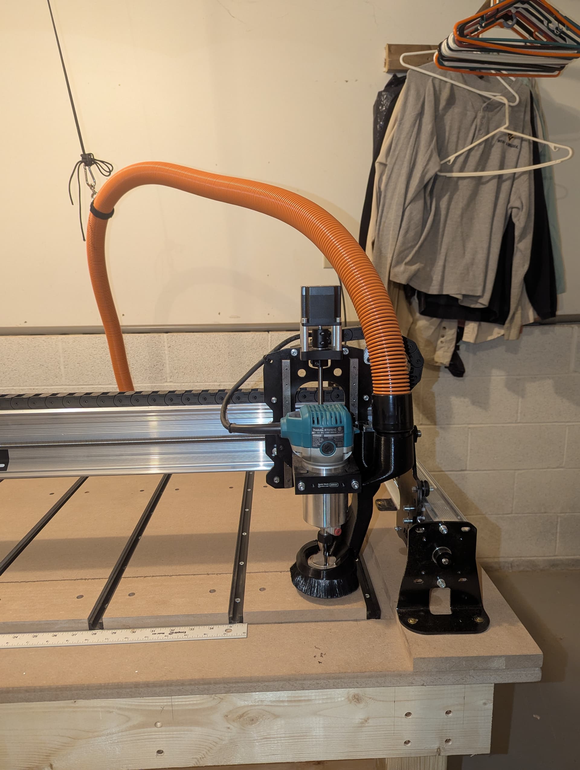

Hello, I have this shop vac, apparently with a 2.5" hose. I also have the sienci dust shoe (the new one).
What I’m trying to do is have a suspended hose that stays on the dust shoe semi permanent and have the ability to attach that to my shop vacs 2.5" hose since I move it around the shop.
Would I need an adapter on the dust shoe to accept a 2.5" 20 foot hose then attach another adapter on the shop vac side thats 2.5" to 2.5"? Not sure if such a product exists.

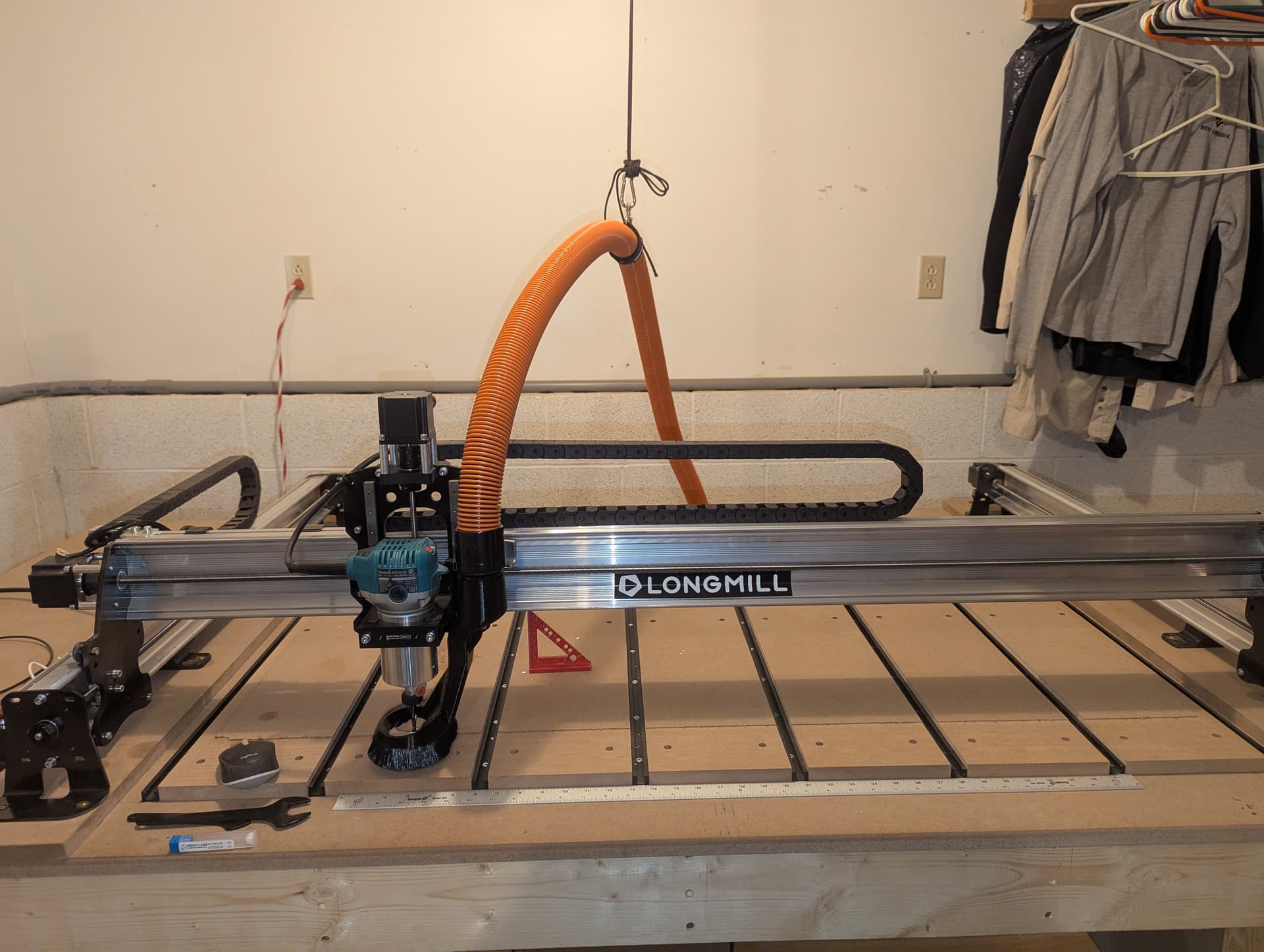

Here is what I ended up with on top of my buckets.

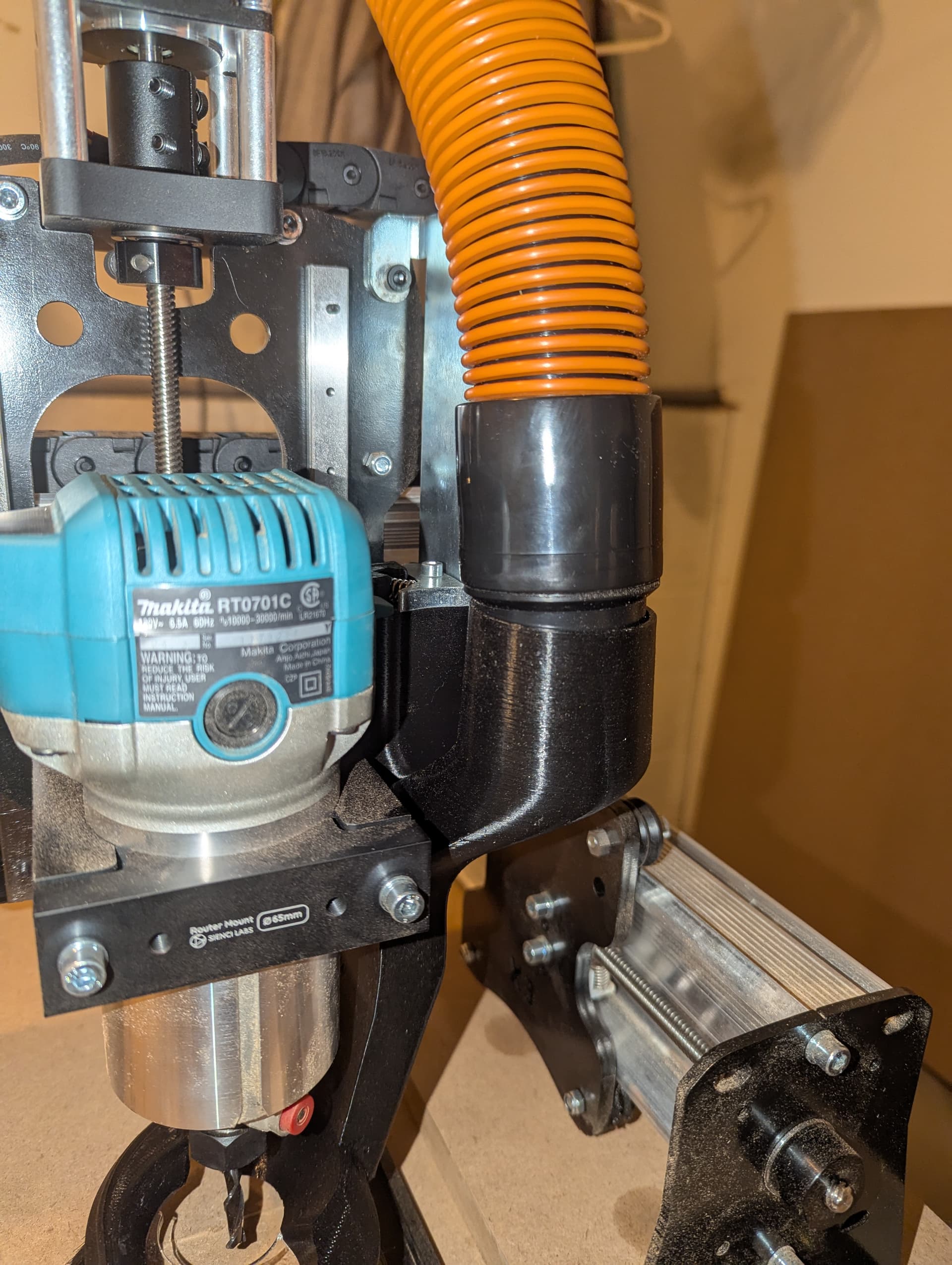

I have a Dewalt vacuum that uses a 1 7/8" hose. The hose I purchased to go from the cyclone to the dust shoe is also a 1 7/8" hose. It cost about $40 on amazon and was the most expensive part of the build. It came with some adapters and one of them fit nice over the pvc. The other side I 3D printed an adapter.
Your 2.5" hose is bigger than the pvc parts he used but they make all kinds of pvc parts and maybe you can figure something out for connecting. You could also make the whole pvc part out of bigger pvc pipe as I think your shop vac probably moves more air than mine.

Edit: If you find something close to fitting but a bit to small, like maybe the coupling for a 2" pvc pipe, you can wrap with duct tape to get a good fit. I’d bring the hose to Home Depot or Lowe’s, or just the end if it’s removable, and mess around in the plumbing section and see what you can come up with.

If you make your own cyclone like I did make sure you suspend the vacuum hoses at the top to take some of the weight off them. If you look closely you can see cracks in my bucket around the fittings. This would have been prevented or at least slowed down if I had done that from the beginning. I did suspend mine but not until I had the cracking.
