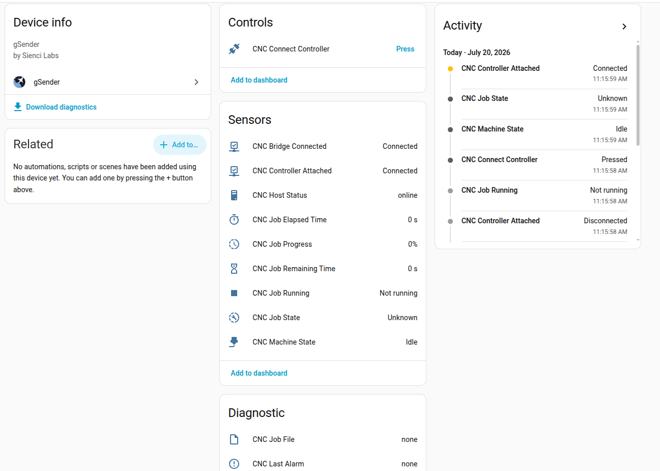

I have had a need for monitoring and integrating CNC on gSender into our office HomeAssistant. With a big help from Claude (guess where my Fable trial went…) I did HACS integration.
It is for monitoring only so I can basically know when to turn off whole CNC since we use it only occasionally and turning off the whole setup is not our greatest strength.
Feel free to test: GitHub - dosdroid/ha-gsender: Unofficial Home Assistant integration for gSender — local push CNC monitoring: machine & job state, progress, alarms, job events, host-off detection, and a Connect button. HACS custom repo. · GitHub

The underlying principle how it connects to the gSender is the same. I do not have gsender2mqtt installed so I can’t test if running mqtt and integration will interfere. In theory they should not. It is like opening the remote control on multiple devices…
Main difference is that you do not have to hassle with docker and setting up MQTT. And the setup is completely done on HA host machine. (which can be done with the mqtt too but not in case you have HA OS). And since it is “HA native” it should be a bit simpler to create HA automations around it.

I have not tried ANYTHING but had a question - it asks for serial port information but what if I don’t use serial port? I have mine connected via a 2nd Ethernet directly to the SLB-Ext.
try version 0.6.0 which should be available via HACS now. This connection type should be configurable via the setup/reconfiguration flow. You might have to delete the integration from integrations page (not hacs) and add it again after update. Cant test this myself but should work. Please let me know.
