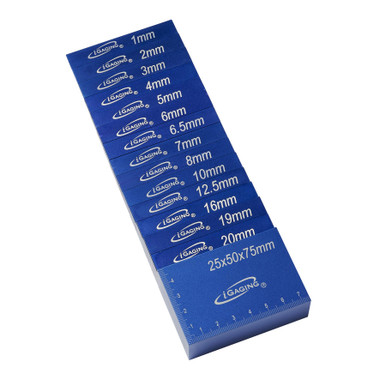

I use gSender and a belt-and-braces approach. With issues with accuracy when using my tool length measuring set up, I always measure the bit stickout manually at the start of every project, using setup blocks. The link shows a set which is similar to the one I purchased for just £40.00. They are accurate to 0.001" which is likely to be good enough for many projects.
