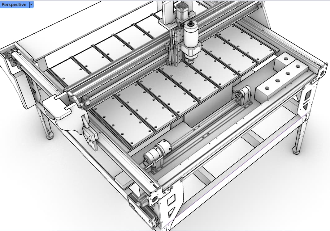

On my Altmill table, I want to open the ‘bay’ between the first two cross members, and in that 11 1/4" space mount a vertical clamping slot for tenons, a RapidChange ATC, and a Vortex 4th axis, such that, and this is point of my question: so that the axis of the 4th is level with the spoil board. Building a solid structure is no sweat. I see two advantages; better clearance for tool height, and easier to reach across to the remaining 3’ x 4’ of spoil board that will still get the most of my attention. Anybody raise any red flags? Thanks.

In spite of the day job, and a life, I’m back. I sketched out my idea:

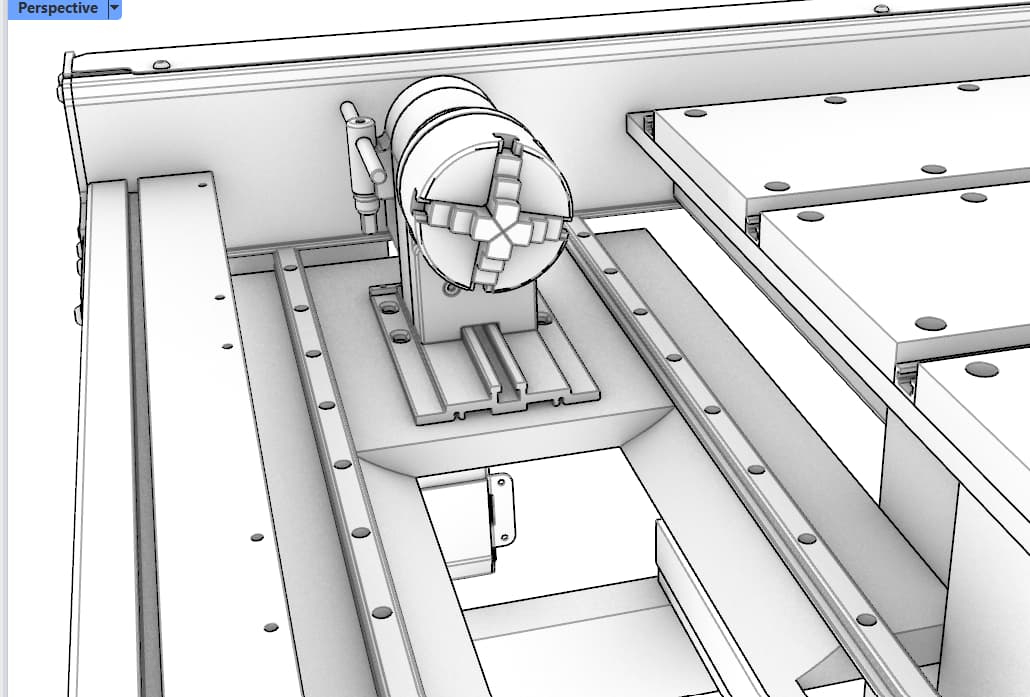

See how tightly my three add-ons squeeze in:
The short version vortex. (more on that later)
A slot, centered, to access the ends of panels.
A RapidChange ATC, the simple 4 tool, with a tool setter.
Set that closest to the operator and CPU for easy access,
and so that I can devise a simple trip lever to move a lid for dust prevention.
I already build a shelf at the middle of the legs, and weighed it down with stone,
so I’ll have fun today clearing all that and building the simple shelf.
Anyone shout a warning?
THanx!

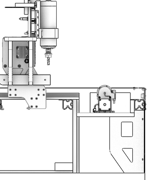

Bonus side view with legs and rails hidden for clarity:

@RobLM Tks much, Rob. It is much much fancier than mine. Of course, pretty much everything is. In my previous comments, I didn’t take into account that you would be using the short Vortex.

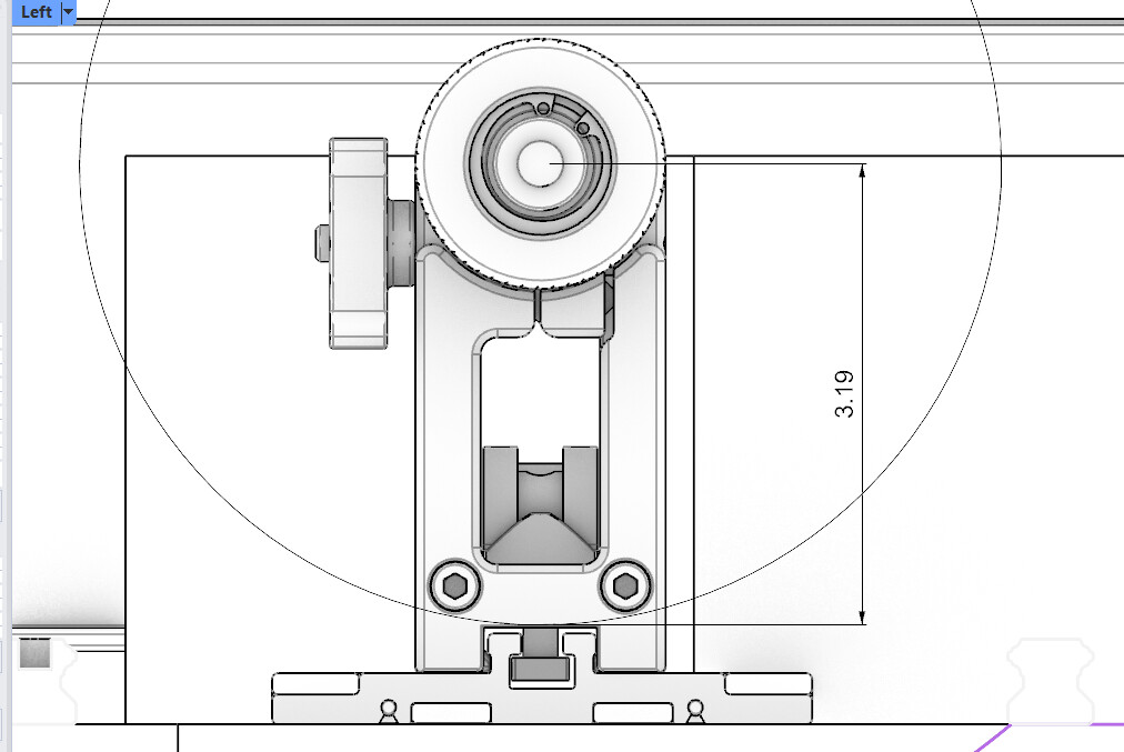

From the drawings, it looks like the centre axis of the vortex is the same height as the top of the spoilboard, correct? One thing to think about will be any implications of that as you surface the spoilboard over time. I’m not saying that there will be any. I’m simply saying that, if you have based some operational assumptions on those two things being of equal height, those assumptions will go south over time.

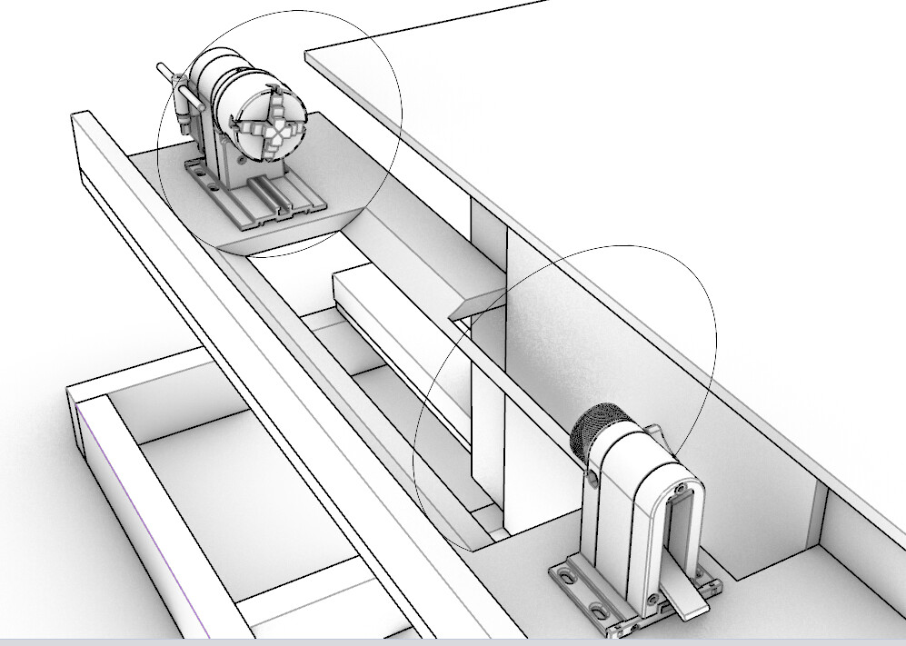

May I suggest, and this is in reference to my earlier comment on the length of the Vortex,
and this is a very quick sketch so imagine a lot more structure and thought,

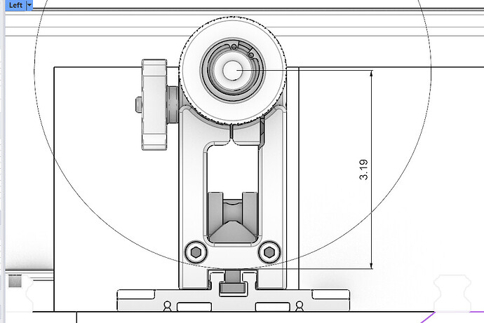

That’s about a 5" radius but the limiting factor is the height of Z with a bit in place:
Nah. You know what? Making the diameter of the Vortex any bigger is a futile exercise; expensive and not worth the hassle. The reviews of it as is are great, and most of what I want to make is small.
@RobLM I thought of that. The issue then is how do you mount shorter pieces?
You are right. It is very good as is. I simply would like to do projects larger than 3" in diameter.
Is that 3" diameter or radius? I went to the “measurements” page on Vortex
but it was kind of a mess. What is the maximum height/width & length?
Perhaps the onshape page for the Vortex will help you determine the maximum radius/diameter. It looks like 3"+ radius to me there.
Yup. That’s where I got that image, from their model, which I downloaded. 3" radius, 6" diameter is plenty for now. I’ll take one straight out of the box. Won’t get fancy with any DIY mods until I actually need to.

@RobLM My apologies, Rob. I missed your question about max size. 3" is radius.
