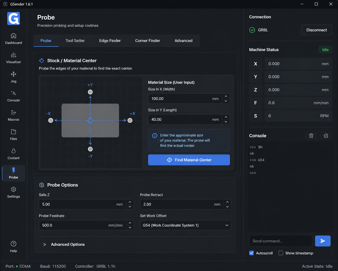

Also, I will try to implement this into GSender. Just hold my chips :sweat_smile:

added some changes, instead of editing the entire code to change the work spaces coordinates, possibly making the code a mess, we just change the number 1-6 in %WCS_P = 1
; Change WCS_P to switch Work Coordinate System:
; 1 = G54, 2 = G55, 3 = G56, 4 = G57, 5 = G58, 6 = G59
%WCS_P = 1
G10 L20 P[WCS_P] Z[PROBE_RETRACT]
G10 L20 P[WCS_P] X0
G10 L20 P[WCS_P] Y0
You could probably simplify that by using P0 which sets the offset in the current workspace - no need to edit at all. If you’re not setting the offset in a workspace other than the current one.
G10 L20 P0 Z[PROBE_RETRACT]
G10 L20 P0 X0
G10 L20 P0 Y0
oh that’s a good point, i did tried something but couldn’t figure out. i have to try now :rofl:
