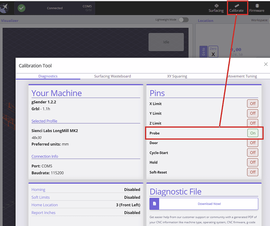

I however have purchased me one inductive sensor to play around with. One thing I noticed when looking for the cheapest one -not on a chinese website- that most sensors that work on 24V have a ranged voltage with the lower limit being 6.something Volt. I made sure to get me a unit that has a set voltage of 5V. To test it I hooked it up to 5v output at the controller and the probe input.
To be able to readout the switch, I went to the Calibrate tab at g-sender where a pin table shows what switch is active (or not) at the controllers input.
Please note that I am using gsender 1.2.2. Things might deviate at higher versions, but I’m pretty sure it’s still available.

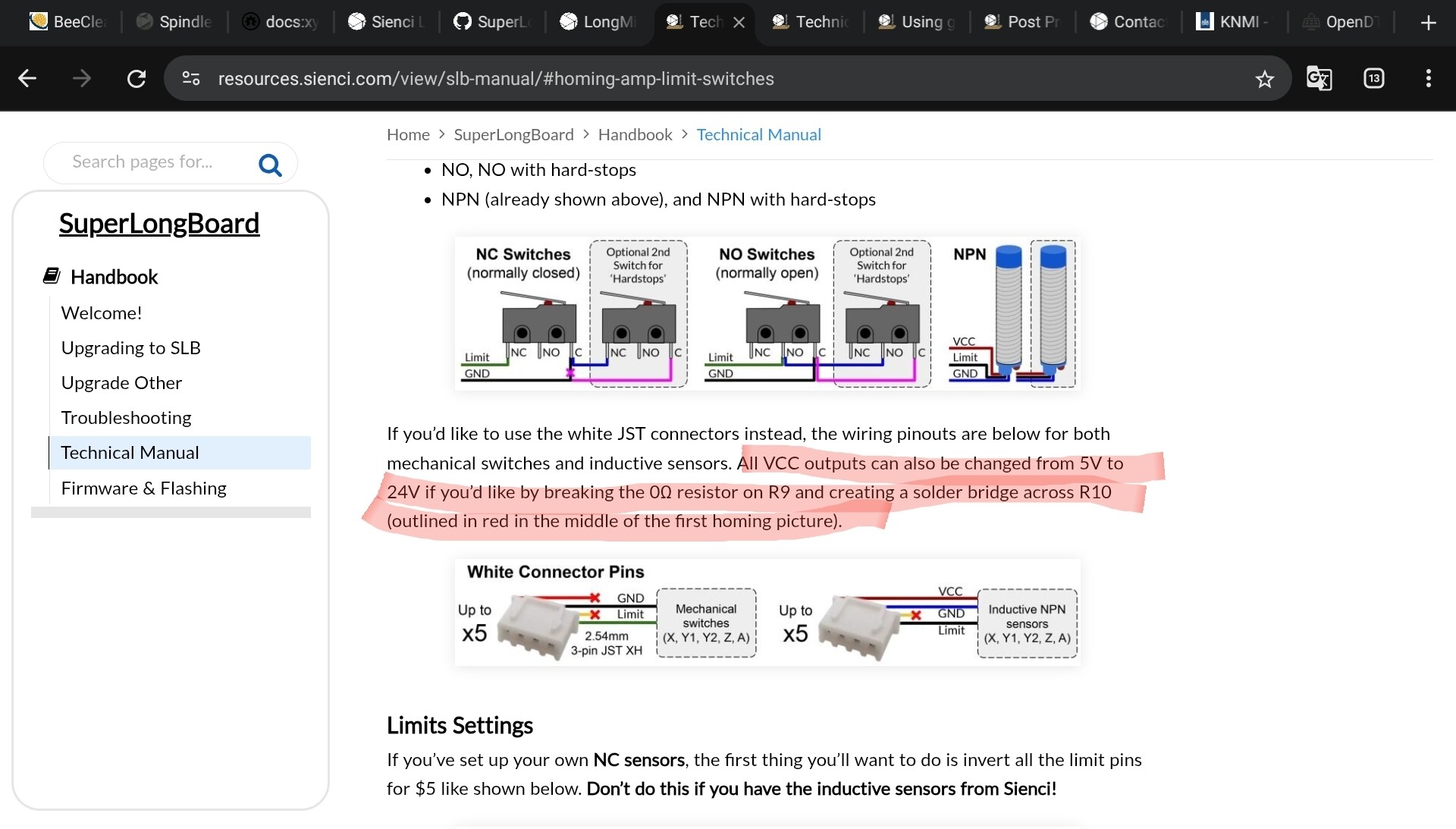

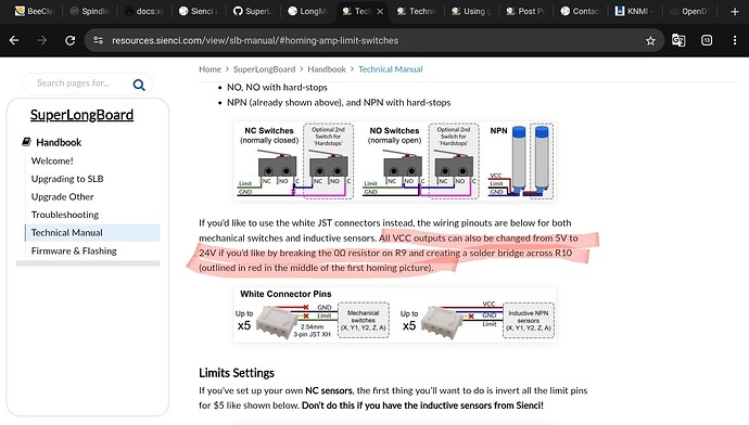

Since your switch seems to work at 24V, I suspect it be a 6.3 lower limit switch. You might be able to use my test setup to see if it actually switches at 5v input. I do advice against feeding the switch 24v while the board is set to have a 5v vcc.
There is a way to hardwire the vcc of the slb from 5v to 24v. There is a wee section about that inside the slb manual found here:
i have tried switching in gsender didn’t work There is another workaround to get voltage with out modifying the board. I’m starting to think it is the cheep Chinese sensors.
