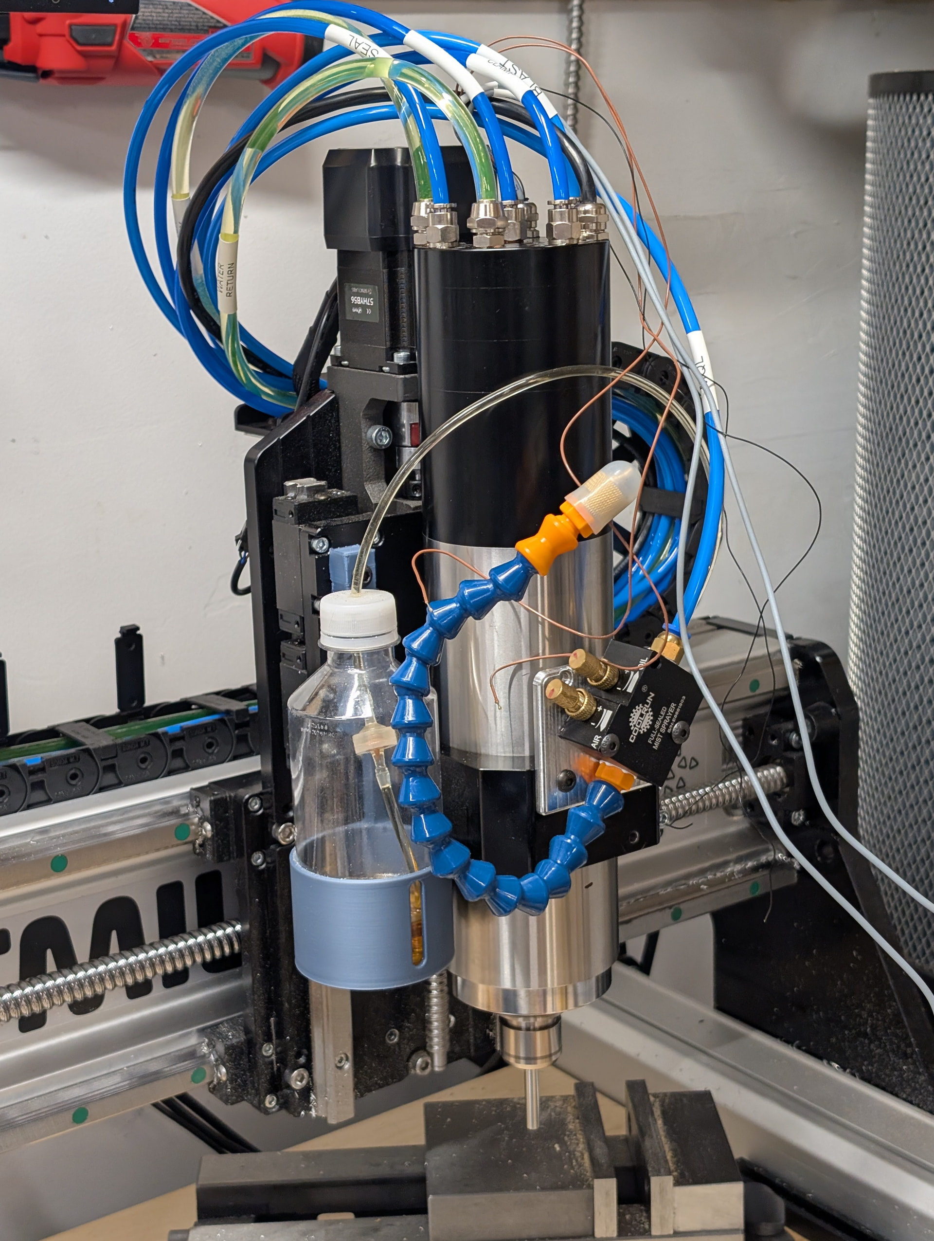

Almost done wiring up the Jianken ATC spindle. Incredible quality. Cable chains are stuffed!
Pics of wiring soon.

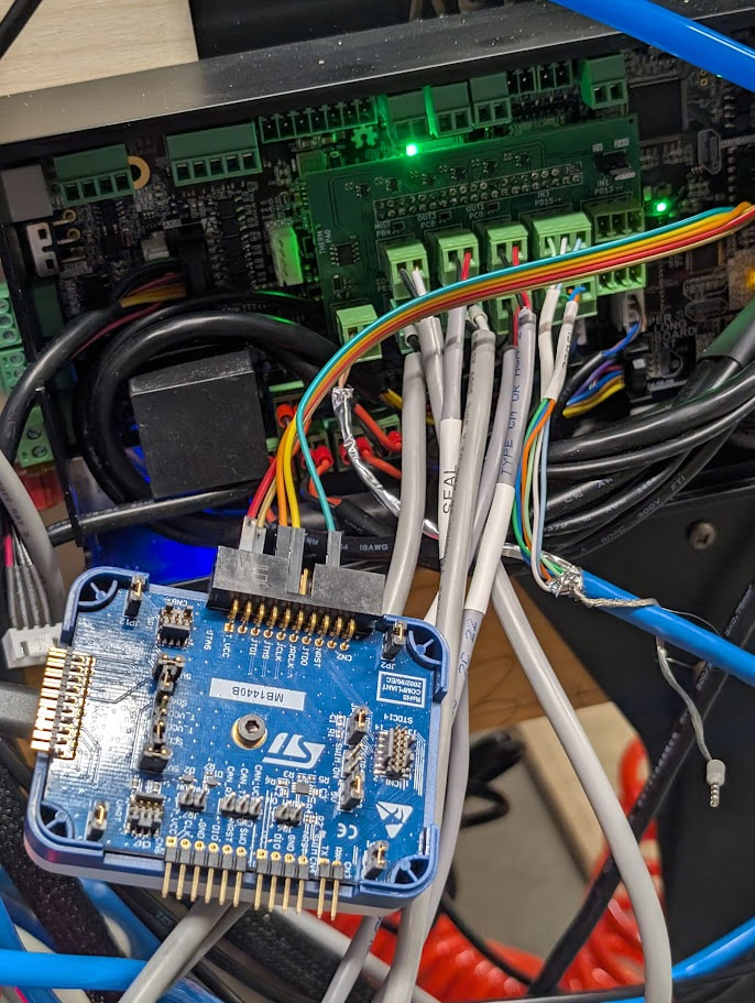

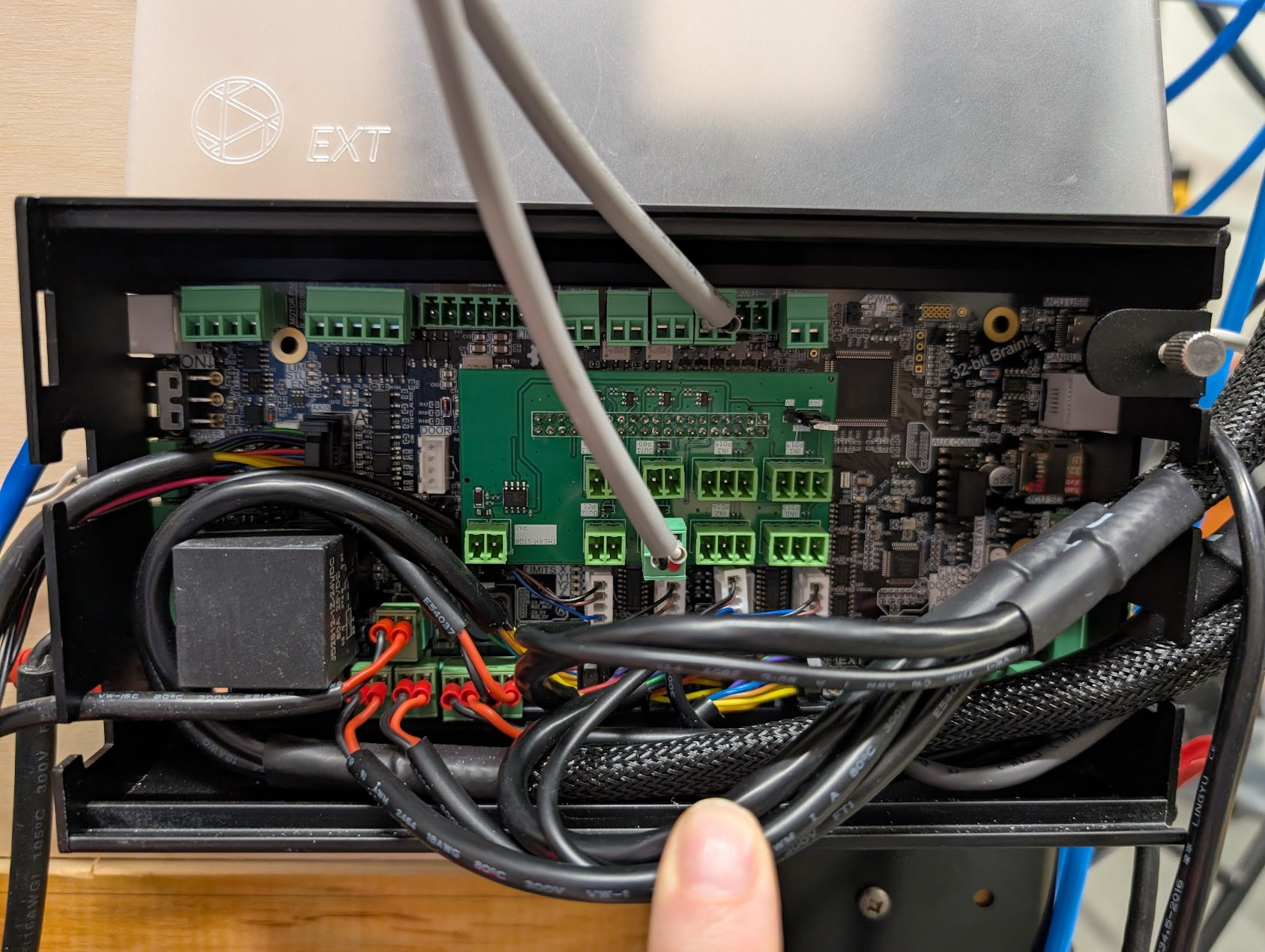

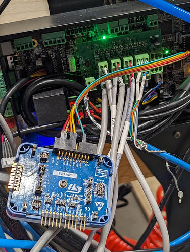

Still a WIP, here’s my custom PCB to break out some AUX in’s and out’s, as well as a buffered and protected analog input that reads the spindle’s temperature.
I ordered a 2nd rev after realizing I still need 2 more outputs to properly control my spindle and also MQL and toolsetter clear :wink:

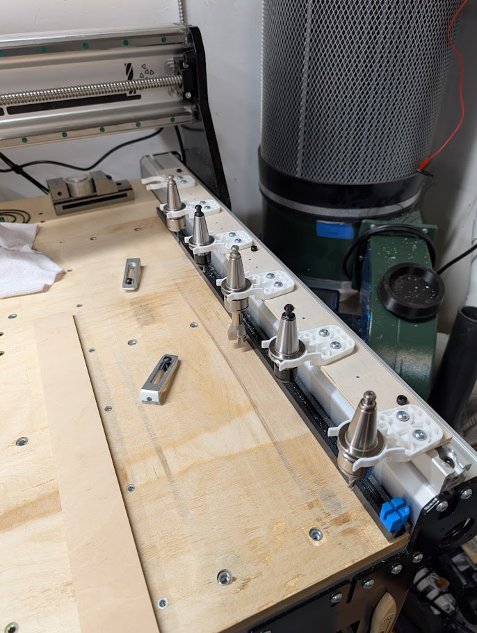

Tool rack setup and working with toolchanges.
I’ve mostly cloned numbering of macro so that gSender behaves nicely :slight_smile:
Ohhhhh … tool rack on the side … cool!
Gotta debug some of the firmware plugins I’ve made. I think one of them might be hanging the CPU overnight.
  1. Reads the Jianken thermistor
  2. Manages the air seal on the spindle
  3. Firmware level interlocks for spindle/drawbars

I can share my setup, but without my custom breakout board ( GitHub - gcormier/slbaux · GitHub ) I don’t know how useful it is. If the SLBEXTv2 has more stuff broken out, or Sienci releases a standard breakout board, happy to contribute the Jianken ATC stuff.
Are those BT30 tool holders? I was trying to do something similar, but I don’t have enough space to clear the pull studs under the gantry. I believe the newer AltMills have taller side brackets (at least it does for their ATC version compared to what my earlier version has).
those look like ISO20 tool holders. Same as sience atc setup i’m running
