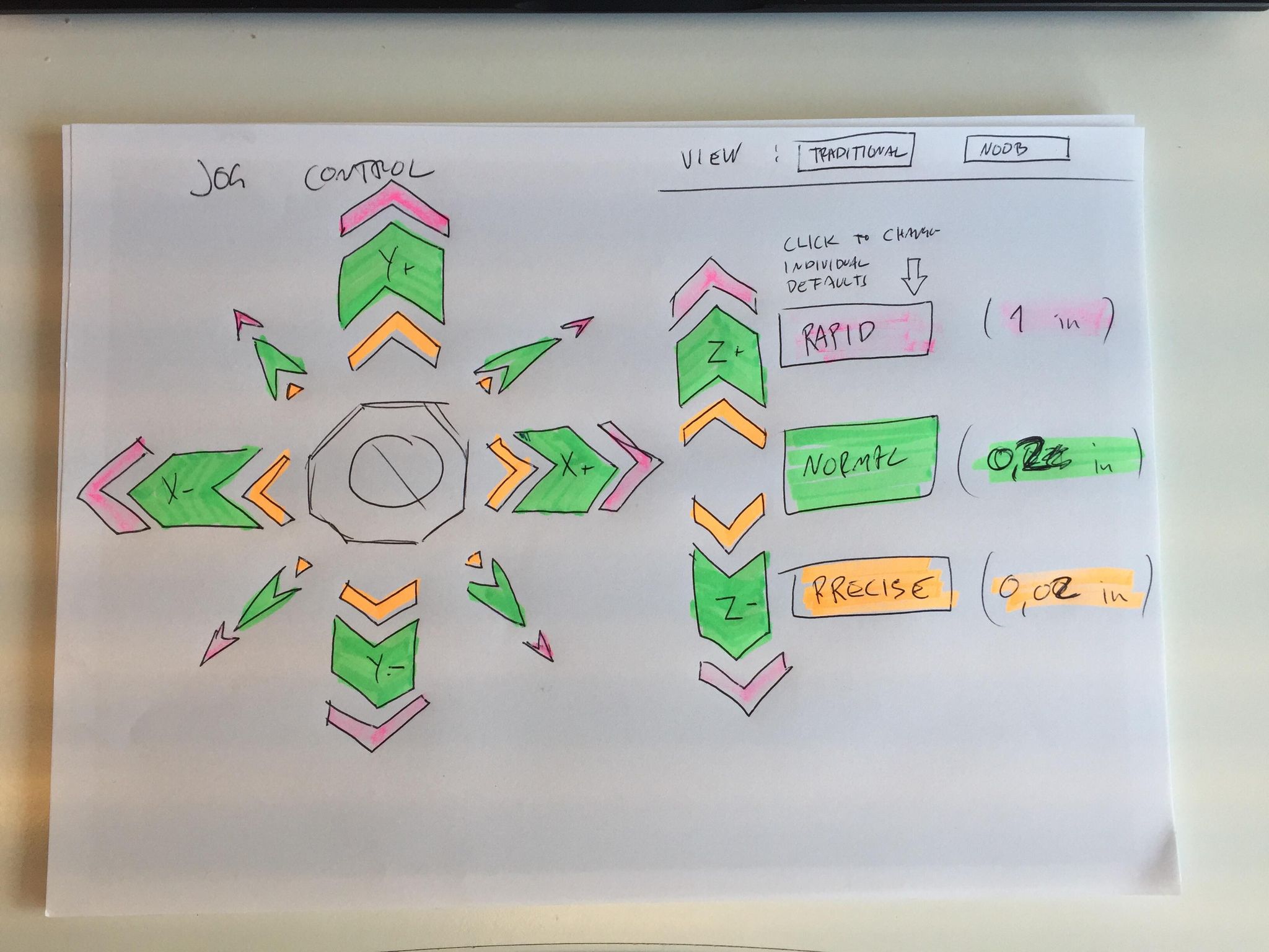

Jog control idea
I’m a total noob, and I’ve just started a scratch(scrap) cnc build and downloaded gSender. It looks good (intuitive), but being a noob the different modes for the Jog control is an accident waiting to happen… Getting a bit excited and forgetting you are in rapid mode when you really want to be in precise, or at least normal, can be frustrating… So I’ve made a little sketch of how I would imagine it working better for me! And it should have a toggle button to be able to toggle between “traditional” (for those who don’t make this mistake) and “Noob” for people like myself! My paint/photoshop/illustrator skills are very limited so I opted for an old school hand drawing! I’m sure it’s frowned upon here.. :laughing: But please don’t discard the basic idea because of the drawing! :wink: I hope it is sufficient to make my idea understandable! Please see attached drawing. Have a splendid day! Paul
Hey Paul,
I totaly get how your setup would seem logic.
at first.
But, there’s a but.
The way it has been setupo the way it is, is that you can use a keyboard or gamepad to control the movement using the arrow keys or a joy stick. To be able to toggle between the speeds and have them "“stick” keeps it possible to use the same arrow keys or joystick to control the movement.
Thus you only have to set a few extra shortcut keys that toggle between the speeds.
Using a mouse to sneak up to a zero point - especialy when sneaking the Z, is dangerouse. The eyes will be on the bit and not on the mouse pointer. Drifting a bit with that can result in dissaster. I wouldn’t want your toggle setup when drifting a mouse.
When I use my mouse, mostly to jog set (large) distances, I always make sure to tap the precise button, so I always know that my toggle distances are reset and will not result in unexpected large movements.

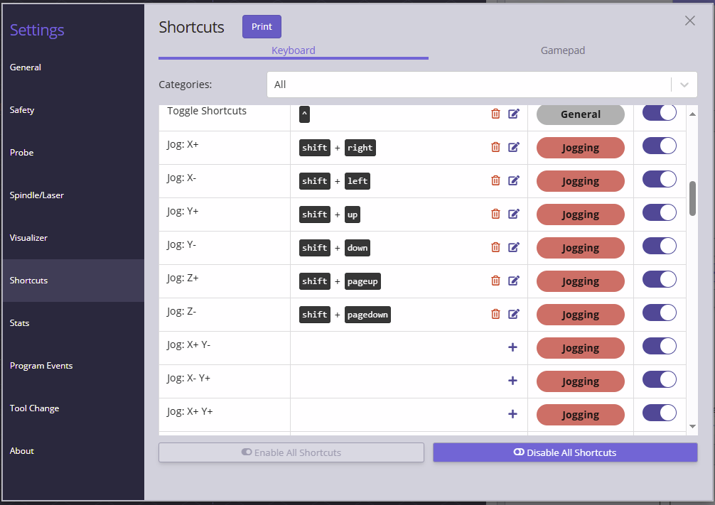

You can pretty much shortcut all functions of your machine into your keyboard. It works great, once you have remembered the keys you have set. I use it purely to jogg so my list is short. Shift+arrows for y and x movement. Shift-pgUp Shift-Pgdn for Z movement. Shift-x for precise, Shift-c for normal. and two shortcuts to toggle laser on/off. You can set these shortcuts in g-sender at settings/shortcuts.
Essential all actions that need my attention at the machine and off screen. It works magic.
Thanks Eddie! Very useful tip! :slight_smile: I’m sure it will work wonders for me aswell!
