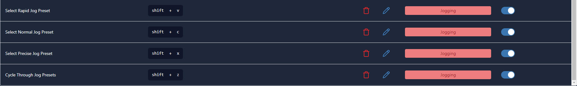

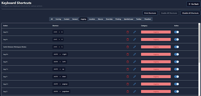

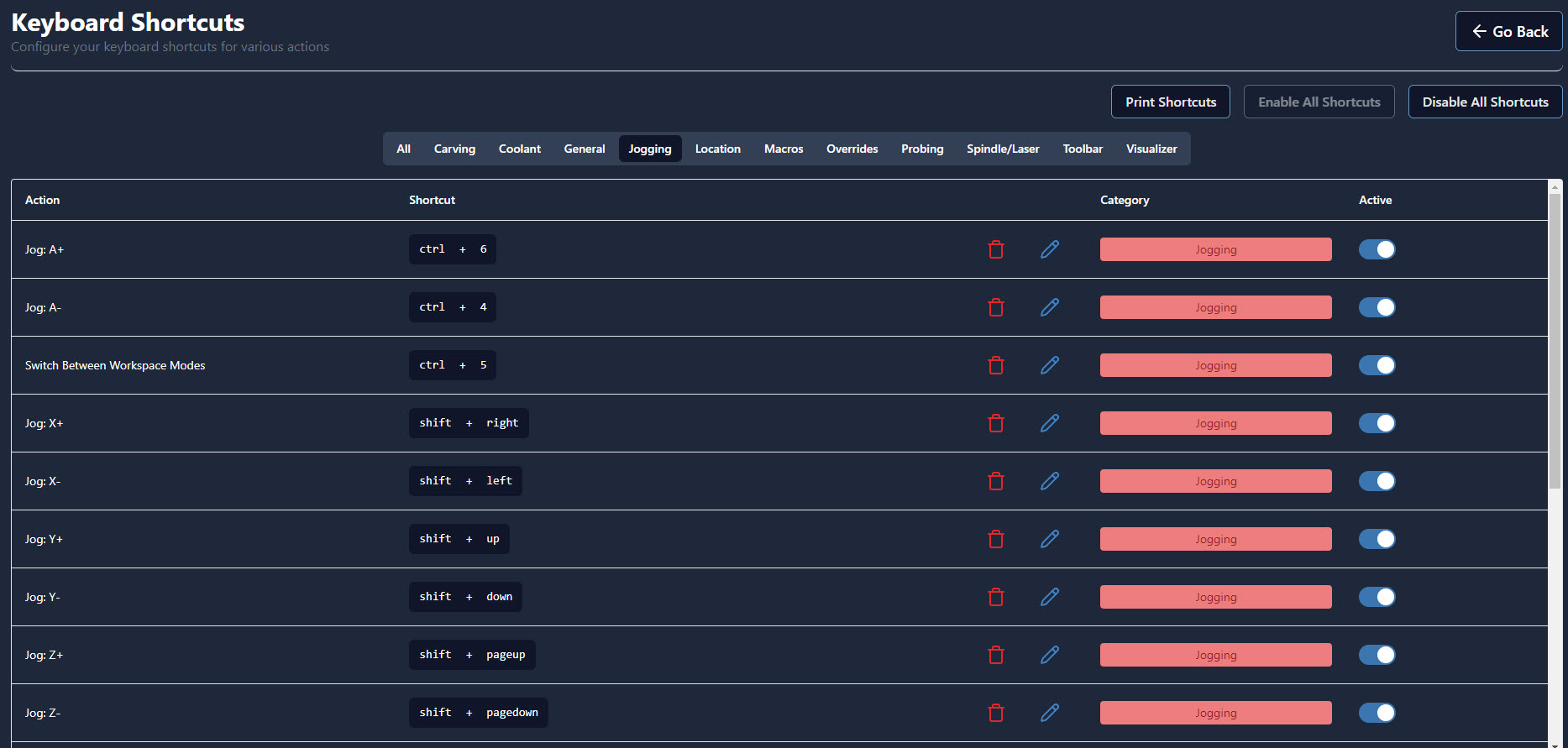

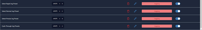

@ColonelClarence Yes it can! In our new gSender Edge 1.5.0 version 6, you can jog with these preset shortcuts:
And, you can select a specific speed or cycle through the speed presets with these shortcuts:
So, TLDR;
You can use the presets to adjust speed and jog, or create your own to match your preference.
