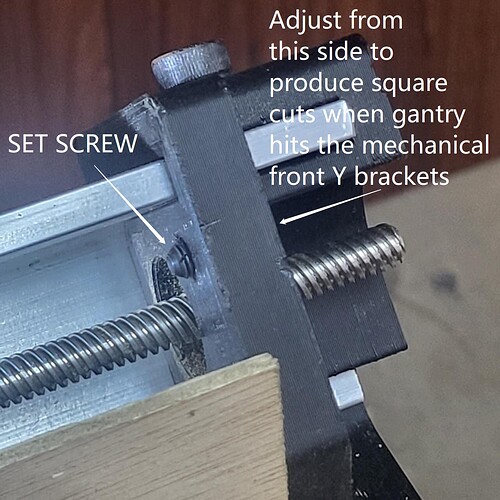

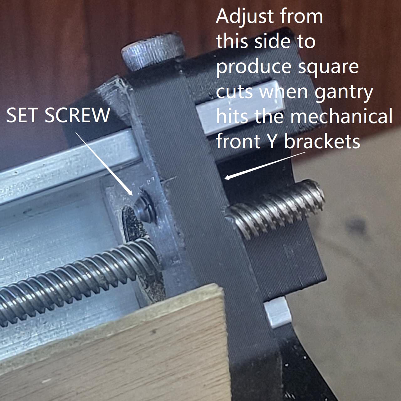

After mounting the Y rails, the gantry was moved until it hit the “Y” rail supports at the front. The gantry was actually moved very close to hitting the brackets and then the lead screws were turned manually until the gantry was pinned against the front supports (you can also use the “precise” setting and slowly jog the gantry until neither Y screw show additional movement). G sender may show increasing increments on the monitor because the system is “open loop” and it does not recognize the non movement.
The first step (after hitting the front Y supports) was to make a test cut from that position. The longmill was jogged 24” in each direction to route two edges of a piece 24” x 24” x 1/4” material. The resulting cuts were checked with a verified accurate framing square. It was noticed that the two machined edges were not square. The edges (in my case) were obtuse (greater than 90°) and that meant the right Y rail needed to mechanically stop earlier. If the measured angle was acute (less than 90°, then the left Y rail needs to mechanically stop earlier.
A hole was drilled and tapped (10/32 thread) in the front right Y rail support at a position that will hit the gantry side plate since the measured angle of the test cuts revealed an angle of more than 90°.(if the test cut angle was less than 90°, then the left front black Y support would need to be drilled and tapped) A set screw was inserted and adjusted stop the Y rail (see attached picture) Test cuts were repeated and checked with the framing square until the adjustment of the set screw resulted in cuts that were perfect 90°.
