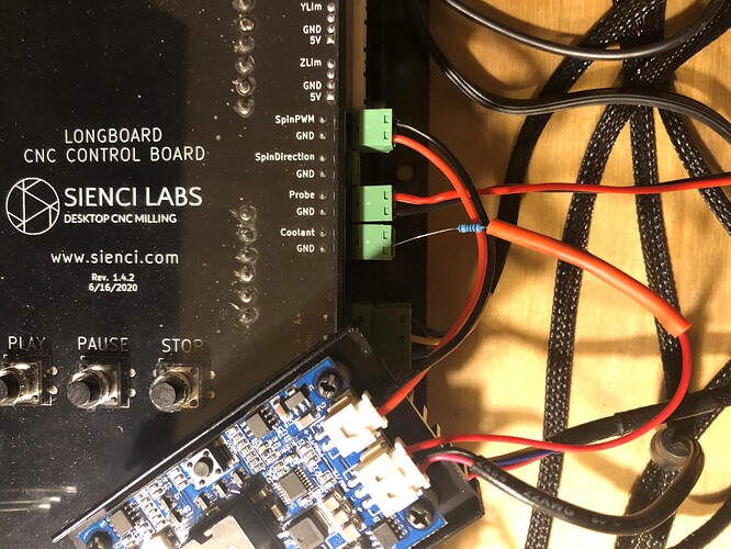

So this is exactly what I was seeing on my setup. Same laser as the video. Without the laser hooked up, the SPINPWM tested (per your posted info regarding check of the voltages) showed it worked fine till the laser was connected. At that point the laser was pulling that the Arduino signal to 2.5V+ with no Sx control which resulted in the laser constantly being fired regardless of my Sx value with an M4 command. My solution was touched on in a single message in one of these laser threads (I went through them all) which was to add a 1kohm pull down resistor on the PWM+ signal coming off the laser control board. Once I did that, the Arduino was able to sweep the voltages (0-5V) with the laser connected.
Also something during the testing for voltage during debug on the SPINSWM signal was to not set the $32 to laser mode ($32=1) during this check since it would require x/y movement in order for voltage to be seen. I must have missed that in the thread which had me thinking the Arduino was bad for a few minutes. Obviously, set it to laser mode when you’re ready to use.

@smpico1 seem to be having the same issue. This fix you mention is a bit beyond my pay grade. If possible would you be able to post a picture of the installed resistor for me?
John
Hi John,
Sure.. It’s messy as I haven’t cleaned things up.
So to clarify a few things with this image.
  1. The GND I used to connect the 1kohm resister was based on convenience due to wire length. It just needs to be grounded so any will do.
  2. The laser kit did not come with the 2 pin connector that would go from the controller board of the laser to the SpinPWM and GND connections on the Longmill control board. You’ll notice the red and black wires appear to go into the wrong connection but it’s actually the connector wiring that is backwards. It was all I had that would fit into that connector.
The single red wire coming out of the 3 pin connector on the laser controller and the PWM+ signal on the 2 pin connector are actually connected together on the board. I decided just to use that single red wire from the 3 pin connector to add the 1kohm resistor and tie it to GND.
Once connected this way, for me, when plugging in the laser, it will not immediately fire at full power. It will just turn on the RED led. Once you hit the button on the laser controller, the laser will turn on (Green LED) but at low power (for alignment). Once you actually start a print with whatever software you plan to use (I use Lightburn), the laser will fire based on the power settings you’ve entered into Lightburn (or other program).
Hope this is of some help. Let me know if you need more info and let us all know if you’re able to get things working on your end.
Steve

@smpico1 I received the resistors today and installed following your picture/instruction and IT’S ALIVE!!! It works! Thank you for all your help. It was bound for the garbage bin without it!!
