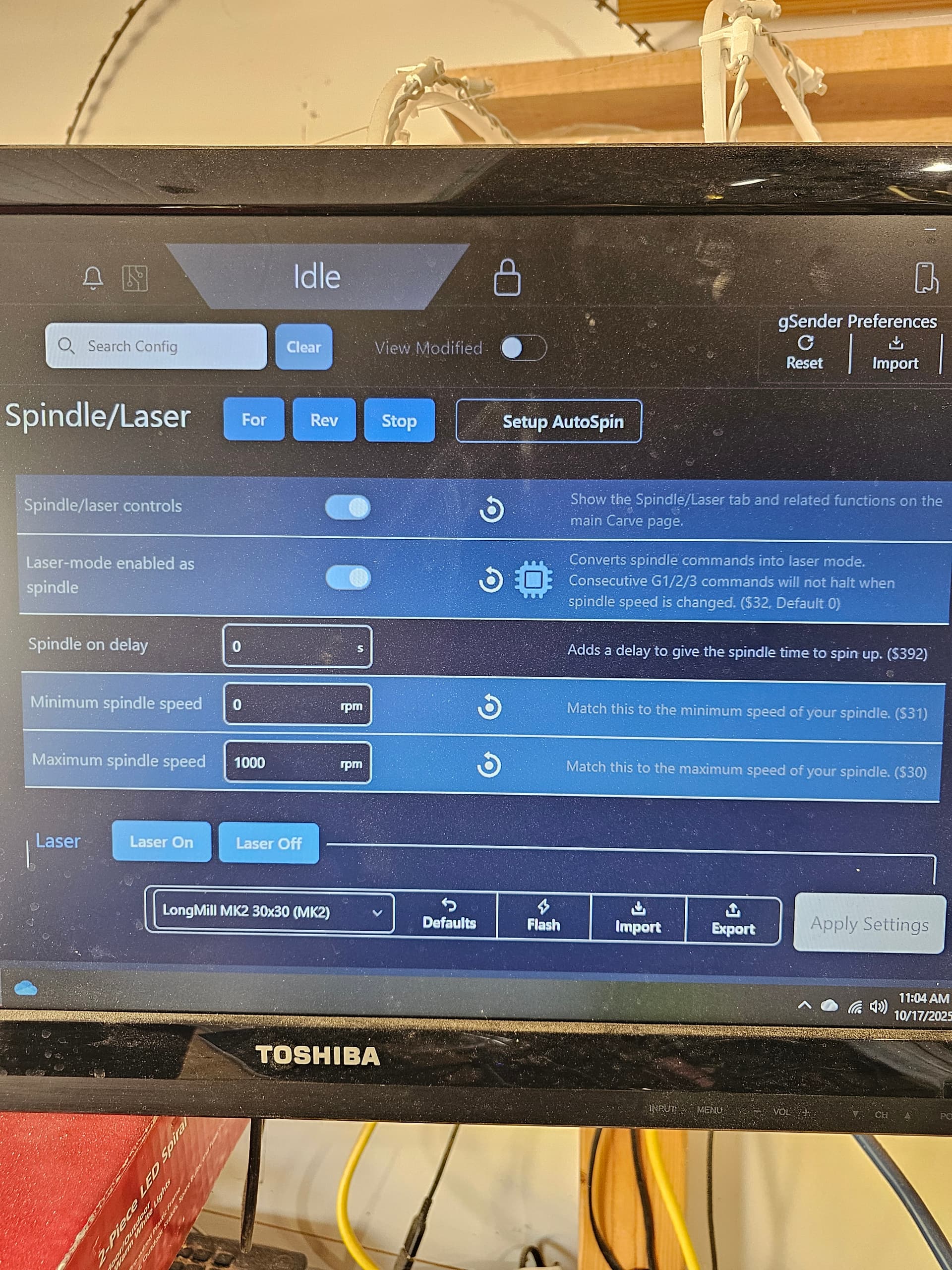

@gwilki settings are as follows
$30 is 0 default, left it alone
$31 or min speed 7200
$32 or max speed 24000

@TechMonkeyMatt You are mistaken about what those settings are. $31 is min = should be 0. $30 is max = some use 255. I use 1000. $32 is laser mode off and on = should be 1 when on, 0 when off.
@gwilki You are correct, I had the variables incorrect in my explanation not the software. I am using the gsender gui. I reset to values to your recommended and restarted long board. Laser comes on but will not turn off via software, will only turn off using the laser controller power button.
@TechMonkeyMatt Check the wiring. With $32 set to 0, the laser should never be on. With it set to 1, the laser should fire only when it is moving.
You are using a longboard, not an SLB, correct? Ensure that you are connecting by grbl, not grbl Hal.
@gwilki gwilkiverified wiring, laser only comes on when I hit test or on. Verified i am using grbl. And updated gsender to 1.5.5 today.

@gwilki your are just as confused as me.attached image a video for clarification.
@TechMonkeyMatt The screen cap does not show the laser settings. Seeing them may help, but it’s as likely that it will not. I’m sorry, but I have taken this as far as my knowledge will take it. I’ve had a pwm 10w laser module for some years. It worked fine on my LM Mk1 on the LB and it works fine with the SLB. I don’t use gSender 1.5.5 so I cannot help you with that. I have 1.5.4 on a test Uno so I can see all the settings, but I can’t see what a laser would be doing.

Thx for response & I apologize for my delayed follow-up. I now have the settings & laser worked once I figured out gSender (sort of). The process of elimination is a fine thing.
