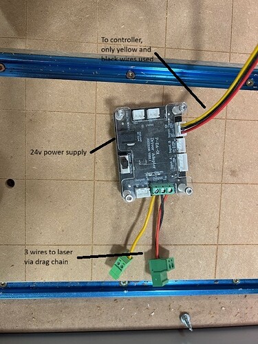

I went back to double check my order for the Laser Tree K20 pro. I ordered the laser, air pump for the air assist, and an extra lens protector for the laser, nothing else. I received everything I needed to get the laser up and running. I also have the Sienci labs lazer that they used to sell. I do mostly engravings and the one thing about the laser tree unit that I sometimes have issues with is the short focal length above the surface of the material being engraved. I sometimes carve a frame into a piece of material then engrave inside the frame. If the frame is deeper that the focal depth I can’t use the laser tree and must use the sienci laser with its interchangeable lenes.

I have used it many times with my old SLB, I upgraded recently to the SLB-EXT and have not used it since that upgrade but am sure it will work. How can I help you getting yours functional? Maybe take a picture of my wiring setup?
I just got my k20 pro hooked up on an LB. But I’m having issues that the laser comes on but doesn’t go off. Pic of someone’s functioning setup would go a long way
