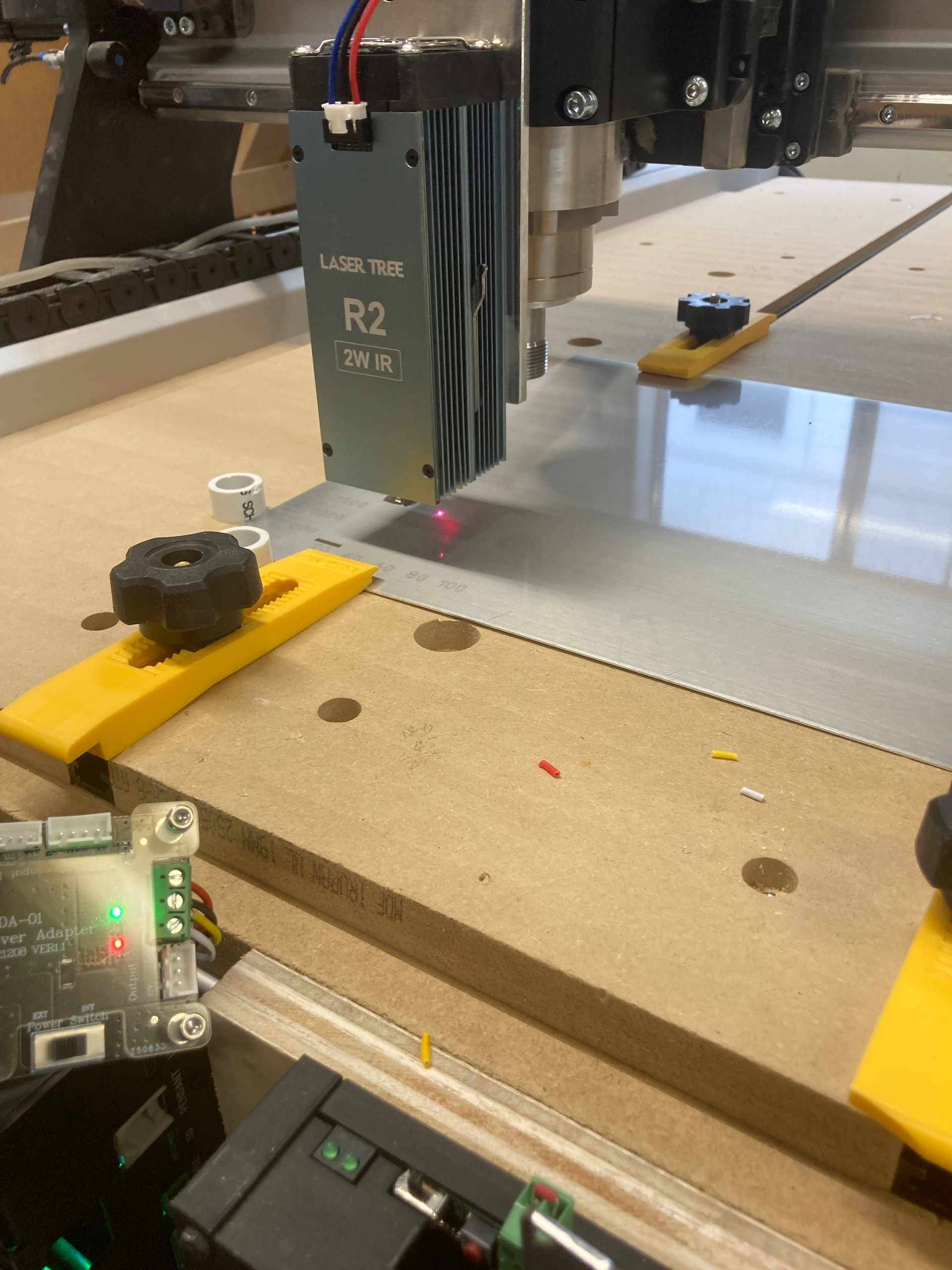

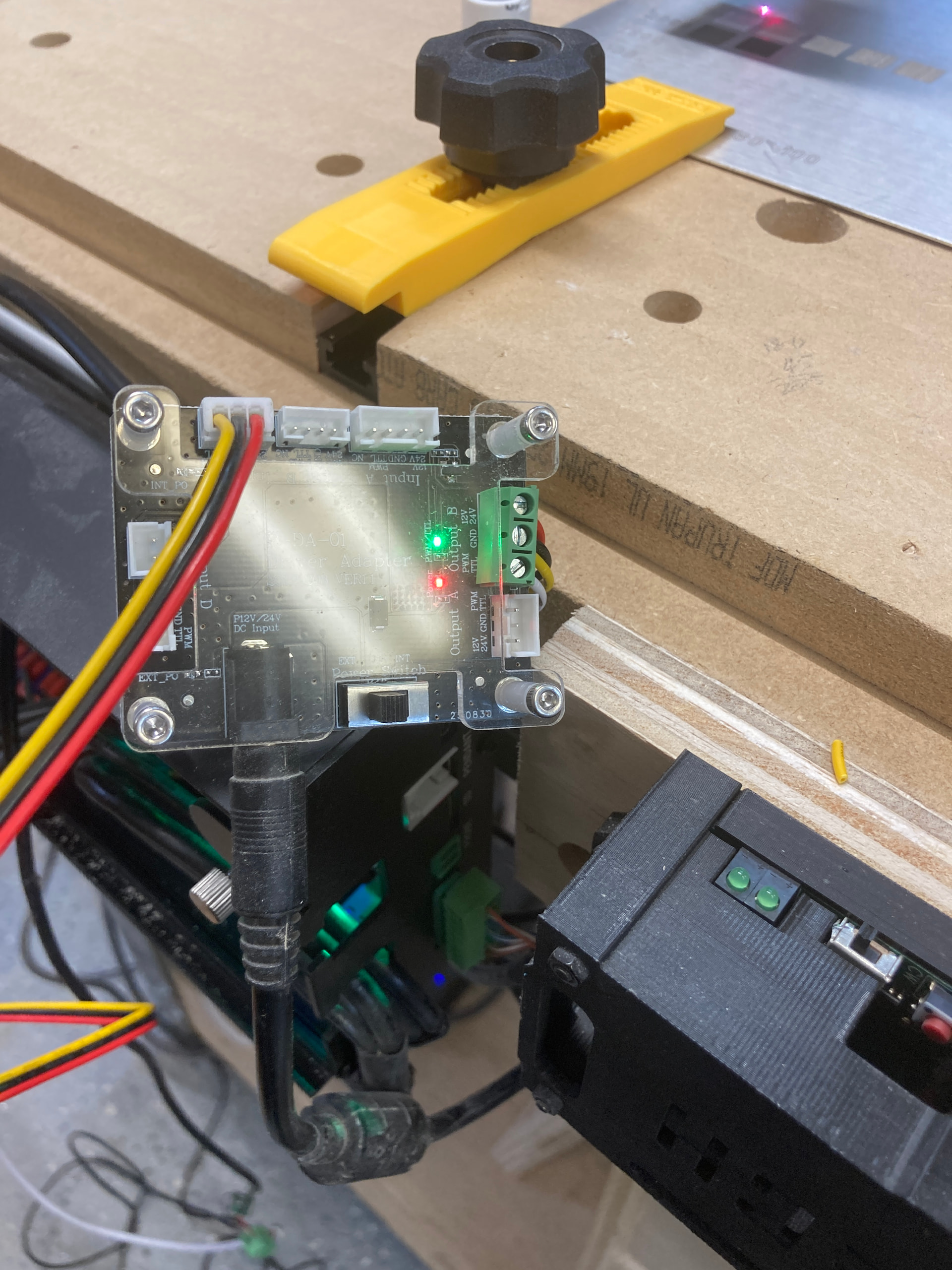

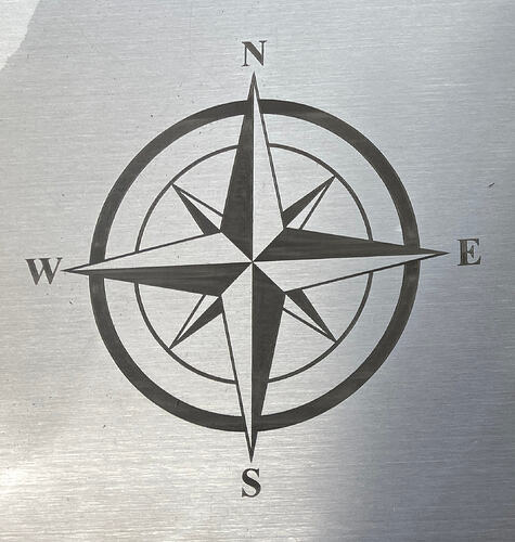

Got a LaserTree 2W IR laser module functional on my AltMill. A bit of a Frankenstein arrangement right now but got it working and first sample etch on brushed aluminum came out pretty nice.

Could you elaborate on some testresults regarding feeds and power.
Love the result, how long did it take to etch that?
@Spamming_Eddie The compass rose is about 3.5” x 3.5”. I etched it at 95% Power with a feedrate of 60 inches per minute. It took maybe an hour twenty to complete. I’m very early on in terms of exploring feeds and power so don’ t have much more to offer yet. Will likely run a power by feed rate test grid tomorrow .

I’m using it on my frankenstein SLB-EXT converted OneFinity X-50, aka “AltFinity”
