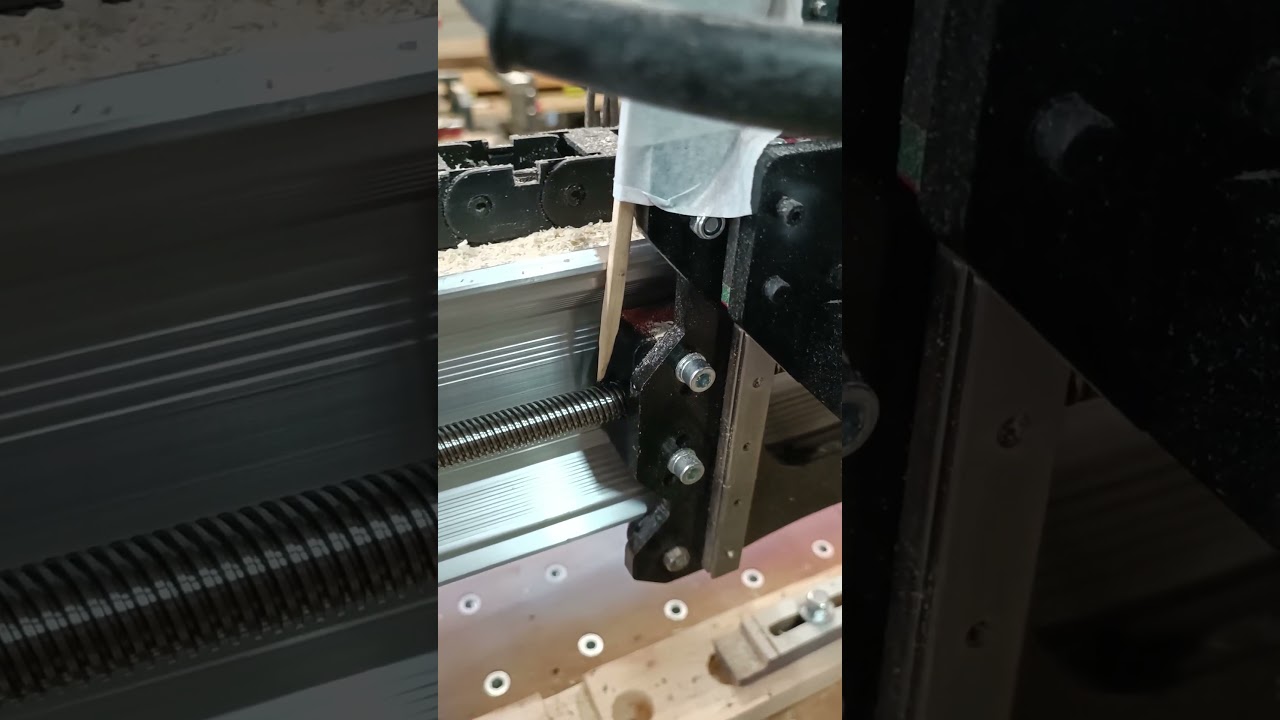

Sometimes, in my case more some than times, I too will engage in deep cleaning Mister Long. I noticed my lead scews were no longer blingblinging and after a closer look I was supprised the mill would even run anything at all down that lead screw. It was black from an accumulated mix of grease and wood dust.
I first went with an old tooth brush.. it worked.. a wee, but it got saturated within seconds and after that it kinda moved the goo from one groove to the other.
I had to come up with a way to do this quick and easy and after some grey fluf scratching this is what I came up with as my newest awesome (cheap ass always) upgrade to tha mill.
Introducing The auto lead screw deep cleaning jig thingy.
