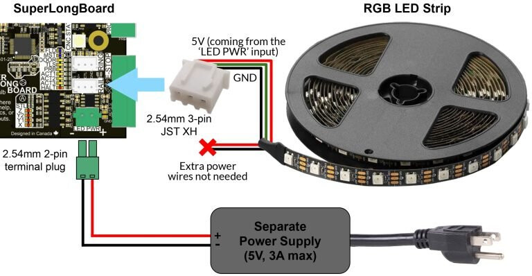

I connected the LED lights following the instructions provided in the Technical Manual under the LED Strip section. However, after installation, I noticed the lights remain on even when the SLB is turned off.
I’m using a 5V power supply to power the rail lights, and I’ve used the recommended LED strips. I also updated the firmware according to the number of LEDs I’m using.

Auto M356 P0 Q0 M356 P1 Q0
White M356 P0 Q1 M356 P1 Q1
Off M356 P0 Q2 M356 P1 Q2

@eortiz1 The only thing that comes to mind is the the + lead and the “signal” lead are reversed so that you are feeding the 5v directly from the power source to the leds.

I checked the wiring, and everything looks good. I’m wondering if the issue might be related to the firmware. I checked the voltage, and it’s reaching the lights, but they’re still not turning on. I also tested with the spare LEDs I have on hand, and nothing is happening.

@eortiz1 after thinking this through @peter_vanderwalt made the point that since the LED strip is powered by an external PSU, when you turn off the SLB it doesn’t have the time to tell the Rail LED strip to turn it’s lights off before the SLB itself turns off, and that leaves the strip lit up. This doesn’t happen with the ring light since it’s powered by the SLB itself so it loses power and turns off like you’d expect.
We likely can’t fix this through firmware, so until we come up with a new SLB design then the current workaround would be to power off the 5V power supply when you power off the SLB, or use an LED strip that draws low enough current that you can power it from the Ring output.
@eortiz1 I must apologize, Emanuel. As soon as I read @chrismakesstuff reply, I realized why I am not having the same issue, and why my input here was pretty much useless.
The power supply for my LED strip is plugged into a power bar. The SLB is plugged into the same power bar. I don’t use the power switch ont the SLB at all. That switch is on all the time. I kill the power to the power bar. So, I never have a situation where the SLB is off and the LED still have power.
