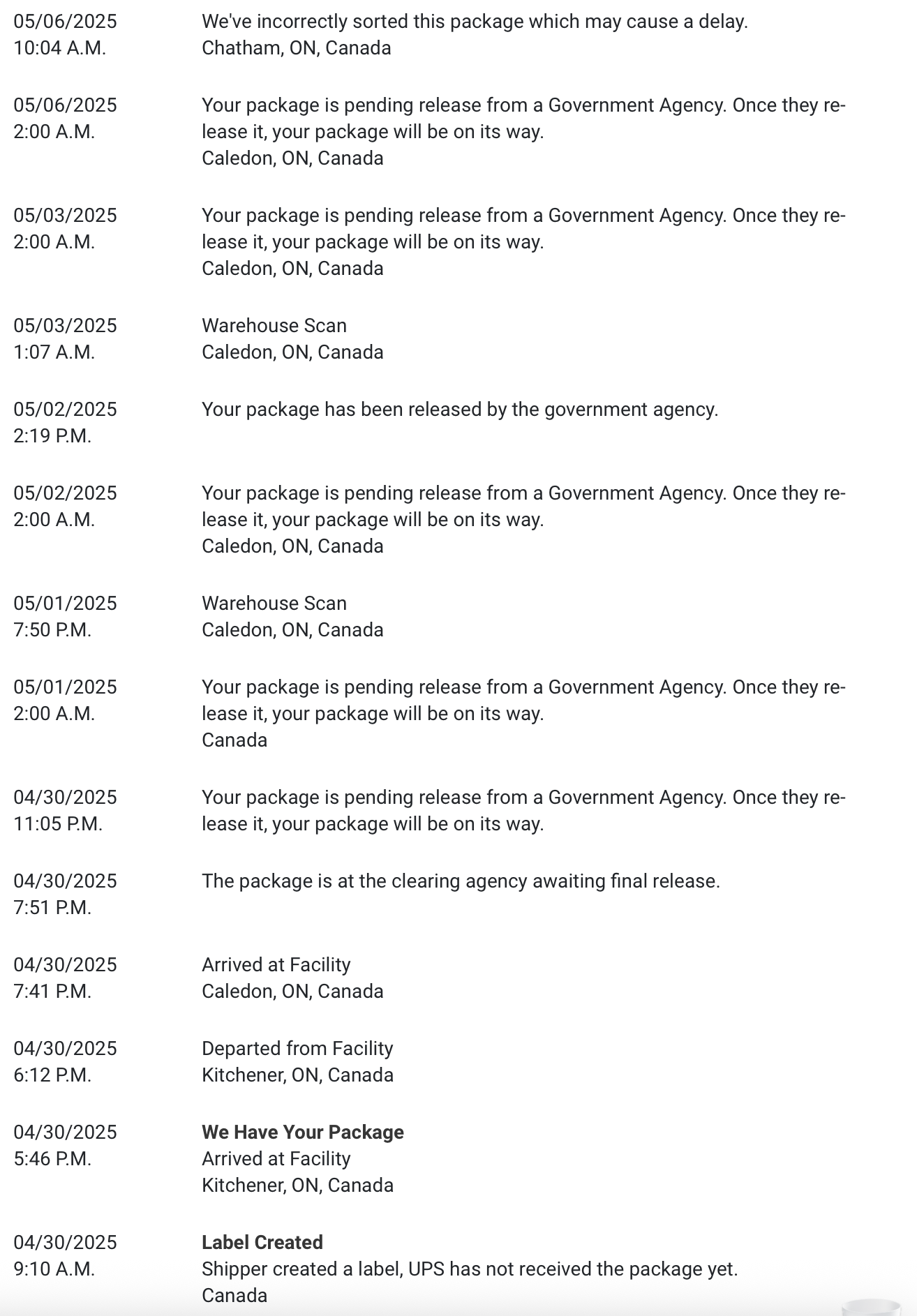

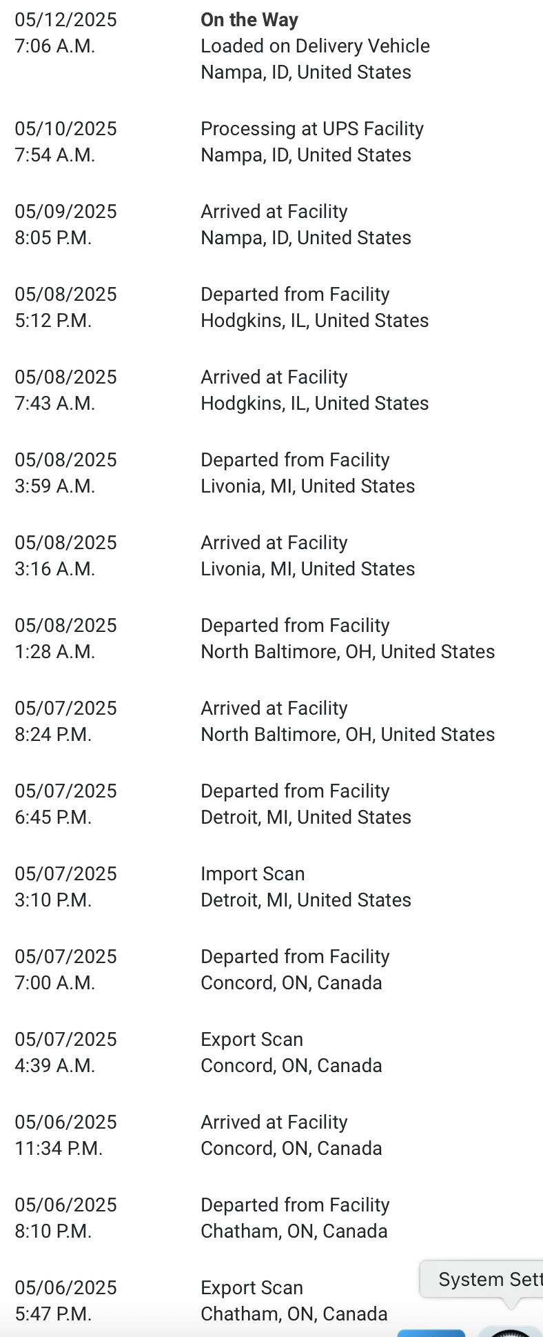

Long Wait, finally arrived

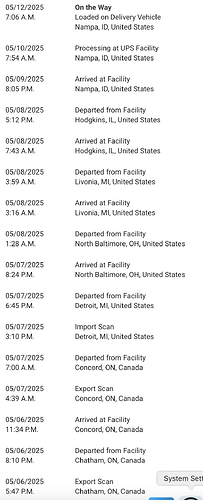

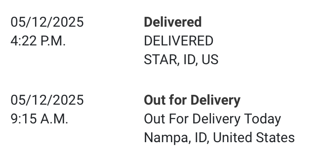

17 week wait time and another 12 days while UPS “incorrectly sorted” my order… But it arrived this past week and I got busy.

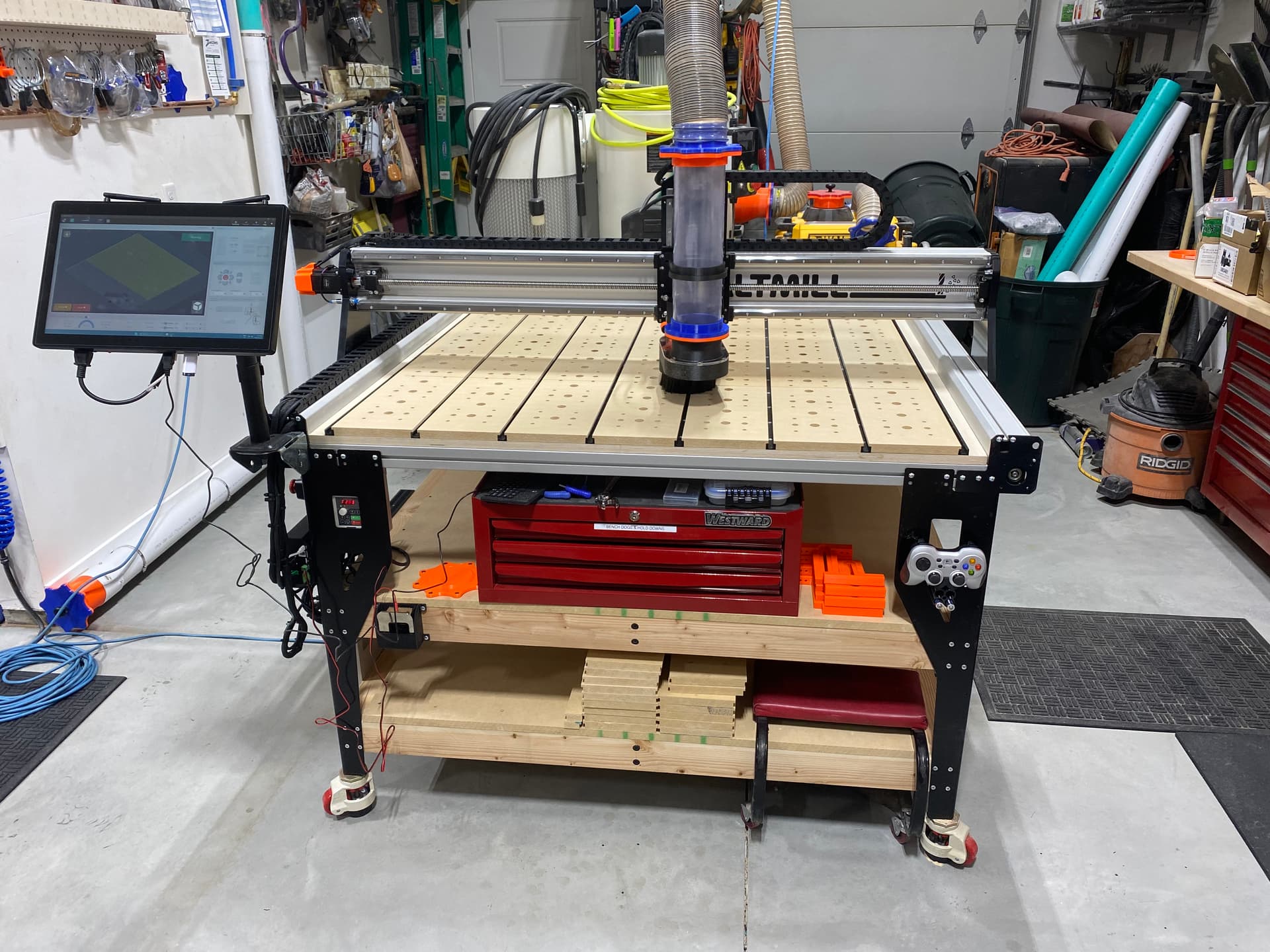

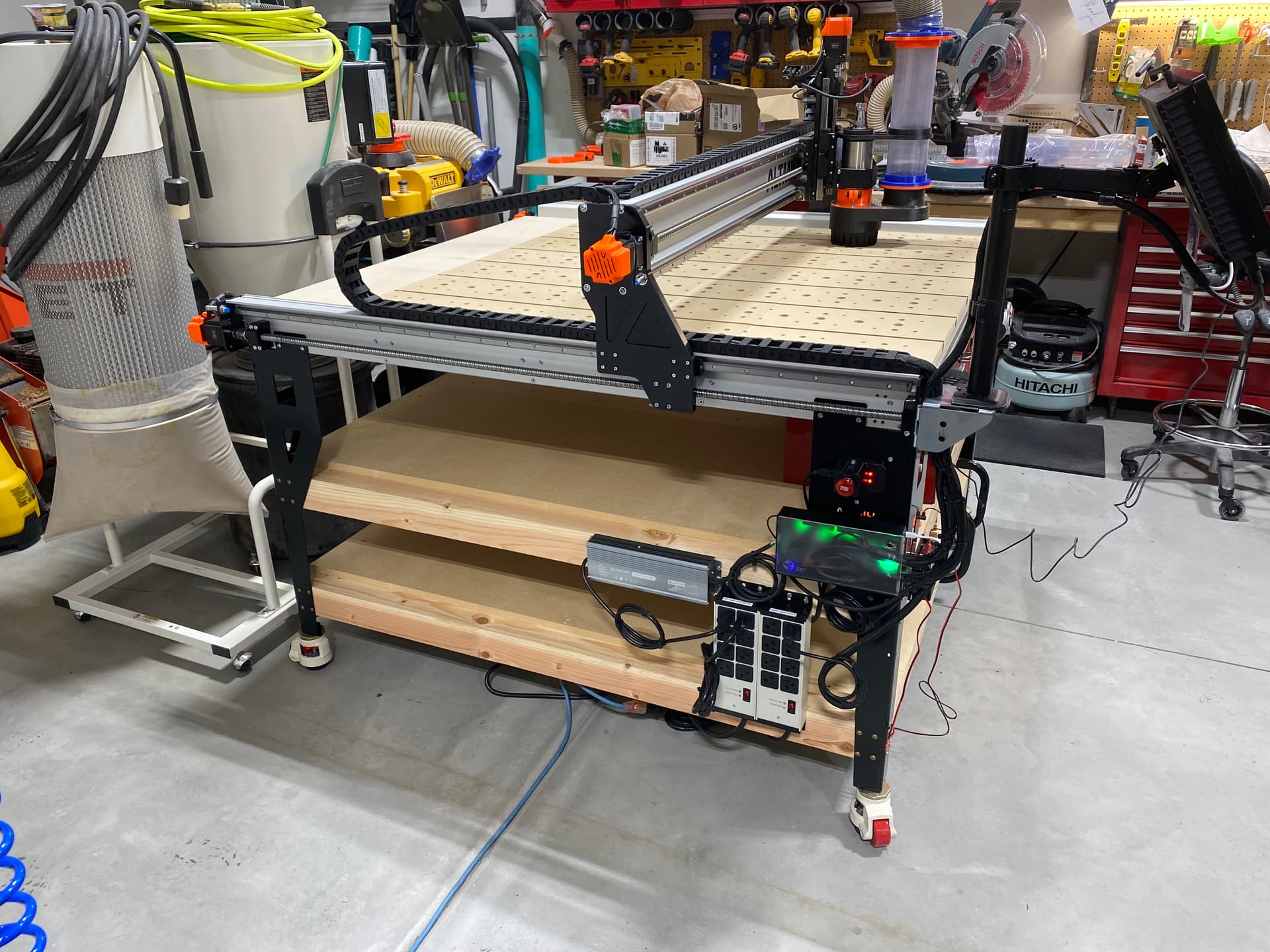

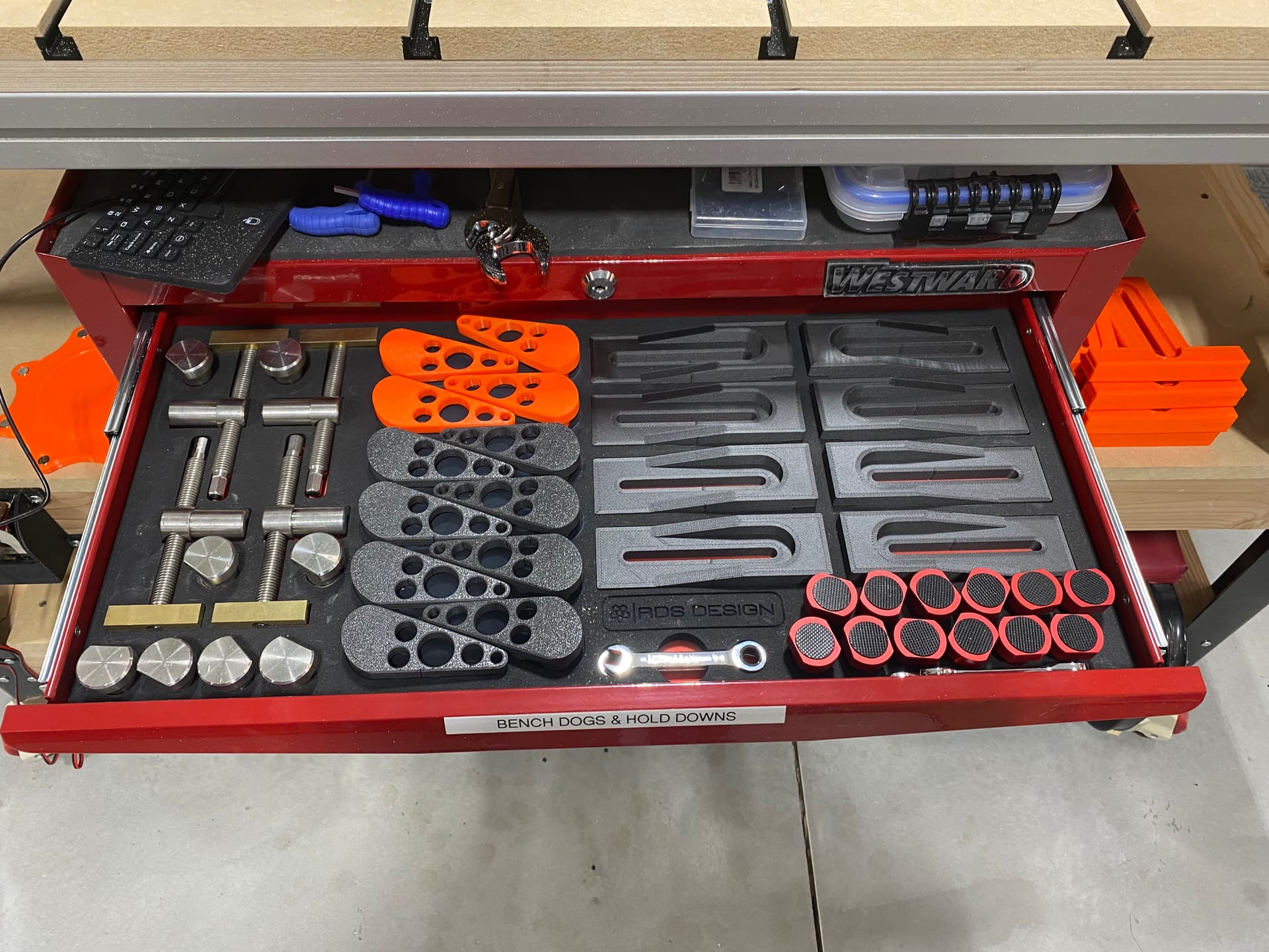

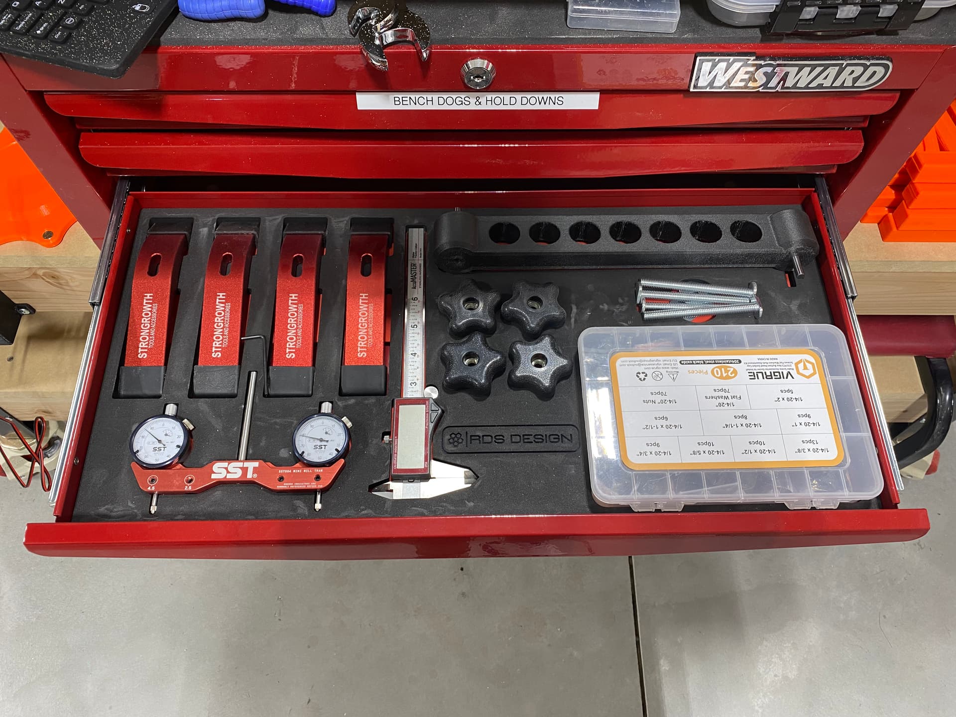

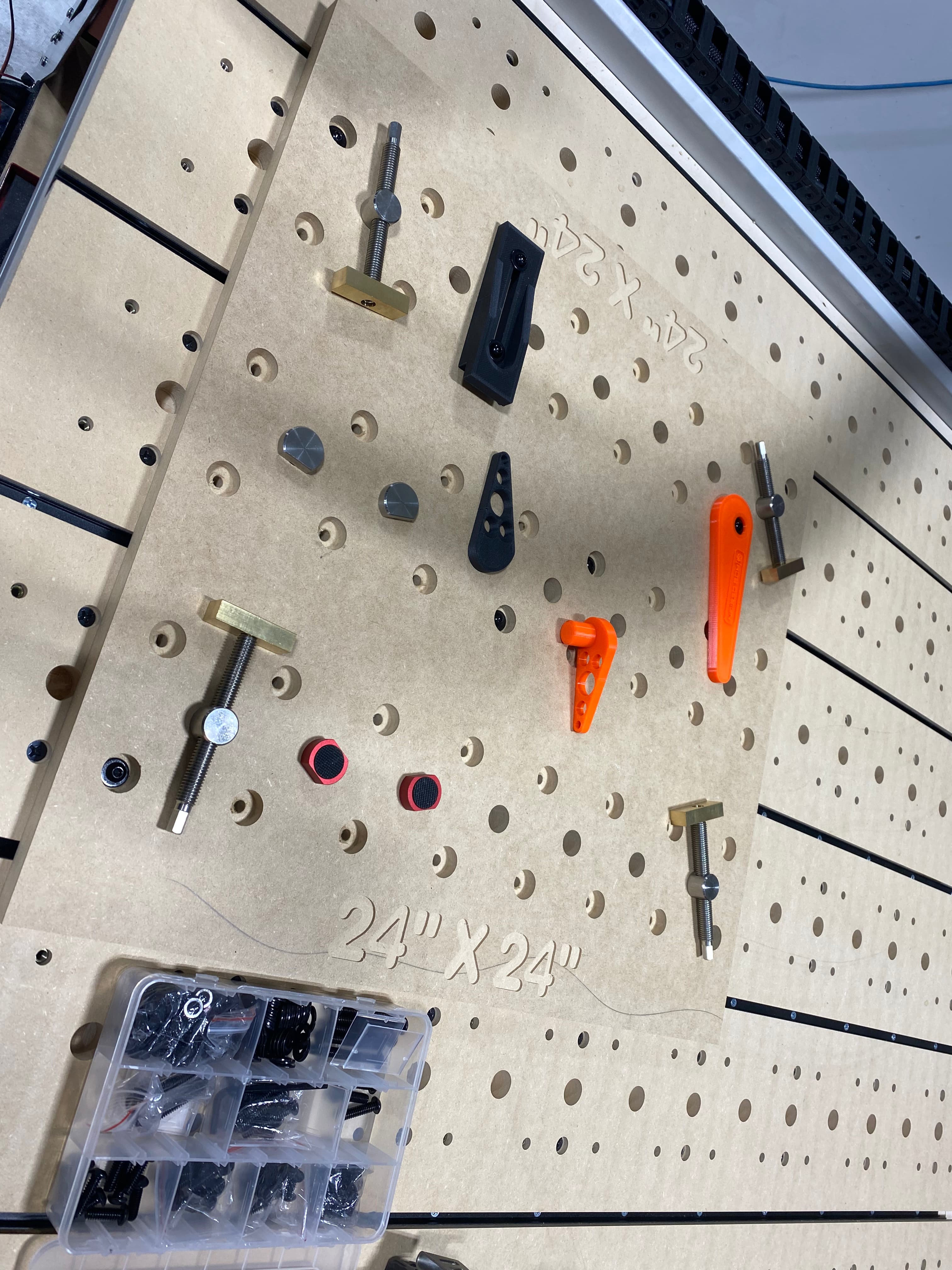

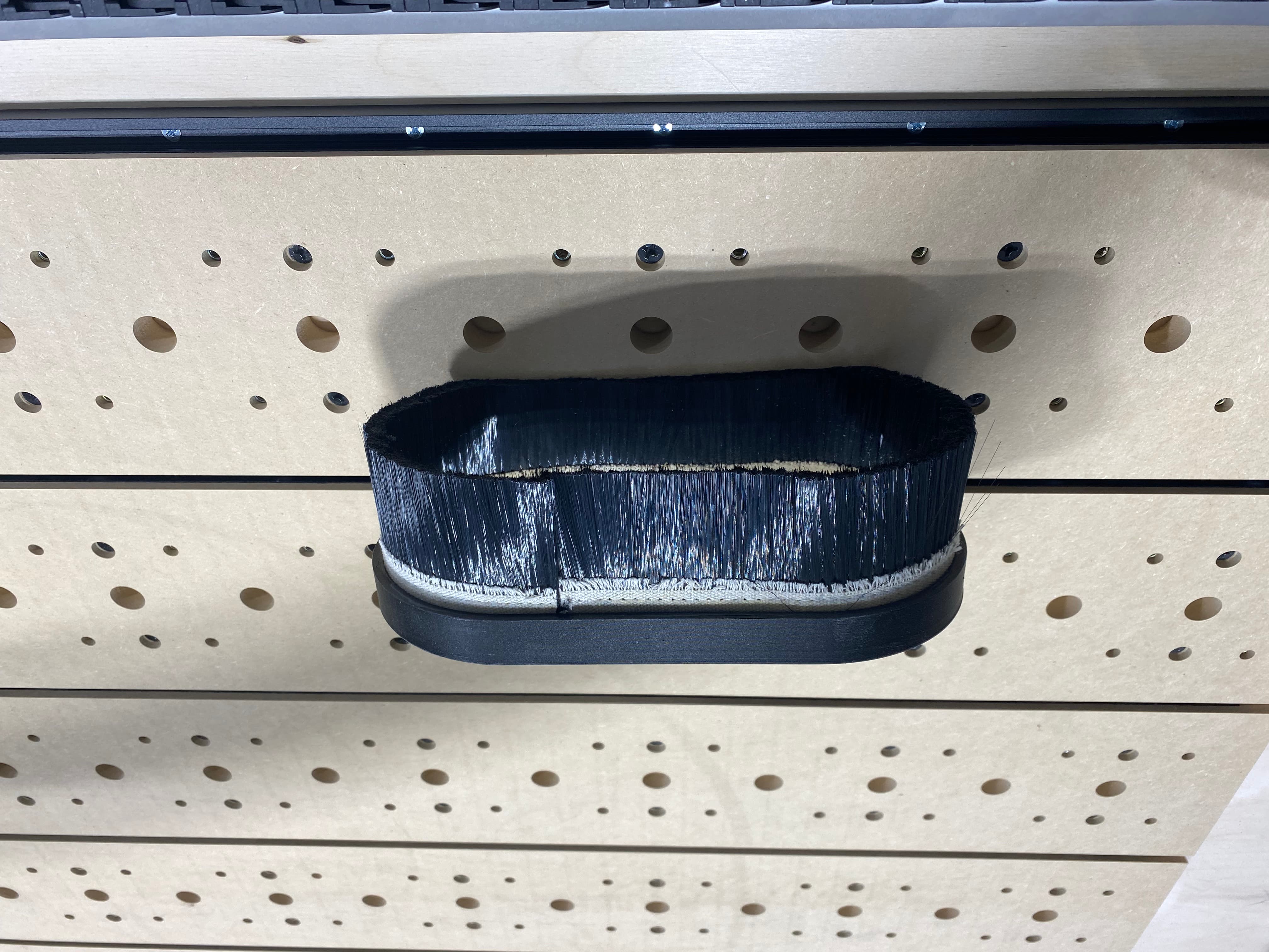

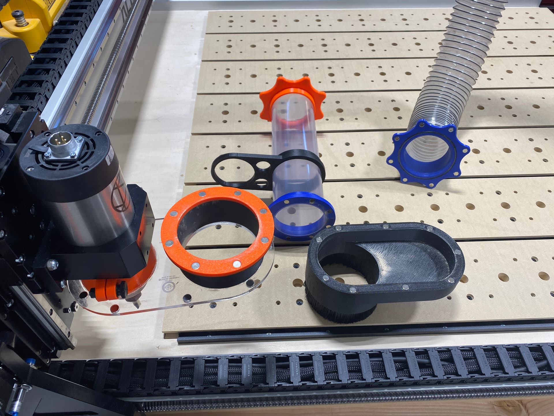

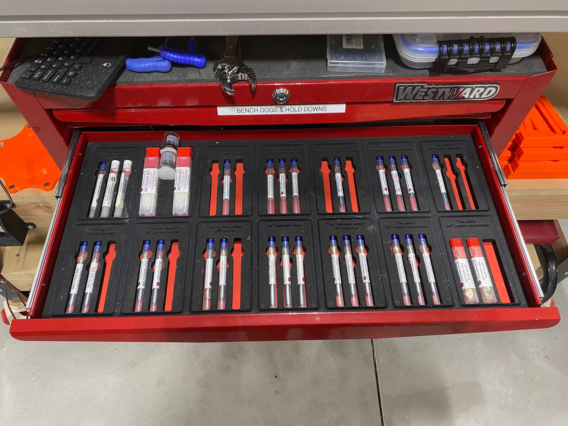

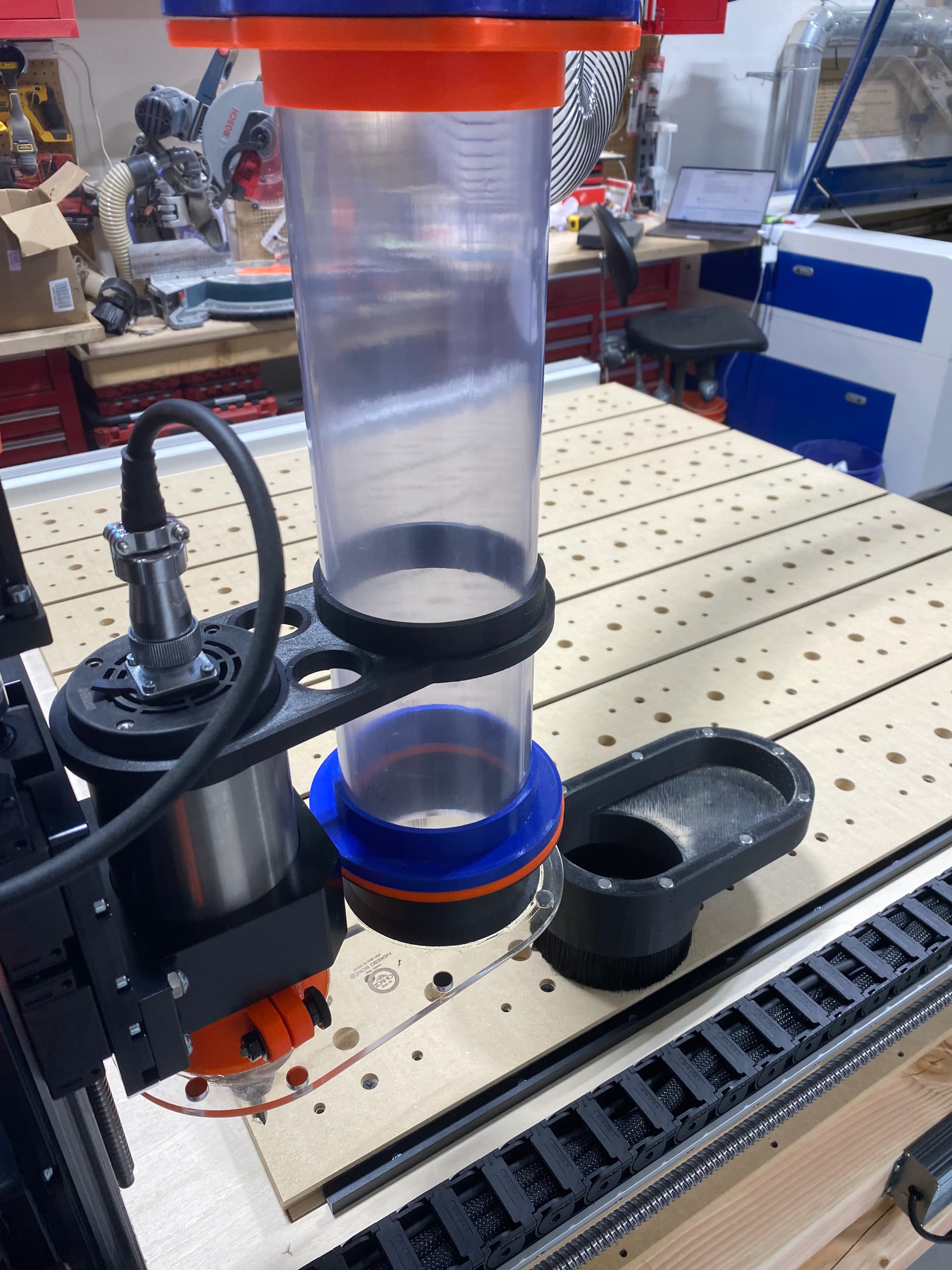

Laser leveled, trimmed, trued and surfaced. I designed and 3D printed the dust shoe along with a bunch of clamps, hold downs and bench dogs.

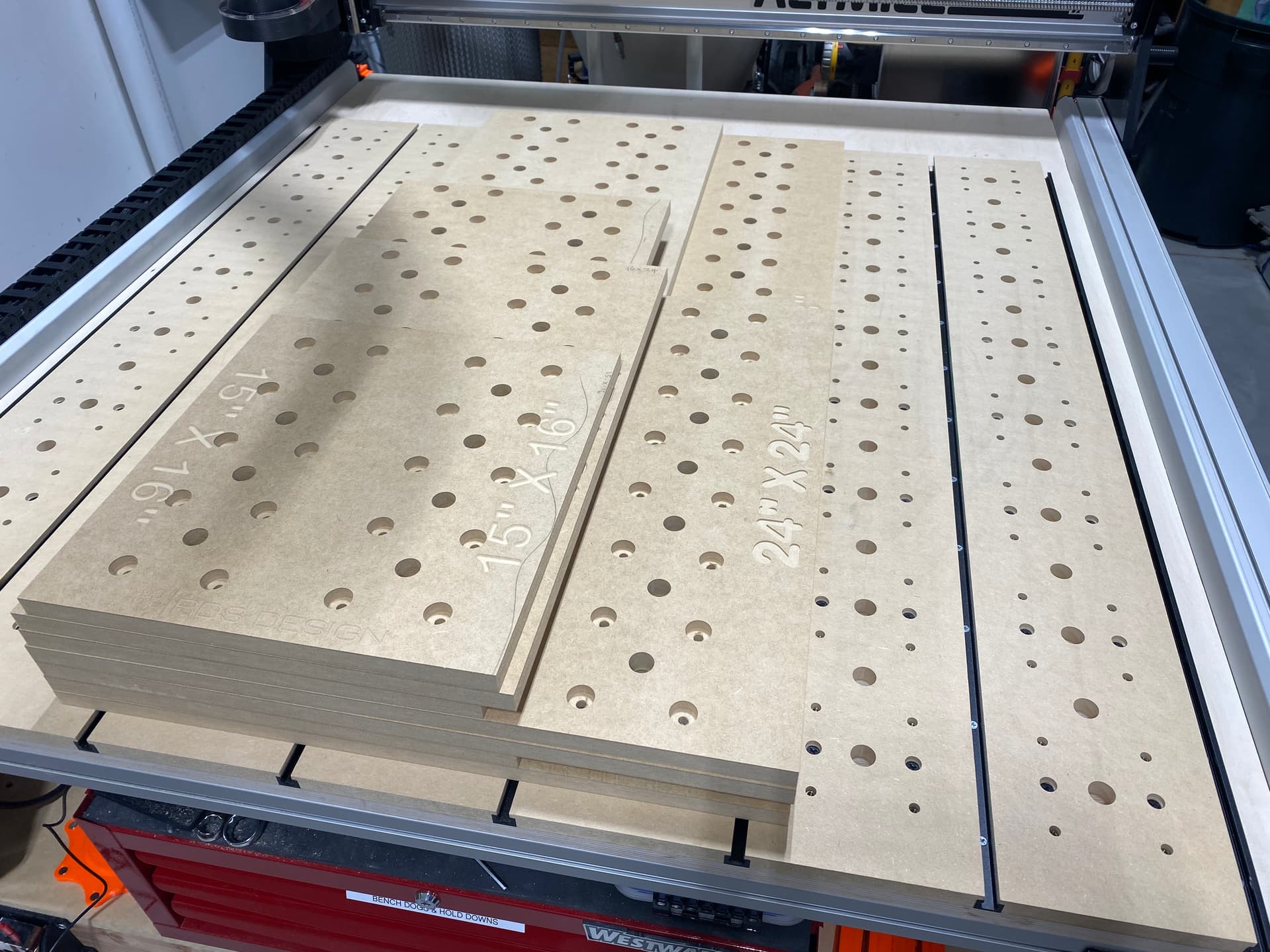

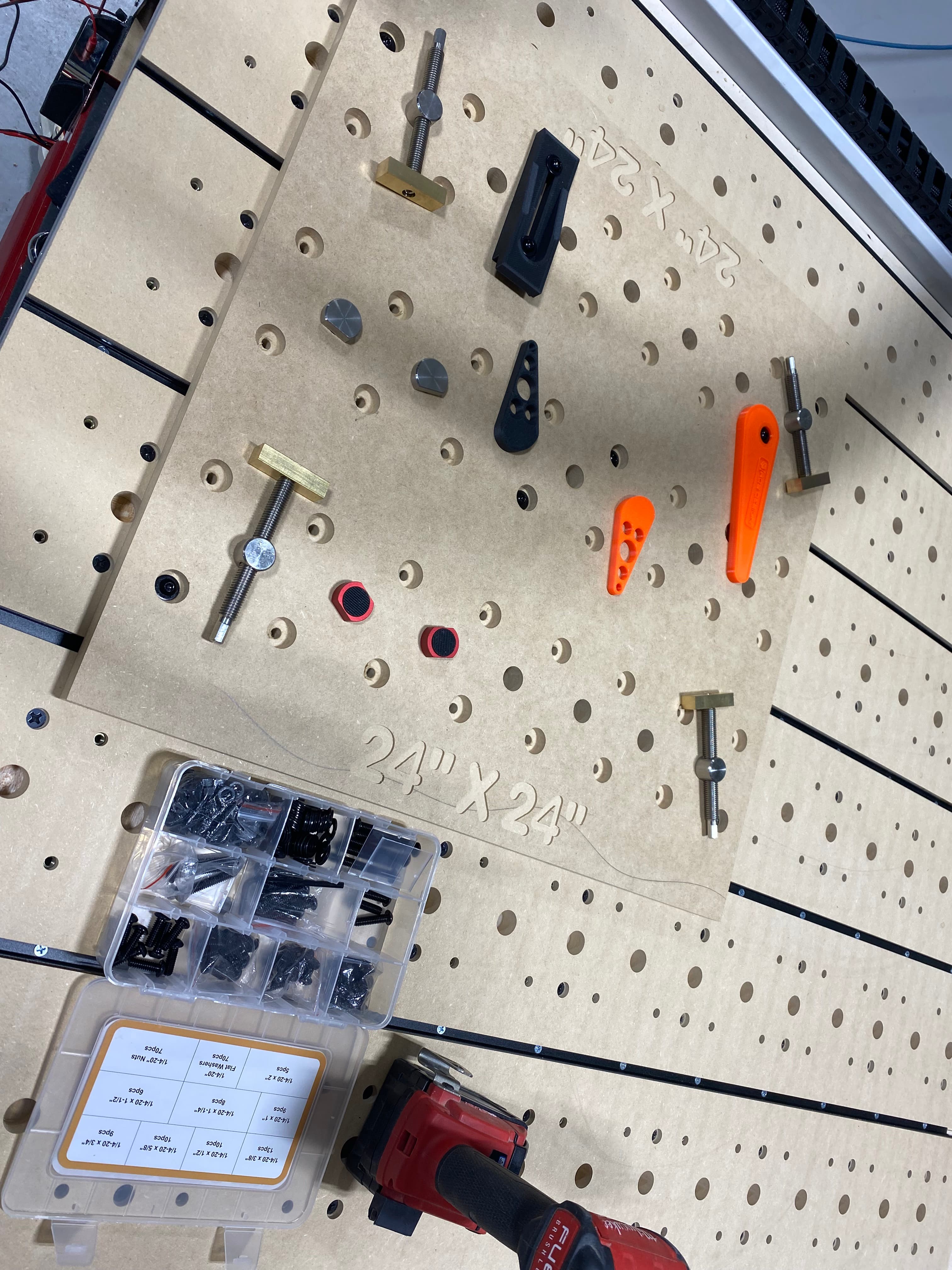

I’m still learning the Aspire Platform, but I designed the spoil board with a bunch of modular pieces that index on to the spoil board. I hope to never need to surface it again.

The clamps, hold downs and bench dogs is still a part that eludes me and I need to take more advantage of. So far I’ve just been clamping an intermediate waste board down on the t-tracks and either screwing or glue/taping the work piece to the intermediate waste board.
Incidentally, this weekend I 3D printed a different dust collector for mine, as opposed to the provided 80mm one. Kind of similar to how yours looks except the brushes fit around the entire oval on the bottom-side. No clue how well it will work but hopeful. I do need to find or design a hose holder for the top of the spindle still.

Yes, the first dust shoe I printed had the brush around the whole bottom. But I noticed the dust collection hose would lose the suction as the extra brushes moved off the material I was working on. I felt the smaller area the brushes had to cover, the better.
I noticed that after surfacing the entire spoil board, there was virtually no MDF sawdust left on the table. So I was pretty happy with the way the dust shoe worked.
this one, not as good
I appreciate that feedback - I may hold off gluing the 2nd set of magnets to the shorter brush set until I test then.

Where did you get the casters if I might ask?
Thanks, I’m pretty happy with the set up. I got the wheels from Amazon. The mounting stud is like 1/2" so you will need to drill the holes in the legs just a slight bit bigger. I knew that going in, but it wasn’t a big deal.

Just wondering why you’re using two wasteboards? Or am I misreading what you’re stating?
I have a piece of 3/4" mdf screwed down to the AltMill’s x-rail oriented extrusions and on top of that are the individual segments of 5/8" mdf pieces screwed down to the base 3/4" mdf, with t-track sections between each of them. I surfaced the one and only spoilboard (the 5/8" sections) and yes from time to time I mill down into that surface by .01mm or so. I haven’t yet had to resurface the spoilboard, as it’s still perfectly true and none of the milling marks are anything to worry about.
I guess my view of spoilboards is that they’re “spoil” boards and it’s no big deal if they get milled a bit from time to time.

My main comment pertains to your dust shoe. I have the stock dust shoe and am reasonably happy with it… except I’d be happier if it was capable of automatically positioning itself vertically so that the brushes were just touching the surface being milled at all time - even as the spindle lowers and raises during operation. Yours appears to be set up to operate just as mine does.

I also have a comment about having rollers at the bottom of each leg. Is that because you anticipate having to move your machine around the shop? I would caution that unless your shop floor is extremely level (mine sure the heck isn’t!), then there’s a strong likelihood of having to relevel it whenever you move it. Please comment on that issue.

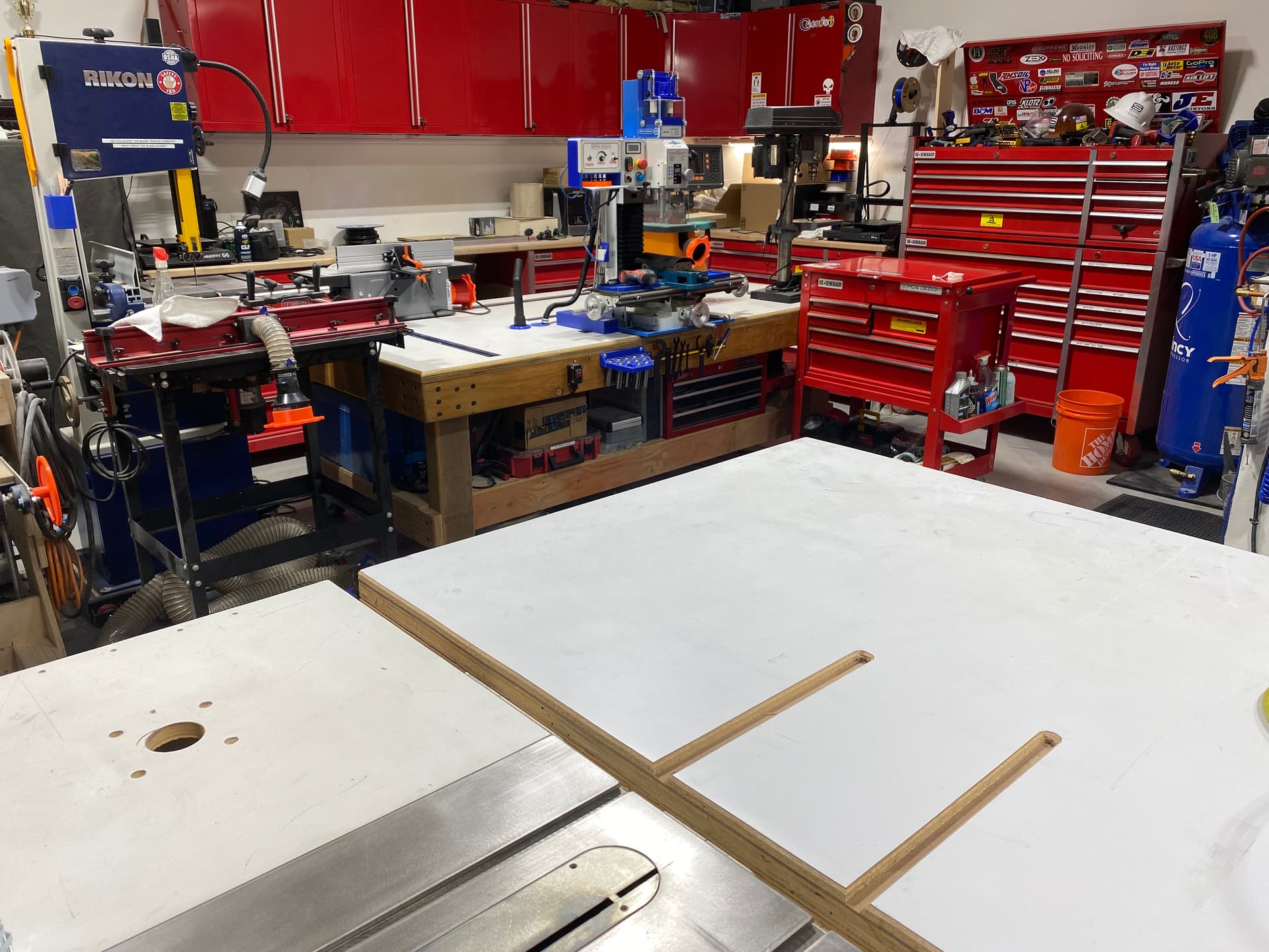

2 waste boards… just a me thing. Probably for the same reason all of my workbenches get a layer of white formica on them. Clean and consistent.

You don’t by chance have a file for the dog holes on your mdf slats do you?

Given the casters only have one pin connecting it to the legs. How stable are they? How have they been holding up the last year? I’m considering using the same. Have a similar set on my work bench that uses 4 screws and it is awesome.
As to others comments; you can lift each caster independently for quite a bit allowing you to fix small level issues when moving it.
