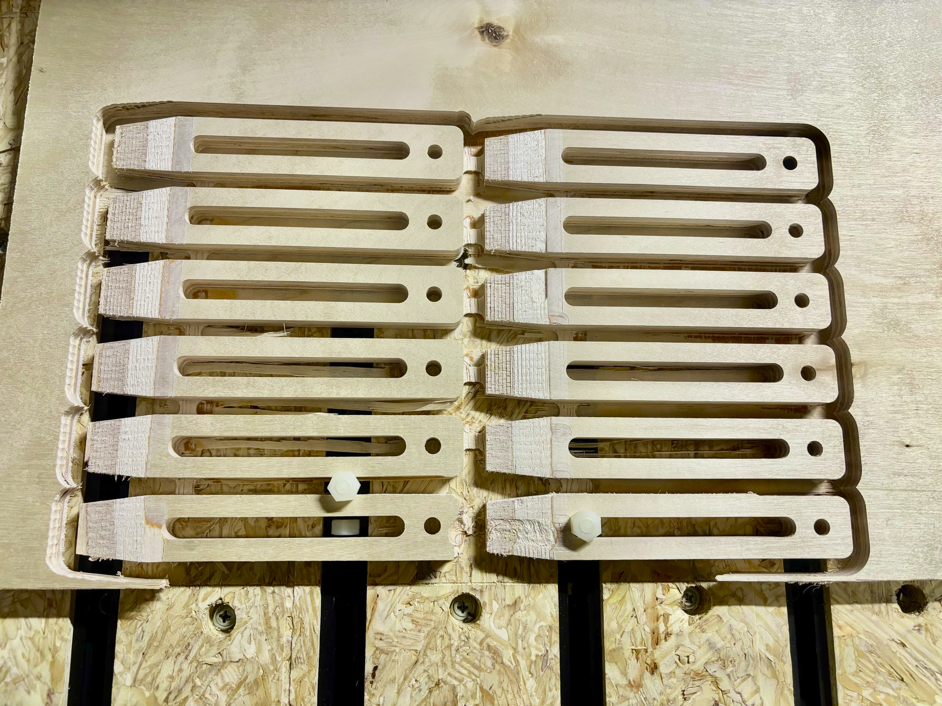

I made up some clamps in Fusion 360 and completed my first semi successful batch. I had to stop mid way through to add some additional clamping. This was due to the corner not being held down enough and my taps got cut out. Its very satisfying just having that super thin skin of wood to peel away!!

@TMS4659 And you oriented them properly along the grain of the plywood’s face ply (assuming the face ply is not just a thin veneer)

I made my clamps out of 0.5” you might want to go a bit thicker, maybe 14mm because my clamps are deflecting and I cant get as much clamp pressure as I would like on bigger projects. Could be my cheap ply material too.
