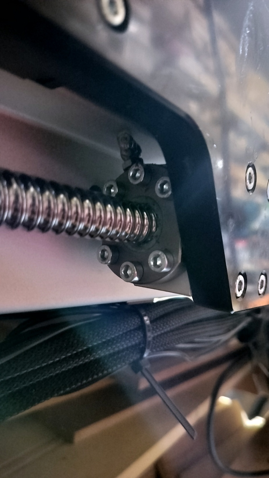

I am in the process of doing the maintenance on my Altmill and wanted to get a better understanding of the issue with the ball screw on the left side Y axis.
Can you please elaborate on what you mean by “turning it over” for the ball screw? I don’t quite follow your explanation. I have remove the 4 screws on the X-axis gantry but don’t see how the ball screw can be turned over or flipped.
This is the orientation of my ball screw at this time. Is this how the ball screw was oriented your your machine?
If you could, please provide me with how to move the nipple for easier access.
Thanks,
Eddy
Eddy,
If you remove the 4 machine screws holding the ball screw to the gantry plate on that side, then jog the machine 80mms backwards (document the exact distance you moved it, so that you can move it back when you’re done). That will then provide you enough free space between the assembly and the rail to allow you to carefully rotate the ball screw assembly 180 degrees (the rotation direction won’t matter). Doing so will temporarily bend the drive screw very slightly, but it’s resilient enough to return back to its original position right away. There should be enough slack space between the assembly and the rail to allow you to rotate it without undue force. Then before doing anything else, jog the machine forward the same distance you’d moved it prior to rotating the ball assembly. If you did that correctly, because the screw holes in that assembly are drilled completely through, the holes in the gantry bracket and the ball assembly should be lined up perfectly. Because the holes are threaded the full way, you should be able to then screw the machine screws back into place. DON’T overtighten them, as you’ll risk stripping them. I used a bit of LokTite (the low strength version) on the screws just for added security against them loosening off.
Hope this answers your question.
Cheers,
Marty from Kingston, ON :canada:
