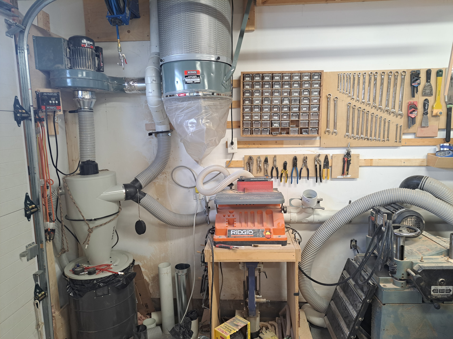

Old system,
One stage 220v 2hp King Canada dust collector with a 1-micron canaster that is 1200 CFM’s and a static pressure of 9.5, 4” PCV piping and fittings and plastic blast gates.
Updated system
Updated the one stage 220v 2hp King Canada dust collector into a two stage with a cyclone separator. Changed the blast gates to aluminum blast (no longer have bypass issues) and made two zones where I can shut off one side of the shop when not in use right at the cyclone separator, so I don’t loss any air flow to a side not in use.

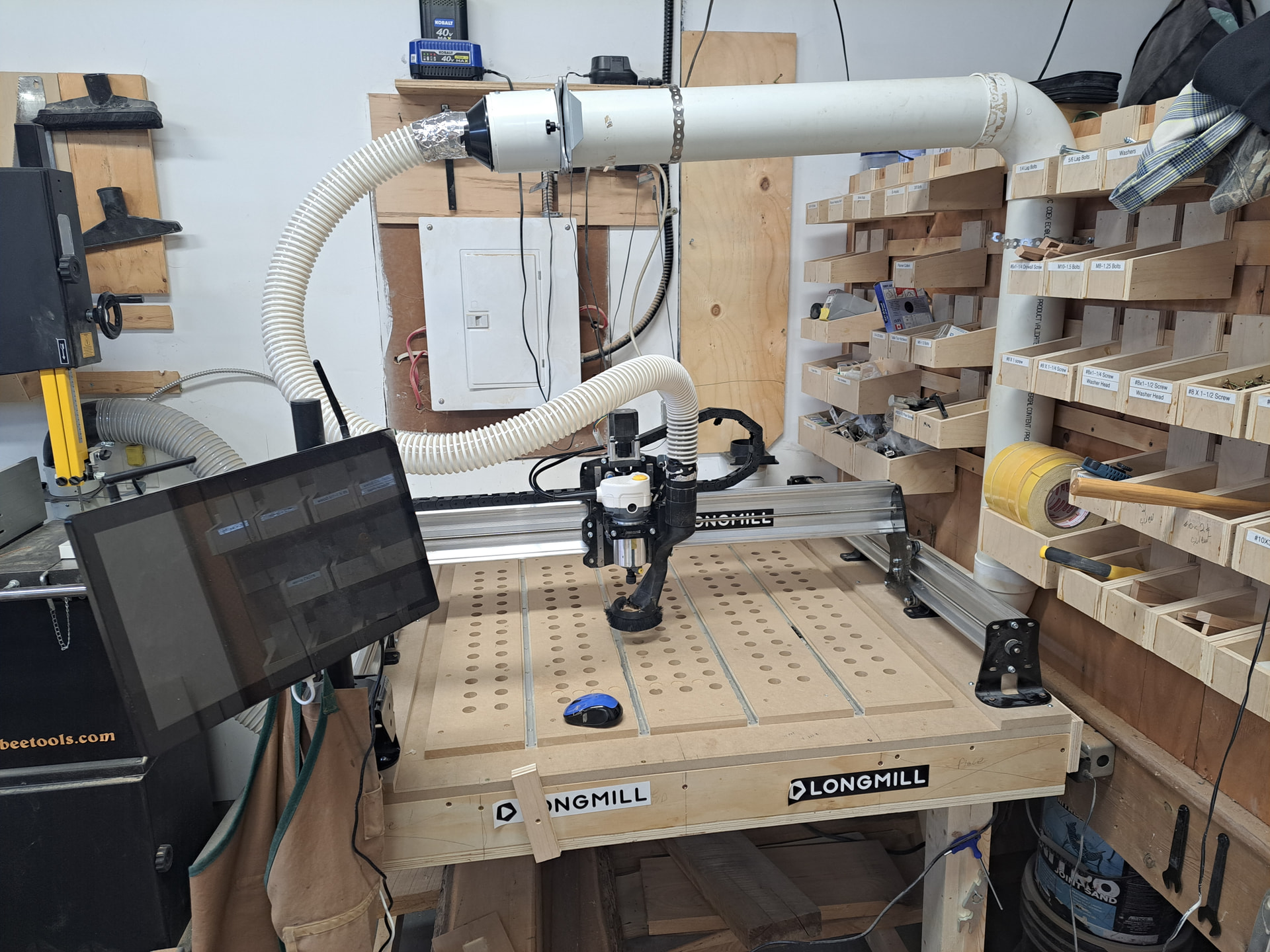

Used an Anemometer to take reading at the inlet of each machine in feet/minute. The meter said that it was just Hi at the dust collector as the suction was so high. At the CNC machine with 5’ of 2-1/2” flexible hose was 3150. Removed the hose a took a reading at the reducer and it was 5600. Removed the reducer to get the full 4” opening and it was 6300. Then took a reading at the clean out just before the 4” piping for the CNC machine and it was 8200. I don’t think getting the 4” piping closer to the CNC (reduce the 5’ section of 2-1/2 flexible pipe) inlet will make much of a change as the LongMill MK2 Magnetic Dust Shoe has small inlets.
I don’t know how much of an improvement in air movement there was from the old system to the updated system as I didn’t have the meter until I updated the system. But I can tell you that I can feel a vast improvement. After installing my new Auto Spin T1 router I trammed it and then resurfaced my spoilboard. I can tell you I had no dust in the dust shoe or around the spoilboard.

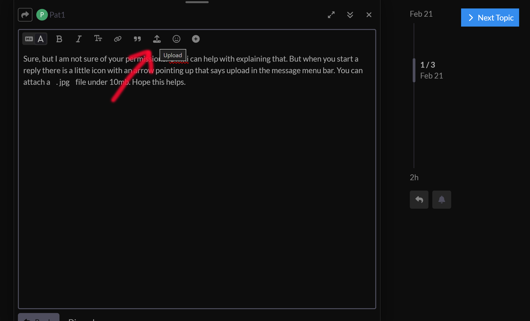

Karver, do you know how i can attach pictures? Thanks
Sure, but I am not sure of your permissions. @Gwiki can help with explaining that. But when you start a reply there is a little icon with an arrow pointing up that says upload in the message menu bar. You can attach a . jpg file under 10mb. Hope this helps.
Karver, sorry for not getting back quicker. I am doing cabinets for a ladies dressing room and it’s taking longer that I expected. As this is an old century home getting it up the stairs is not easy. I had to redesign it and instead of making 4 cabinets, I am making 8. Each one had to be made in a top and bottom section and I used dowels to hold them together. Nice lady, she is paying me more do to the extra work. Now on to my dust collector system. I have a chance to use it for a couple of weeks and it works great. The only issue is that the dust shoe has a small opening which is the leading issue. The rope on the duct collector is used to hanger the cyclone so I can remove the bin underneath to empty it. The dust collector system is divided into a East section and West section. That way I can isolate the side I am not using.
the duct pickup.

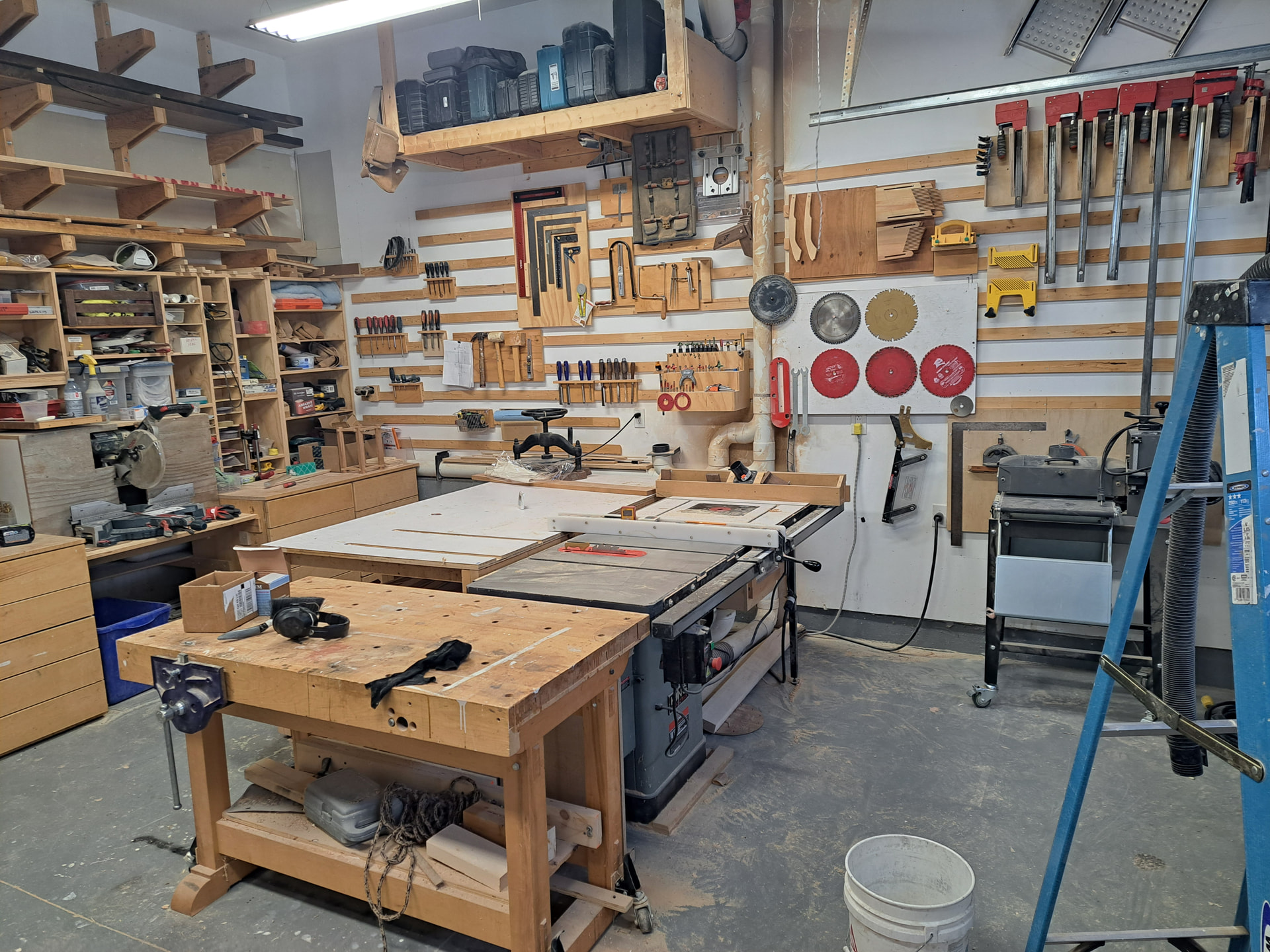

Now that looks like one fun garage =)!
Yep, thanks. 35 years in the making.
