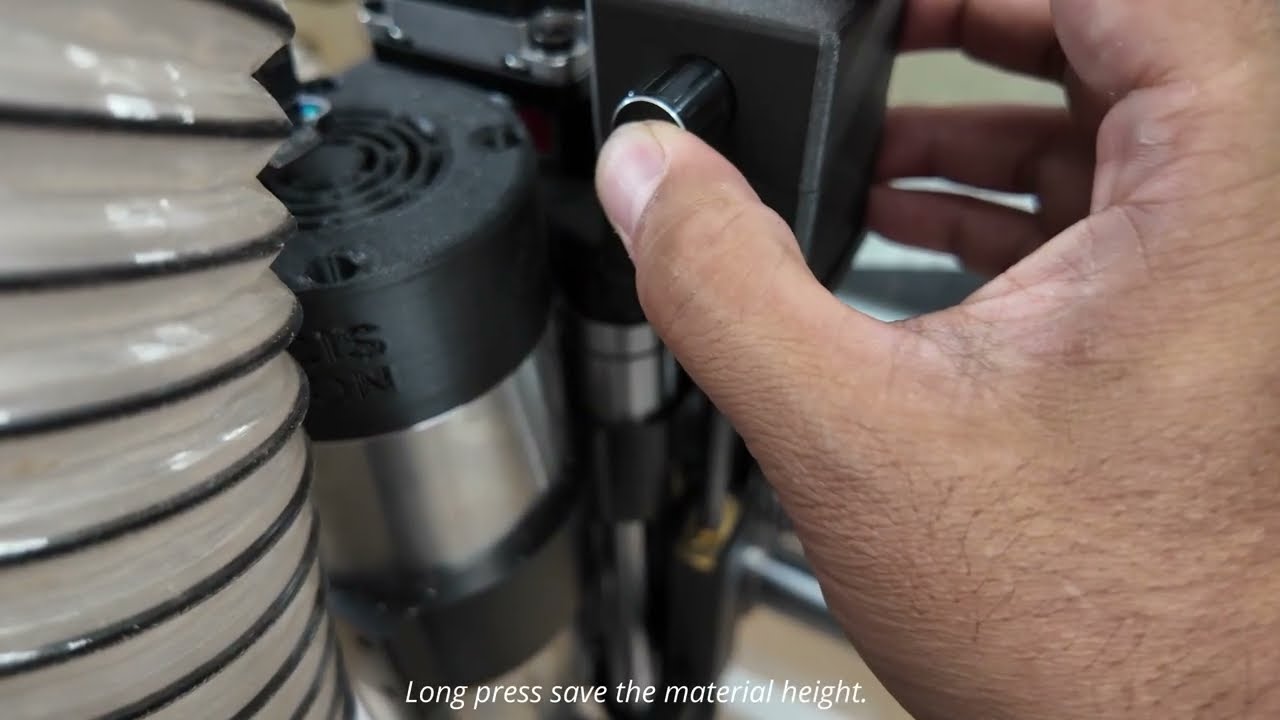

I have one working for 1F. Already have some revision coming for tool less removal and airflow improvement.
Mine doesn’t require any axis control, just simple input signal to retract/expand the dust shoe. I’m using close loop stepper directly attach to motor with seediuno xiao for micro-controller and some encoder.
