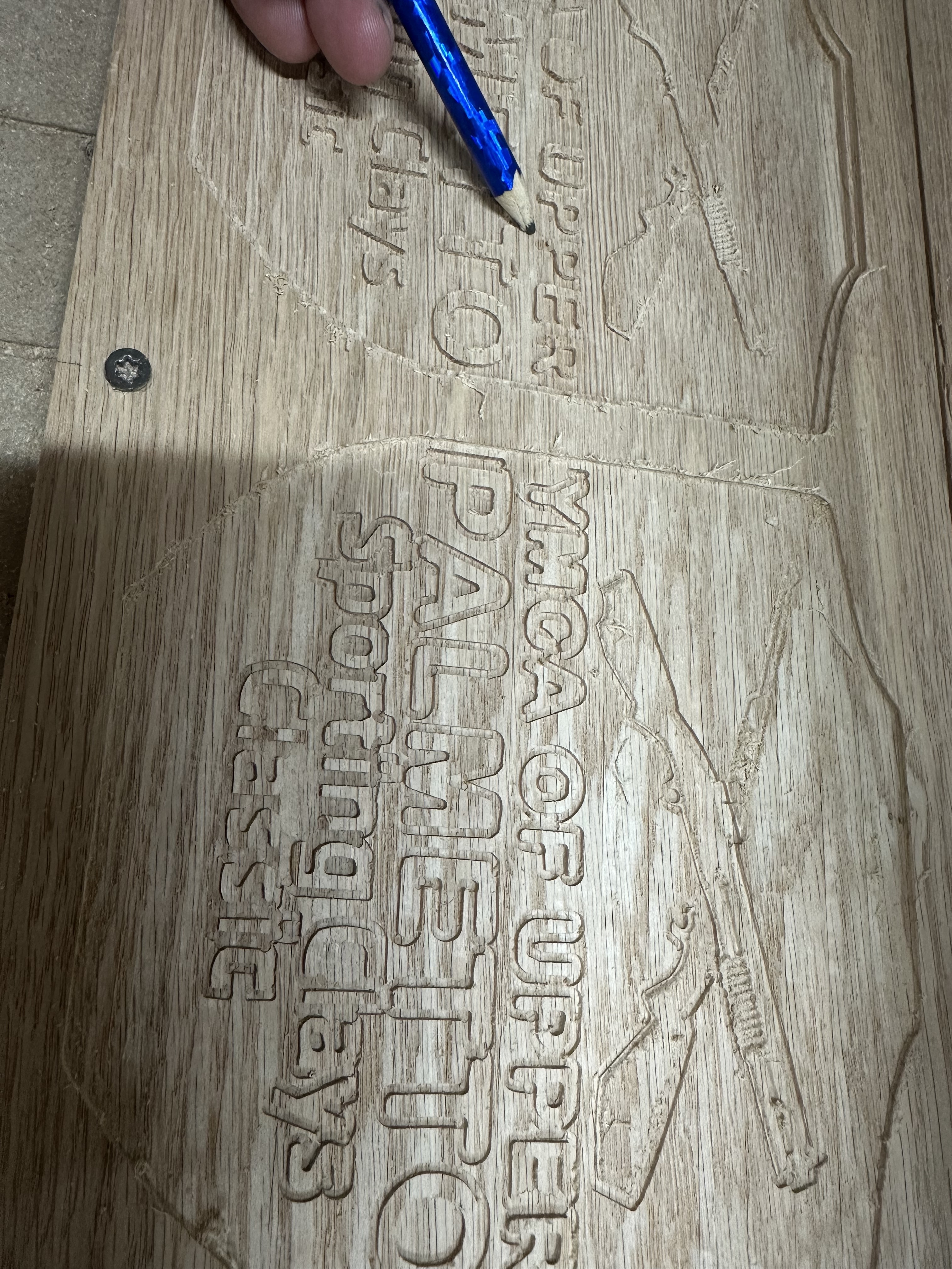

Making these small signs on oak. Designed in Carveco.
These letters are .06” proud. On the left, I did a clearance tool path at .06” and had some chipout. See where pencil is. This was using 1/8” uc and 1/16” dc. Think the 1/8” inch is where the chip out is doing this.
To mitigate, on the right side I did an outline toolpath with 1/16” dc at .03” on each path. Its working very well.
Now to finish the job with my clearance path noted above, how can I prevent some chipout. Was thinking of changing the tolerance from .01” to .02”. I have never messed with these settings. Does that give the toolpath a little buffer to the edges? The tolerance wont go higher than .02” without overlapping vectors.
Thanks!
Lol. After further review, still having some chip out. :man_facepalming: Might rethink this design entirely. Ugh.

Those are some smaaaal letters you are trying to leave out of the wood. Fragile while workimg on them and after that fragile untill it eventually breaks. I don’t like to go there, but if I had to, cause client throws big pileomoney at me and want letters that way.. I might cheat a wee by using either a tapered bit, a 30deg or even a 60deg vbit to give the letters a bit more body going down.
And I would not give the client any warranty on the work either. I warned, you insisted, you problem.
Oak might not be my first choice for detailed work. Do you have the option to try different wood?
Thanks guys. Decided to just vcarve those letters. And was even able to save the material that way too. This was a not for profit job. Was working with left over material I had on hand.
