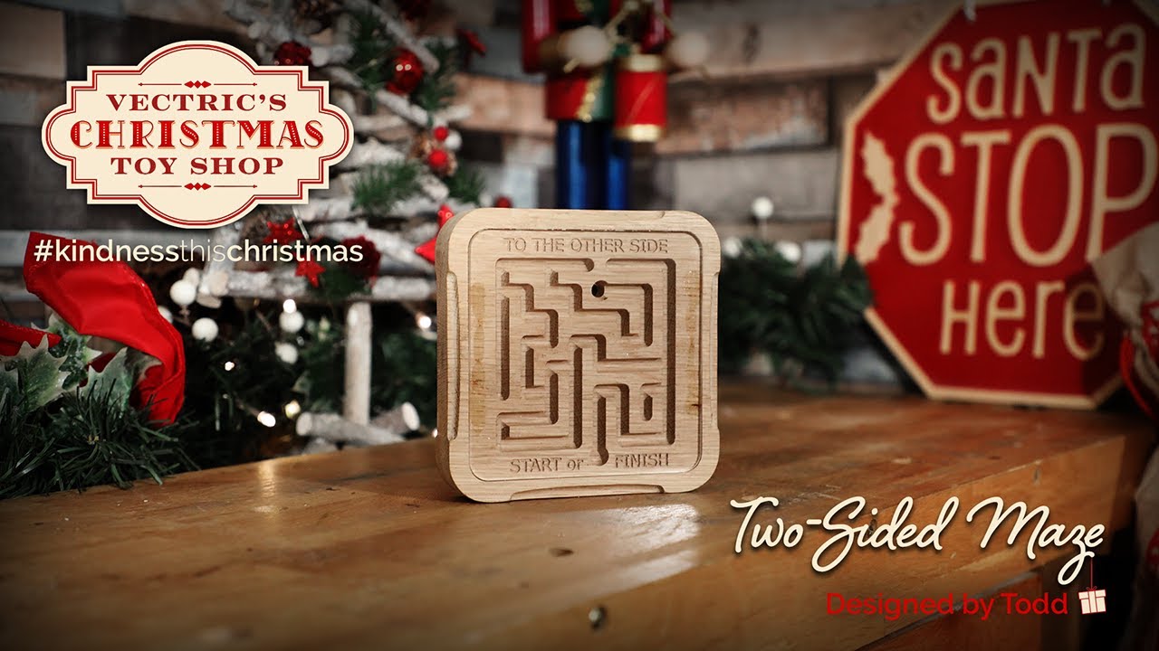

That said, I believe vectric has released a fun marbel thing the other day, including their cad files of it. Maybe something to look into?

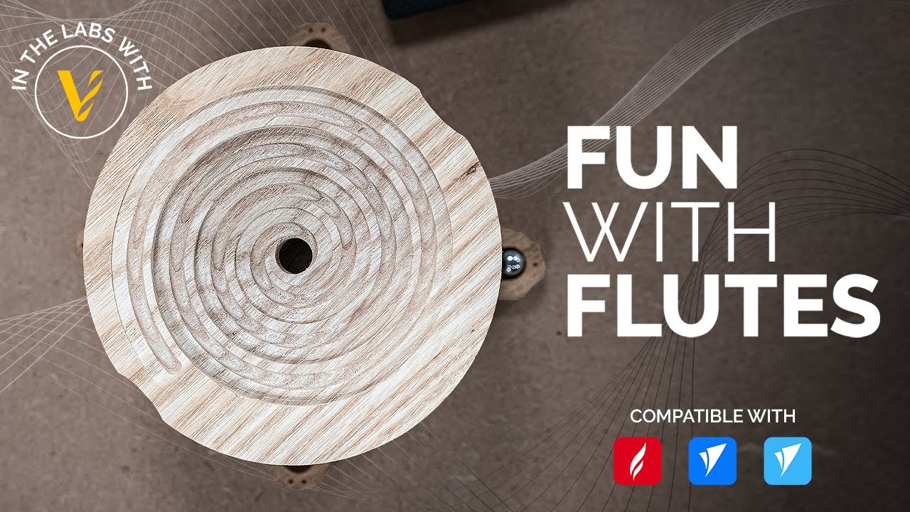

And this one turned up too:
Downside is, you need a vectric account to download the files.
