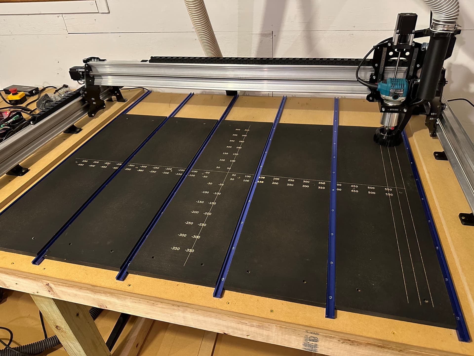

Okay Michael, the day of greatness is upon us. I finally have my table built and my CNC unboxed and starting to piece it together. I have a couple of questions about the spoil board.
  1. You’re clearly a pro at this. It looks like you carved the top of your spoil board first and then cut out the pieces where your t tracks lay between them. How did you calculate and perfectly cut out the distance between each t track? I zoomed in on the images you posted and it’s super precise, I assume you didn’t cut those strips out by hand?
  2. Being new to this, I still understand that lines and symmetry play a large part in getting pieces squared up and cut evenly, but what is the purpose of having them etched into the spoil board? I see many set-ups with the lines carved in, I just haven’t reached the point yet where I understand their usefulness. I would assume you wouldn’t need them if you’re using the touch-plate on the corner of your piece as a starting point.
  3. I plan on running my t tracks vertically as opposed to your horizontal runs. I think I’ll carve out a slot on the far right/left like you did at the front of your table for inserting pieces to cut vertically. I love the Dovetail work/diagram/explanation you started this thread with and want to take full advantage of that.

This is how I made my setup. First I made the table, 2x4 construction as straight and square as I could. Which for me meant building it on the concrete floor and hoping that was good enough. My mill is on the left side of my table so when I figured out where the front left foot should be, I used a straight edge and square to mark an L. I attached the left front in the corner of the L and the rest of the left feet touching the line. Then with the X rail forward I mounted the right front touching the front line and as I moved the X rail back I attached each remaining right foot.
If I had to do it over I would most likely try the method where you mount the mill to strips with a slot and bolts for adjustment. Even when drilling the holes for mount screws first it was easy to mess up the placement by over tightening an angled screw. Not sure if the MK2 screws go straight down or not but some of the MK1 ones are angled.
After mounting the mill I jogged to the 4 corners and marked the bit center for each corner. The t tracks came in packages of 4 and I didn’t think 4 was enough so I bought 8 t tracks. With the number of tracks, strips, and the area to cover known it wasn’t too hard to figure out the spacing. The strips ended up being being about 4", they aren’t exact, I ripped them on a table saw. I marked lines for the t tracks and installed them first. With t tracks mounted I was able to clamp the strips so I could mill the counter sunk screw holes for attaching the strips. I made one program and ran it in the same place 7 times switching out the strips each time.
The spoil board I made actually covers more area than the center of the bit can reach. That’s okay as long as you can reach the edge of the spoil board with your surfacing bit. You want to be able to surface the whole top of the spoil board in case a work piece needs to extend off from it, for pass through work etc.
The grid was done last with my laser. Since it was done last with everything mounted it is square to the mill. I needed to make a mount so I could put the laser in the center of the router mount so the laser could reach everywhere. I took this opportunity to cut the cable on my router and put in some connectors, one each way so I can’t plug it in backwards. Then I put connectors on a salvaged cord so I can use the palm router off from the mill if I need to.
The main use for the grid lines is just to place work pieces square to the mill easily. Before I had the lines I would put a board touching the bit at the front and then while holding the front, jog the machine back and move the board to touching the bit, hoping I didn’t move the front etc. Now I just take the straightest edge and place it touching the line and clamp away. The touch plate will find a corner but it won’t make sure you mounted the stock material square if your trying to use all of it. Being mounted super square may not matter if your not using the edge of the material. But wood is expensive now a days and I try my best to use as much of it as I can.
As far as the direction of the t tracks goes, I think it’s just user preference. I knew I was building an enclosure, primarily to keep the laser fumes contained/exhausted, and that I would not have access from the sides so that dictated the t track direction for me.

Hey Michael, I’m back for more. I was wondering if you could help me with the tool path for a 60 degree 1/4 V-bit to make this spoil board. I knew the lines wouldn’t show up very well on plain MDF so I looked online for inspiration and saw where someone had painted their spoil board black and then used a V-Bit to cut in 0.1 - 0.2 mm and create clearly visible lines. I painted my spoil board black and I’m going to attempt to do the same thing. The VCarve file you sent over is only allowing me to run it in a 2D Profile Toolpath because it’s saying there are ā€œOpen Vectorsā€. If I use the V-Bit in the 2D Profile Toolpath is there anything I should look out for in terms of setting my start depth/cut depth, starting point, (do I use the AutoZero Touch Plate?). After squaring, tramming, painting, etc I would hate to have come this far to drive my bit straight through the bottom of my table and start over.

You should be fine to use the profile tool path with a v-bit. The v-carve tool path is to clear out an area inside of closed vectors. It’s like a pocket tool path with angled sides.
You should use the profile tool path, on the line, with the z set to top of material in V-Carve. Use small cut depth to start because you can always stop the program and go a little deeper if needed but it’s hard to go the other way if you cut too deep, ā€œHey Joe!, I cut this board 3 times and it’s still too shortā€.

Michael it looks great!.. well, halfway great. Things were going fantastic until about halfway through the job. That’s when I noticed the machine was just slightly grinding on the left Y-axis rail when it was moving X&Y simultaneously, but it was within the bounds of acceptable from what I’ve researched and seen online. Then I really saw it; I noticed that the left Y-axis rod was spinning freely and the anti-backlash nut was completely loose. I paused the job, tightened the nut down by hand to a firm but not ā€œdeath-gripā€ tightness. Also checked the other backlash nuts and everything seemed good. I clicked ā€œResume Jobā€ and the machine ground to a complete halt. Paused the job again, loosened backlash nut a little bit on the left Y-axis, I confirmed it was around the same tension as all the other backlash nuts. When I pressed ā€œResume Jobā€ this time, $h!t hit the fan… the Y-axis rails quickly became misaligned, there was some serious griding, the left side Y-axis jammed up, bounced, and I heard a small ā€œpop/snapā€.
I hand cranked the Y-axis rails back into alignment. They run in alignment under the ā€œPreciseā€ jogging, but they jump out of alignment if I speed it up to ā€œNormalā€ or ā€œRapidā€. Clearly I need to deconstruct this little fella and see what happened, but I’m guessing I broke my anti-backlash nut?

That’s too bad that it messed up. I have a couple of tips that may help you.
First, if your machine’s Y rails are even you can move the machine all the way to the back with the motors and then either disable soft limits or just move the rest of the way back by hand. Moving both sides back until they hit the stops should put you back in alignment.
Second, I’ll share how I adjust the backlash blocks. I loosen the adjusting bolt until I can feel, and hear if it’s quiet, the play in the block. Do this by grabbing the plate that the backlash block is attached to and try to wiggle it back and forth. Now that you can feel the play tighten the adjusting bolt until that play goes away. You can give it a smidge more, like 1/16 turn, after the play is gone but not much more or it will cause too much resistance and bind.
