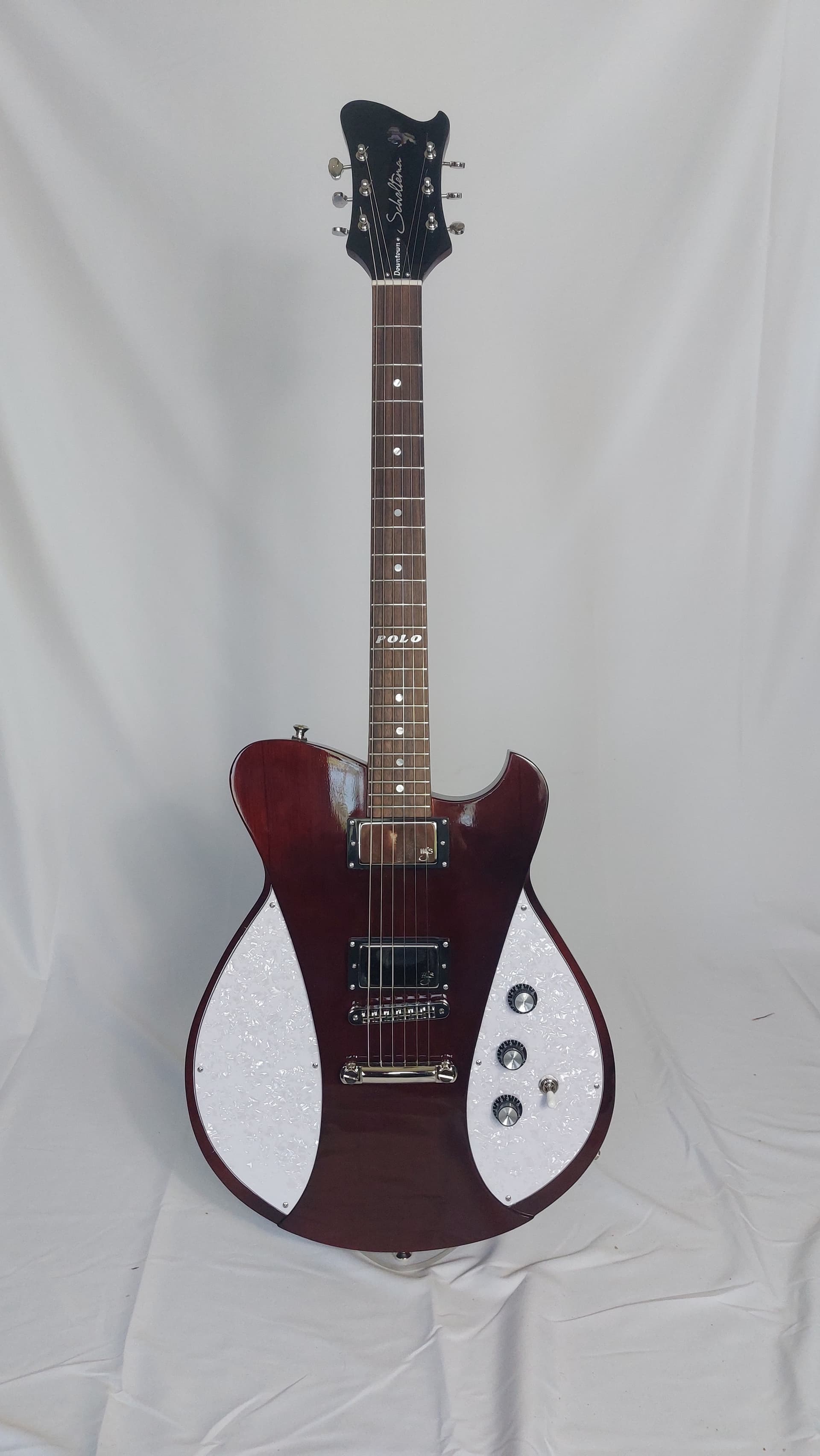

My first cnc run. Inlay for a customers guitar!
My customer wanted to get the name of their pony “POLO” on the guitar somehow, I suggested the 12th fret marker. knew it was ok because its only 4 letters so I could beef them up.
I used a 1mm bit, reduced speed to 20% SINCE MOP is very hard and away I went.Of course I’ll need to cut the pockets with my Dremel but that’s ok.

Here’s the final shot. So very happy with the results.
I also began the faceplate for this custom build. A piece of ebony. I used a 1mm bit, travel was 100% with no issues.
