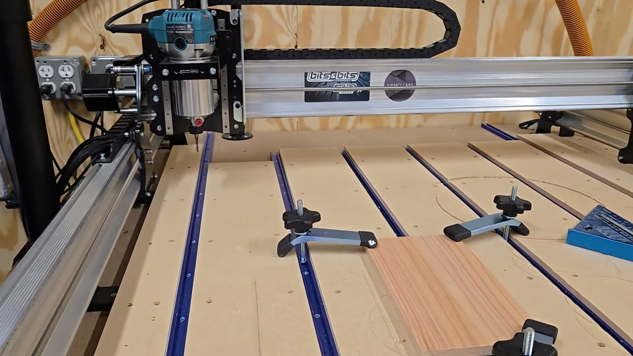

after setting 0 home on my work piece and running the outline step it doesn’t return to the same location it off quite a bit. i have tried this on a couple different files with the same results
Does gSender indicate that it is at [X 0, Y 0] at the end of the outline? I guess my question is whether the zero position actually changed or the machine just didn’t end up where you expected? I have never used the outline feature but I see no reason that it should necessarily end at the same position that it started at.
The true test would be to set home and then run then outline and then use the ‘Go to’ buttons to return to zero. If that is still in the right place you are good to go.
I’d agree with @_Michael, by the way great name @rpdjr59 :smiley:
If it’s not going back to where it started, you might want to look at bumping down your velocity and acceleration values in the Firmware settings. There have now been enough reports of this issue that we’re also now shipping an updated firmware with slightly lower default values for velocity and acceleration to address the occasional instances that have popped up from this, the new version is available for download here:
I thought of something else but it’s hard to say without a value for ‘quite a bit’. If there is play anywhere in the drive train the position of the bit can change by the amount of play based on the direction of the last move.
For example, lets just assume X moves with some play in the anti backlash block on the X axis. If the machine was moved to the right, zero set, then moved farther to the right and returned to zero by a move to the left. The result of this sequence would be that the bit is off by the amount of play. I would expect this value to be small but small and ‘quite a bit’ are relative values so it’s something to consider.
I check my drive train for play by grabbing a part that moves and trying to wiggle it back in forth in the directions it moves. If there is play you should be able to feel and hear it if it’s quiet. I try to move the X carriage left and right to check the X axis. For the Y I try to move the X gantry plates at either end of the X gantry forward and back one at a time.
You can get play from anything that’s loose but anti backlash blocks, wheels, and the nut that tensions the lead screws are probably the most common culprits.
Just some food for thought, good luck resolving your issue.
thanks for the suggestion i have checked for any play by pushing on the x and y arises i also loosened my backlash bolts they seamed to be a little tight I’m going to upload some links to some videos i made of how it’s running and the log from the attempt tonight.

Hey rpdj,
Watched the first vid at the ithinkigotitlink and I can hear your machine stall two times pretty much on the same spot in the outline cycle.
I think that if you tune down the xy- speeds a bit as sugested above, you are prolly able to run more stable outlines. (And jobs)
The updated file is it 5.0.11? My SLB is ruining 5.0.5b now.m
@rpdjr59 According to the Sienci site, the latest firmware for the SLB is 5.0.5b. You are confusing that with the latest file for the SLB-EXT, which is the AltMill controller. That controller’s latest firmware is 5.0.11.
OK 5.0.5b is correct. Make sure you send the command “$rst=$” in the console then turn off the board with the power switch at the back and turn it back on again. That should revert all your settings correctly. Then you can try again and see if you get the movement you expect :+1:
EDIT: I’ll move all your links back into here since it’s quite disorganized - just to help you with getting help
thanks for the help with those links my first time doing that. so I entered the command and powered off and on it did set the settings and I tried to run a outline and the same thing happened again. I went into the firmware and lowered the acceleration this time I went to 500mm/sec on the X<Y, and A, then I homed and setting up to do a cut with the probe to set my origin pick the same file and did a outline and it ran well and returned to the origin. I did that twice. So I went beck into the firmware and raised it to 700mm/sec with the same results. tried one more time, setting the acceleration to 650mm/sec and it seam to be fine smooth and returned to my origin point. do you think this is ok? or am I going to have a problem? I also copyed the log for these set I did tonight if you would like to see them.
@rpdjr59 if you have to set the values that low, there might be some other mechanical issue with your machine. For instance:
  • v-wheels too tight
  • anti-backlash nuts too tight
  • anti-backlash nuts misaligned
If you reduced the settings and it seemed to work, then you can probably get away with doing it as the easiest fix. If I were you, I’d use the lower values since if you try to raise them up too high then you’ll risk your machine losing position while cutting (since forces are higher while cutting). In the long run though I’d suggest taking a look at the mechanics of your machine. A good test is to see if you can turn the lead screws with your fingers, and if not then look through the different components until it’s moving more smoothly again. I only say this because I’ve never heard of someone having to put their settings that low.
How that all makes sense, but if you need me to elaborate more, myself and other on the Forum are quite experience with this sort of thing
thanks for the info I have look at the machine and I can move the lead screws by hand with out much trouble, also I loosened the anti backlash bolts and tightened them but not as tight as they were that helped the sound of the machine when running. I will do some cutting and see if things change. I want to thank everyone for there help.
