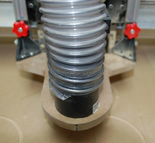

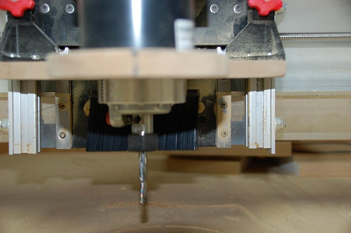

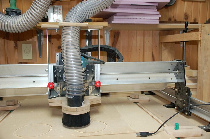

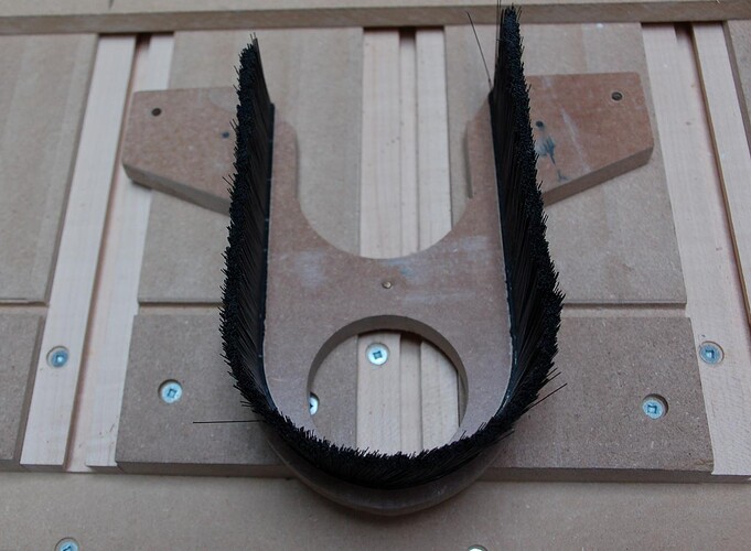

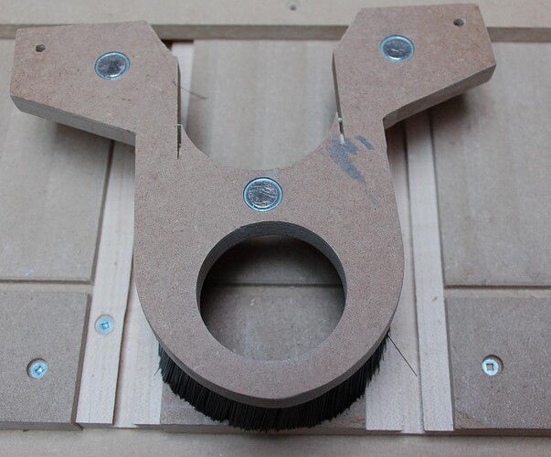

In the meantime, here are pics of my set up.
Captions as follows:
001 shows the overall setup. There is a bungee strung from the ceiling holding up the 2.5" hose. The flex hose goes to a 4" solid PVC pipe to which I can connect another flex from my dust collector.
002 shows the top of the bottom/brush part of the shoe. The three magnets hold it very firmly. You can see that I was still playing with the design after I cut this out on the Mill, as judged by the rough cut out. I’ve since modified the vcarve file to match this design.
003 shows the shoe and the hose connection. I just used the Sienci brackets to connect it to the LongMill.
004 is a bad pic of the underside of the top part of the shoe. You can barely see that the back part of the brush is attached to the top of the shoe. When the bottom is slid into place on the magnets, the brush on the top meets the part on the bottom and completes the ā€œcircleā€ around the router.
005 shows the underside of the bottom part of the shoe. The cut out for the router doesn’t look as bad here as in pic 002.
Grant,
This is great. I need to give my situation some more thought but I’m thinking you have pretty much what I was looking for right here. Thank you for sharing it.
-Jeff
