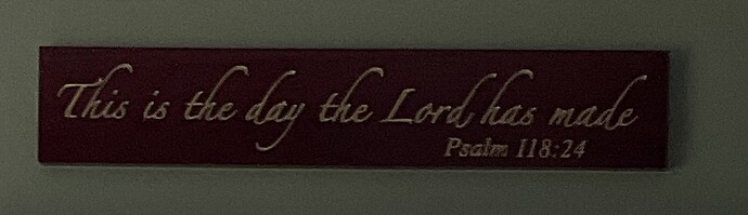

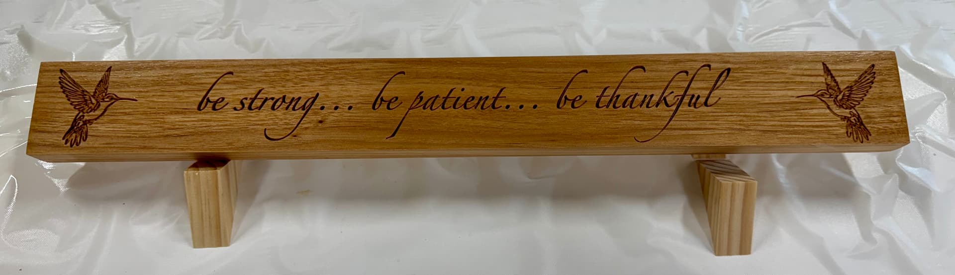

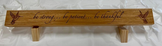

Trying to ease back into using my LongMill, I made these two pieces. The one in hickory was a custom piece for a lady I know. It used her font, and when I carved it, I didn’t need to paint the words. The shadow showed the words well. She liked it so well she sent a picture of it on her wall in the den She provided me with the dimensions.

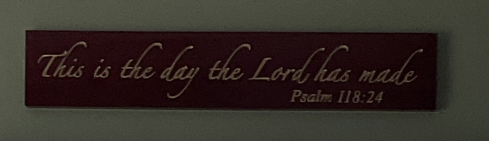

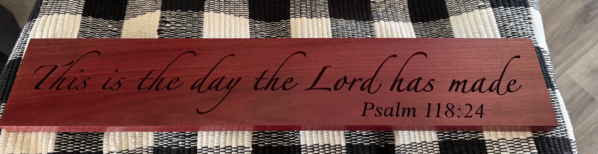

The second one was for my bride. We had that verse above our patio door and it was stenciled on the wall. We painted over it and I carved it out of Purple Heart. Being high on the wall, I had to paint the words. I finished it with spar polyurethane to retain the color. My sweetie loves it. I apologize for the picture quality.
Both were carved with a 30 degree V bit. The font is Zapfino. I found it and imported it to my computer. Restarted VCarve Pro and was good to go.

The bit I used is a true 30 degree V bit from @IDCWoodcraft. It was the first time I ever used the bit. It carved very clean and quite deep into the piece. What was cool is the shadow of the letters actually provided decent contrast. Here is my brides plaque without paint. If it would have been hung at eye level, I wouldn’t have had to add color to the project.
