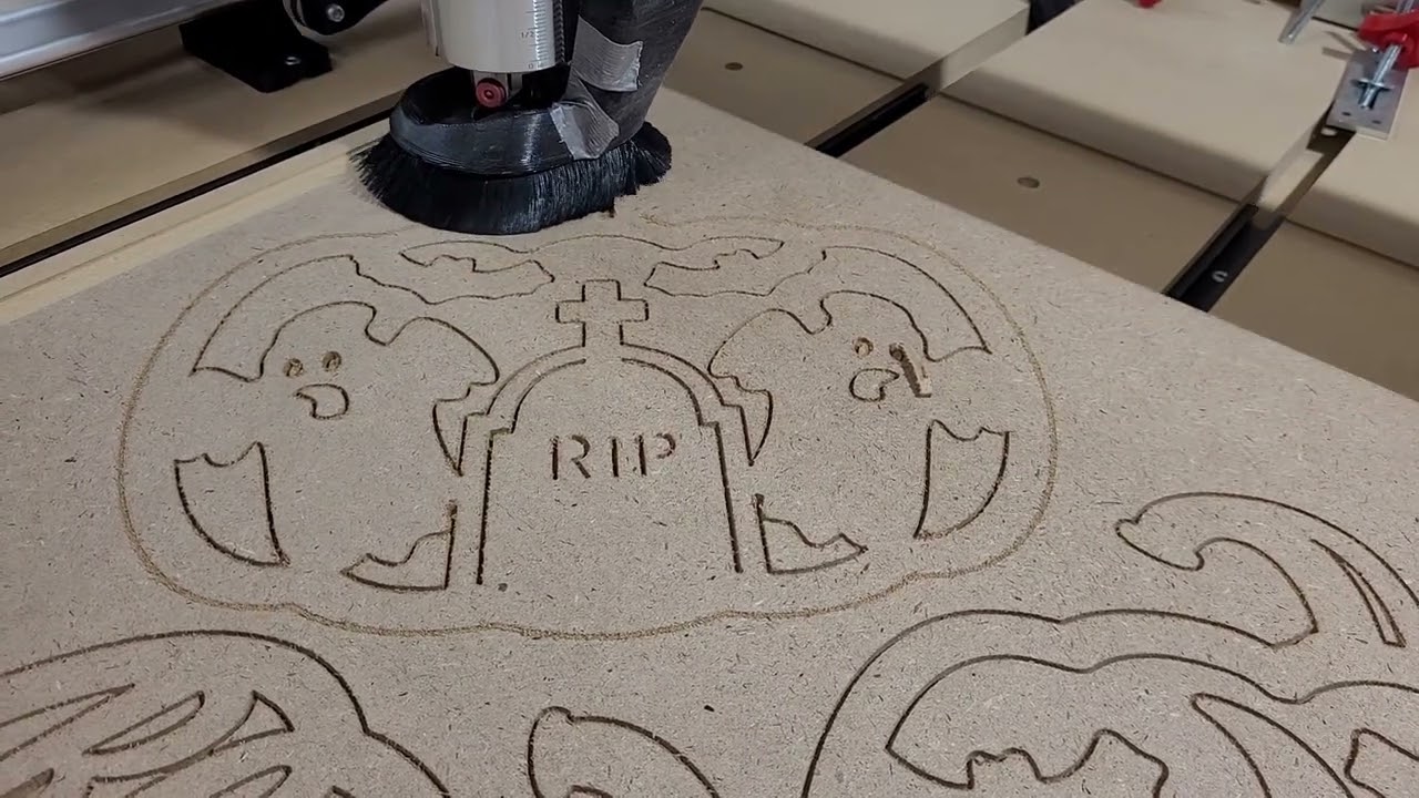

Hello fellow Siencier,
Here’s a video of my Longmill MK2 cutting some MDF pumpkins out of 1/4" MDF with a 1/16" down cut end mill.
Pass depth: 0.161 inches
Spindle speed: About 19500, between 3-4 on the makita router.
Feed rate: 1080 mm/min
Watch till the end to hear the bit break.
Thank you to TheLouisianaHobbyGuy for the free design files.

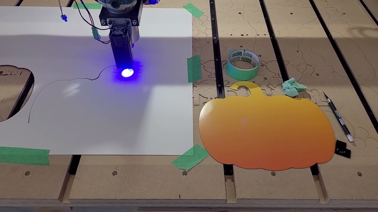

Hi again,
In this video I’m cutting pumpkins out of cardstock with my Laserbeam on the Longmill MK2 These will be used for the background of the MDF pumpkins from my previous video.
Lens: G2
Pass: 1
Power: 100%
Speed: 5 mm/sec
