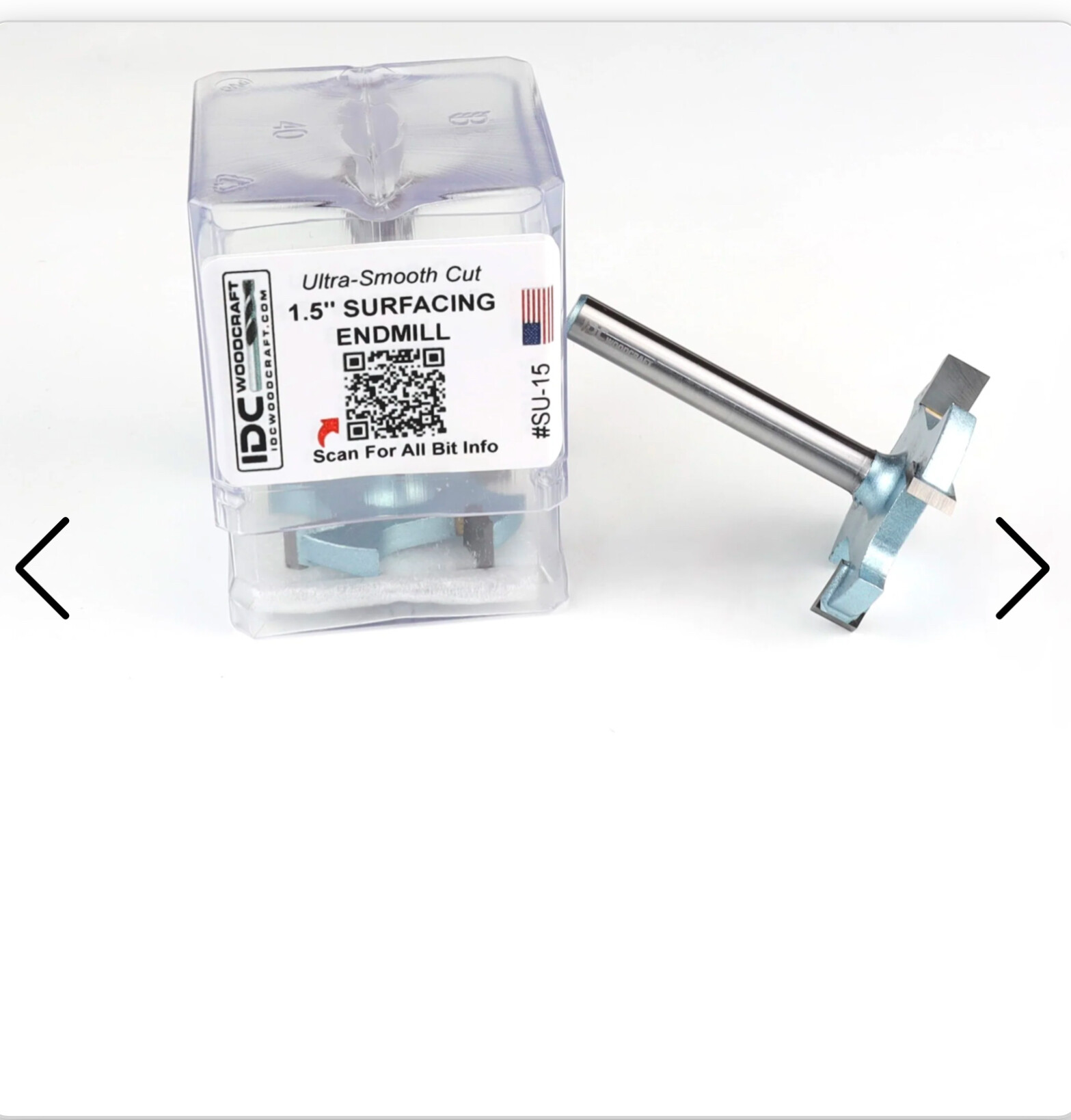

Or use a normal surfacing bit. Where did you find that beast anyway!?
@Spamming_Eddie Hello!
I got this from @IDCWoodcraft. It is a beast of a bit, but does an amazing job. Messy? Absolutely! Hence my post. This beast out performs my miter box saw for mess making, easily!

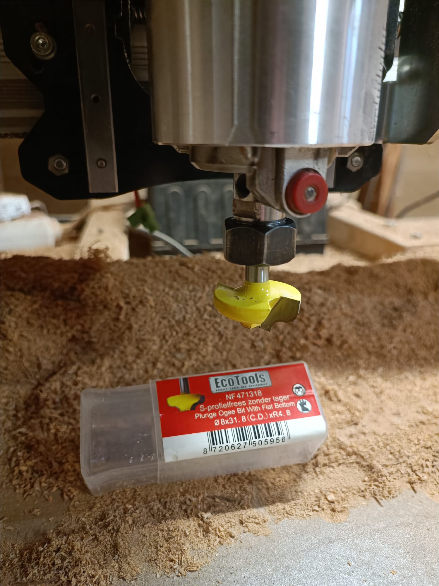

Daaaim Jake, I just converted to metric, just to see if I could top that bit. My largest bit I run on the killer is a 32mm S-Profile with a 22mm flat bottom. It has a 8mm shaft. One of the perks of an European makita is having a 6 and 8mm (0.315 inch) collet. The downside is getting only metric collets, so the 1/4 and 1/8 collet I had to import. That said, there are some local bit sellers that have awesome 8mm shaft bits that I cannot find overseas. Finding inchling bits is problematic so I am slowly building a metric bit library besides the Inchy ones.
Another problem is that besides the vectric toolbase, there isn’t much ready to use feeds’n’speeds library and it took me a while to be confident enough to dial in such a large bit with its weird form. It too is a beast in its own right.
Anyhow, I get why you want to be able to use the dust boot. I have found it to be impractical. Especialy with the smaller projects, like desk signs. And since I am not near the machine throwing dust, I ditched it from my workflow. These kind of projects don’t allow much space. It’s often difficult enough to keep the bit from hitting clamps, let llone needing to design in room for the dust boot. So it went, pretty early in my journey.
A larger surfacing bit, though… That would be nice. Let’s see if I can get an 8mm shaft one somewhere.
