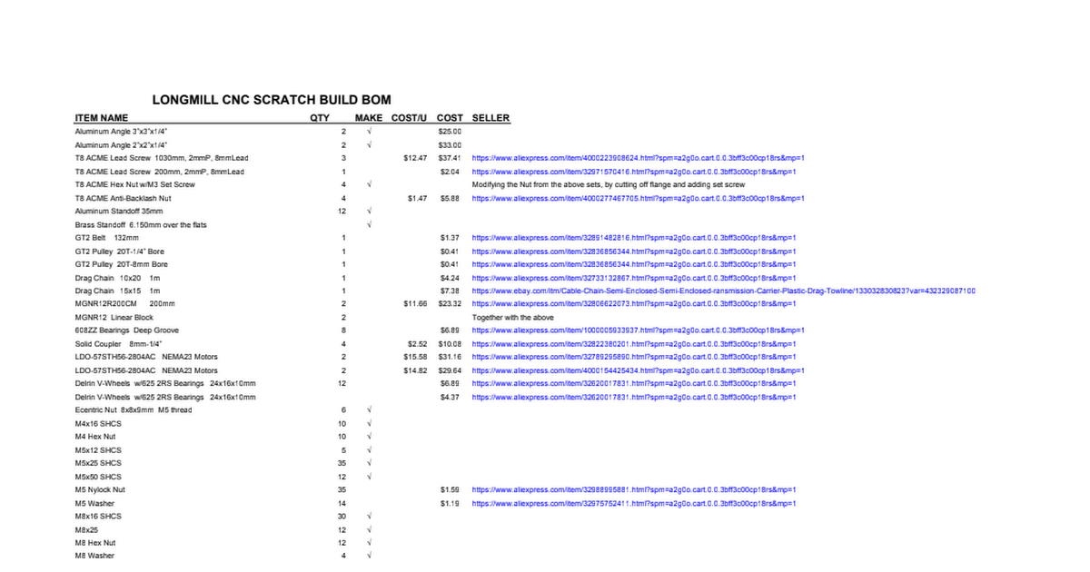

Ok, I have my hardware BOM together.
Check it out and see if I have something missing.
Please note, that the spindle and controller are not in the list. We’ll discuss those separately. Stand offs and the eccentric nuts I’ll make myself. I can’t find the long style of eccentric nuts that Scienci designed. Only the short stubby kind, are available in China. In my opinion the long style are worth it, so I’ll turn them up, out of some hex stock I found.
I’m aware that not all the sourced parts may be of the greatest quality, but I’m prepared to modify if needed.
I also noticed that some ACME nuts (stoppers) are only bushings with a set screw. With the T8 leadscrews that I sourced, are included flanged T8 nuts. I’ll part these down and tap them with set screws to make the stop collars we need.
And don’t forget filament costs.
Hansi

I’m going to try to use a 1000mm T8 lead screw. The design uses 1030mm long, but when sourcing that length as an OpenSource build you have to look for 1010mm (very rare) or more common 1200mm. These however get to be pretty pricey.

Alrighty… Pulled the trigger on that BOM.
We’ll see how long it takes for all those goodies to come floating in.
In the meantime, got some parts to make :grin:
Some of the laser cut parts are in que for wire cutting :+1:
Still trying to find a per/meter source for angle extrusion. So far have a quote per 6m lengths.
