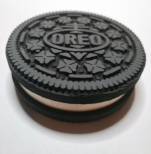

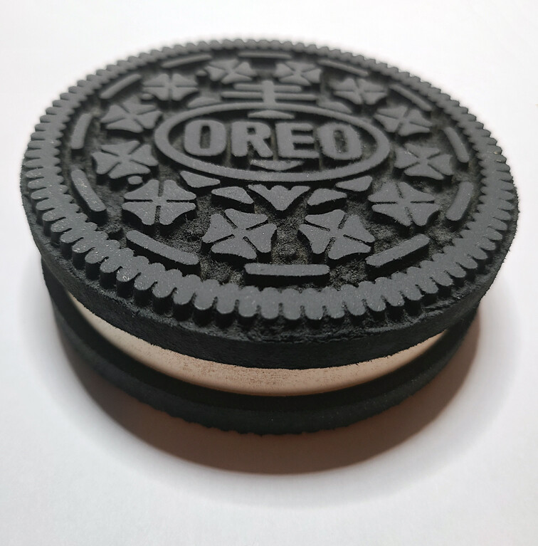

A friend’s daughter is an Oreo lover and wears stud earrings. He asked for a small birthday gift where she can store a few pairs.
This is only 5" in diameter. The material is 1/2" MDF for the cookie and 5/8" MDF for the icing.
I painted all surfaces with water-borne spray. The inside is flocked.
I used a 1/8" downcut for the clearance pass on the cookies and for the inside and outside cuts on the icing. I used a .03" TBN for the detail pass on the cookies.
I did this as a two-sided job in VCarvePro so that the inside of both cookies fits into the icing. The bottom cookie is glued into the icing.
It goes without saying that this is not my original idea. It was fun little project.
