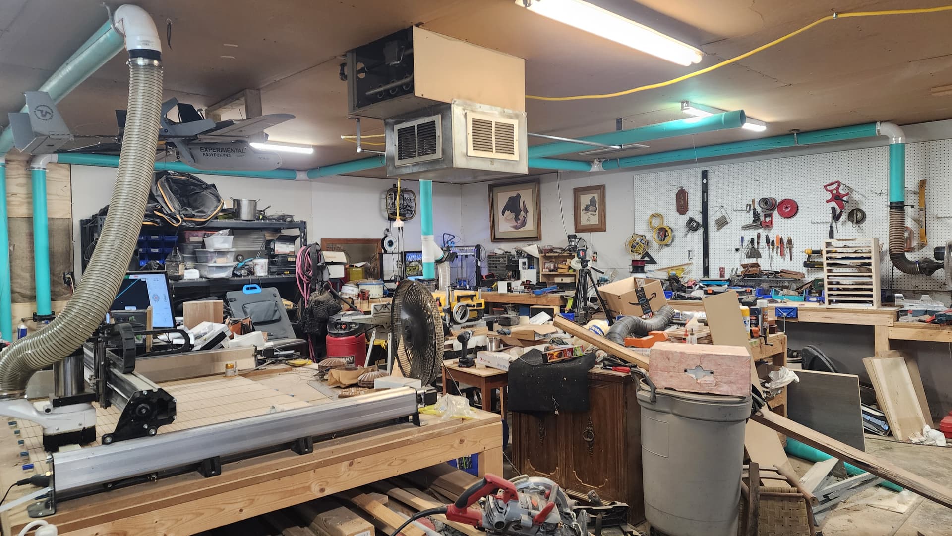

One issue that you may wish to avoid is the corners; they should ideally be slow sweeps. Instead of hard 90 degree turns, the usual idea is to have two 45 degree elbows. The same goes for your T-joints; try laying them out so that the direction of the airflow creates as little resistance as possible.
Aside from those issues (actually, they’re pretty well the same thing…), good going!
Marty from Kingston, ON :canada:
Thanks for the input.
The correct term for them would be “long sweep 90’s and sanitary tee’s.” I only know this because I was a really high end custom home builder for 42 plus years.
It wasn’t very high on my list of things to do when I put the dust collection pipes together. Those fittings are WAY more expensive than the fitting you see in the pictures. All of my runs are pretty short and not many fittings on each run. (Only one run has 4 fittings, the rest are 3 or less) The one with 4 fitting is only 18 feet long.
But it is good practice to use those fittings, for sure.

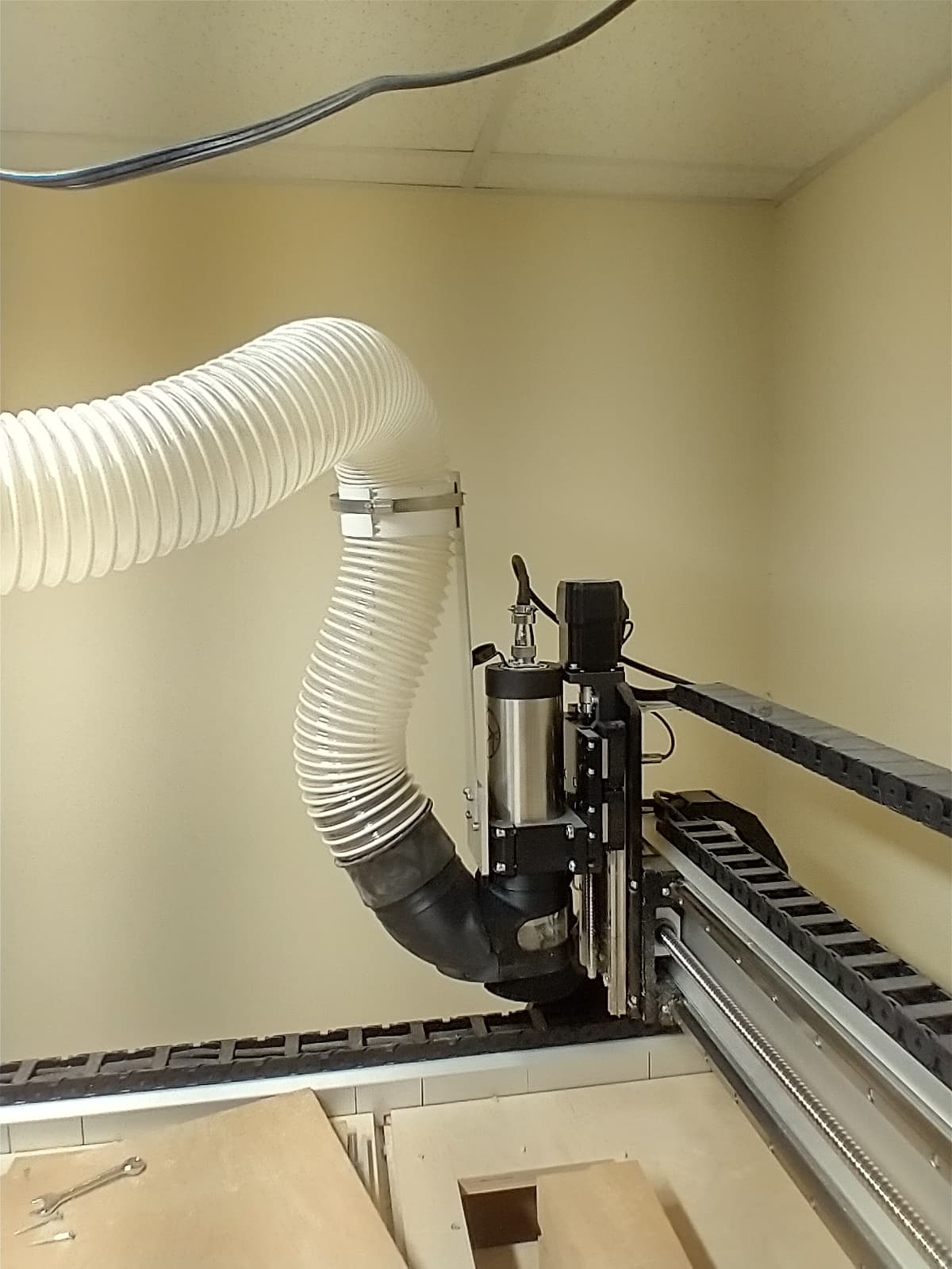

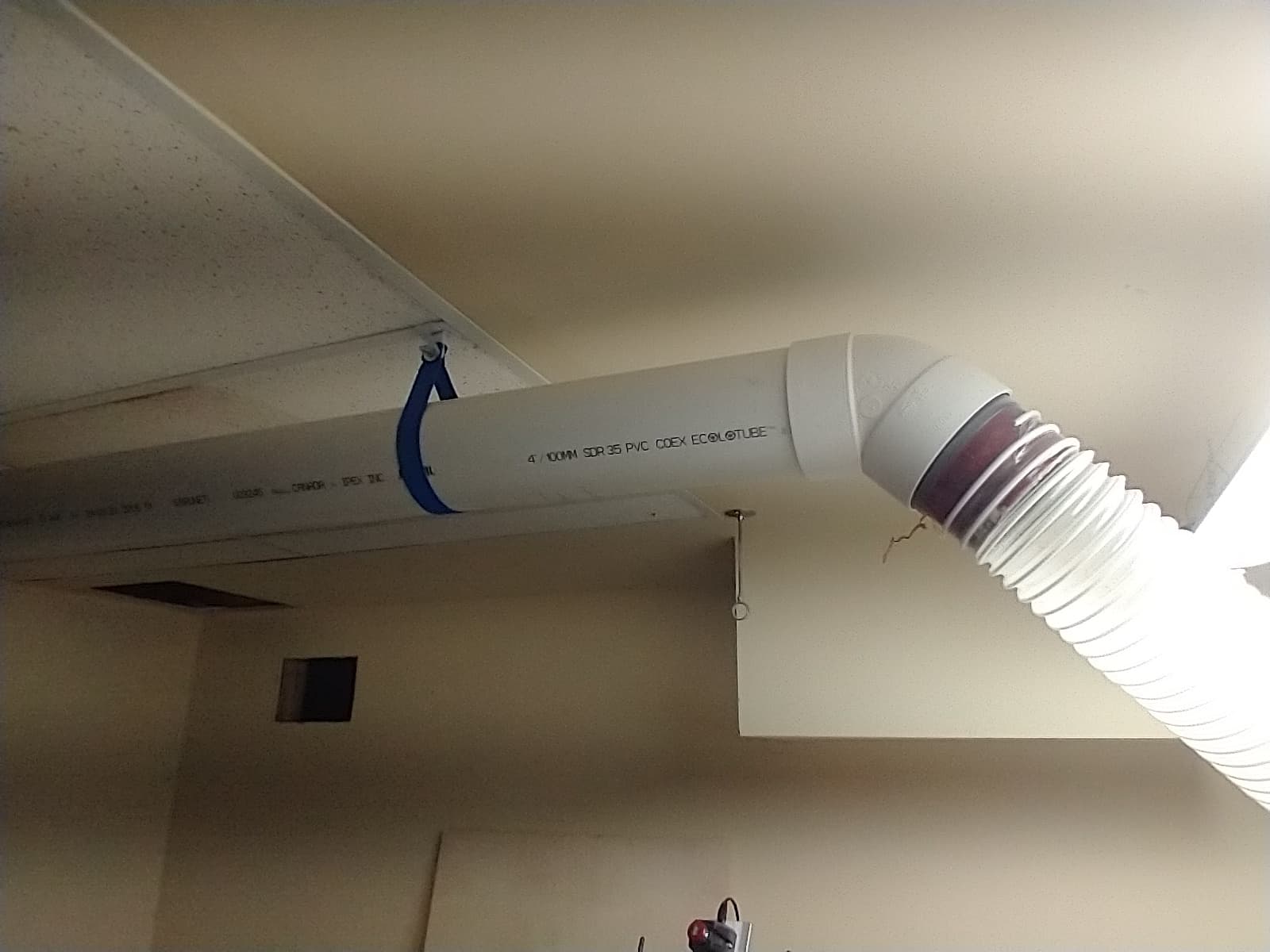

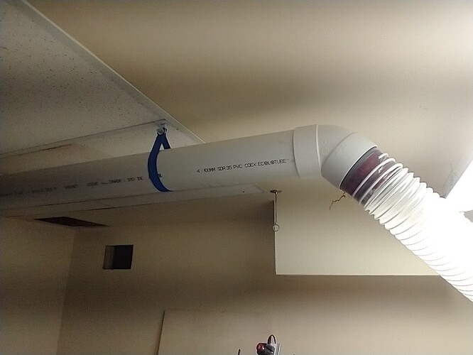

I struggled with several methods of 4" hose placement for my Altmill before coming up with a simple setup that works. Because I have low ceilings, it was difficult to get the hose high enough to clear the spindle as it moved around. I tried bungee cords, pivot arms, and a few other contraptions that didn’t work so well.
What finally did work is simply adding an extension arm to the spindle so that the hose can move freely to either side. The connection at the ceiling is about 12" in from the front of the Altmill. With this method, it is able to reach the back without issue. And when at the front, the hose simply plops from one side to the next as the spindle moves along the x-axis. Hose is not too long and not too short. Goldilocks length to prevent drooping or too much extension was achieved with a bit of trial and error.
