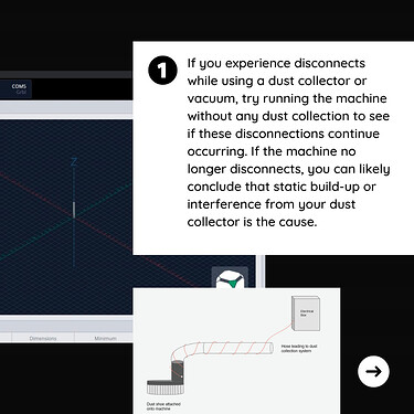

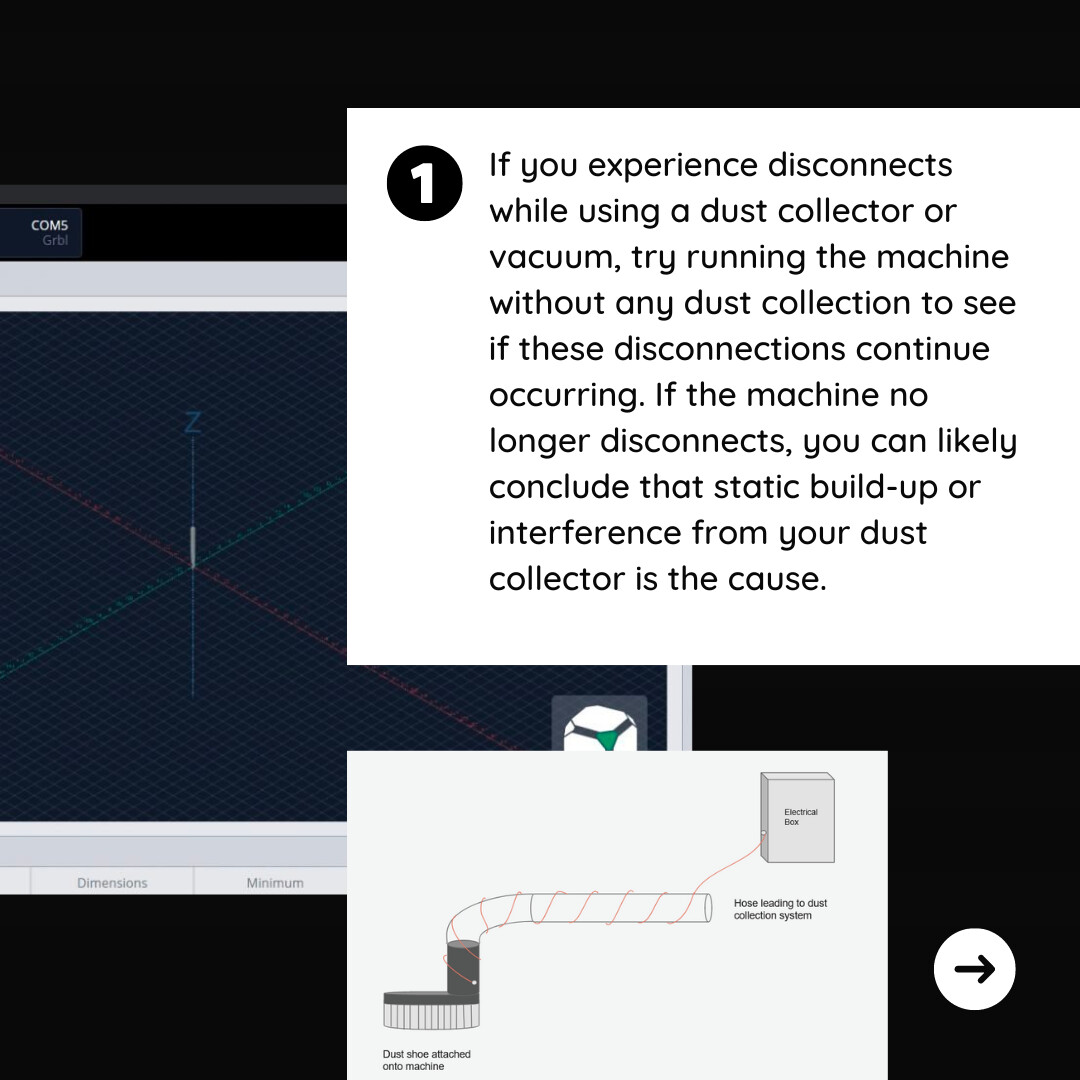

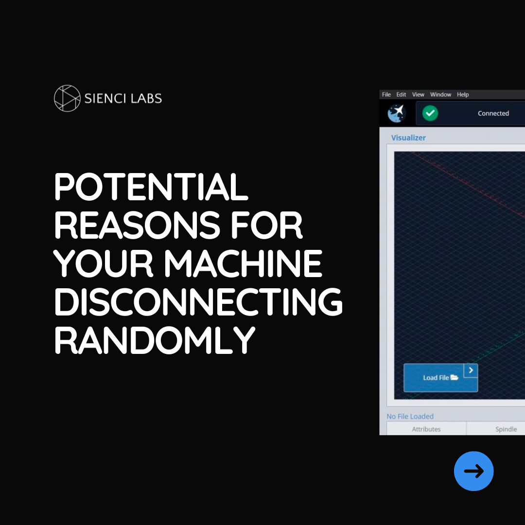

Having issues with your machine disconnecting randomly? Here are some of the causes for it.
For more information, visit our resources page here:

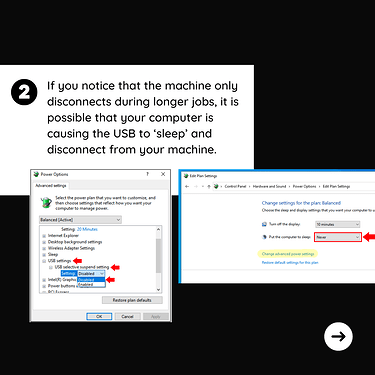

You will/may need different instructions for Windows 7, 11 (and maybe 10).
In Windows 11 “Settings”
Under “Bluetooth & devices” turn off “USB battery saver”
Under “System” “Screen and sleep” select
“Never” for both “… put my device to sleep”
Under “System” “Power mode” select “Best performance”
