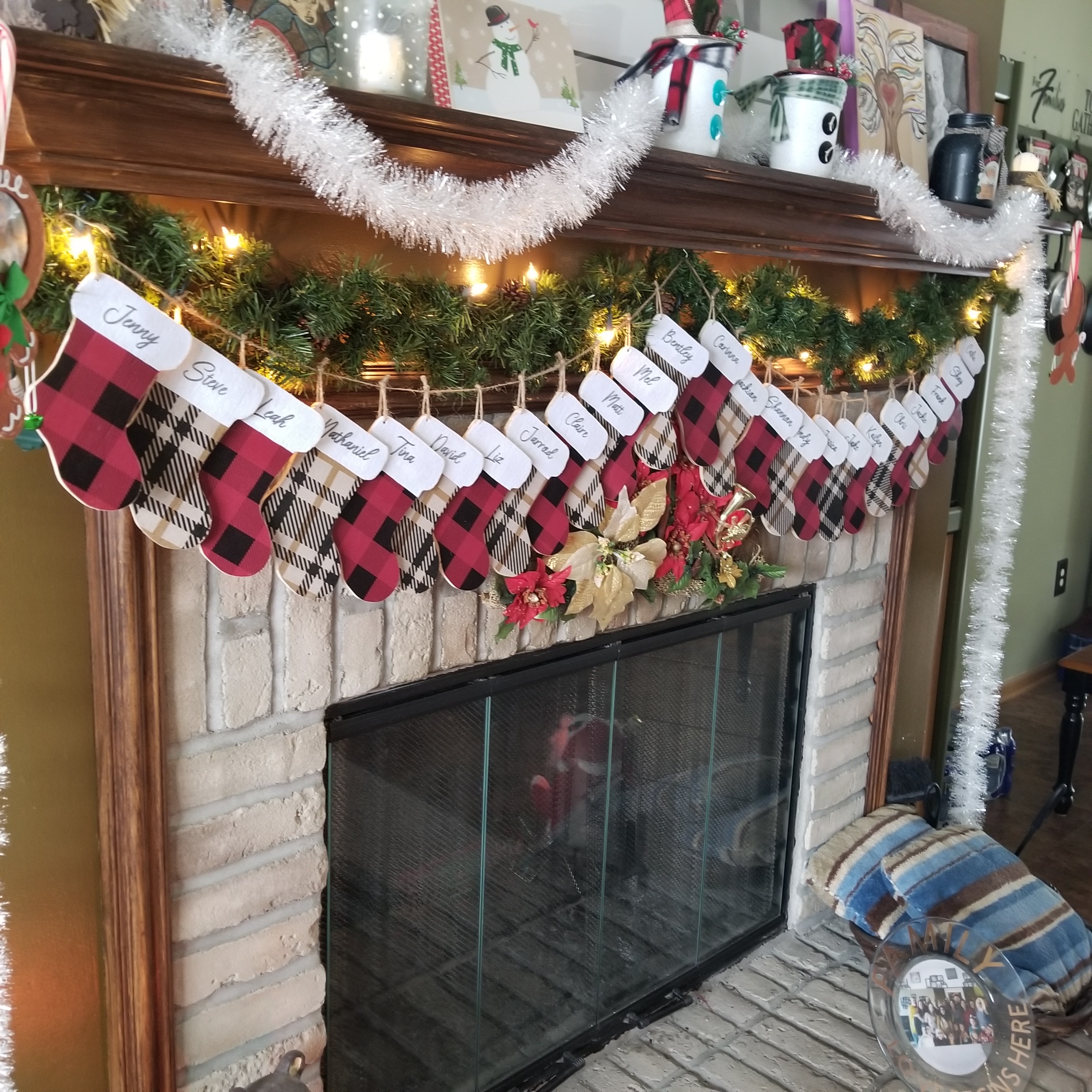

One more for the good of the whole…Christmas stockings (32 of them). This was another simple carve with LM, then wrapping paper and fabric decoupaged onto the cutout. Lettering was Desktop Laser Printer printed on the fabric using freezer paper as a backing. 5mm 2’x4’ sanded plywood from Home Depot, profile cut with 1/8" compression bit. Designed in Aspire 9.5 UGS as the sender. Twine hanging loop in corner.
