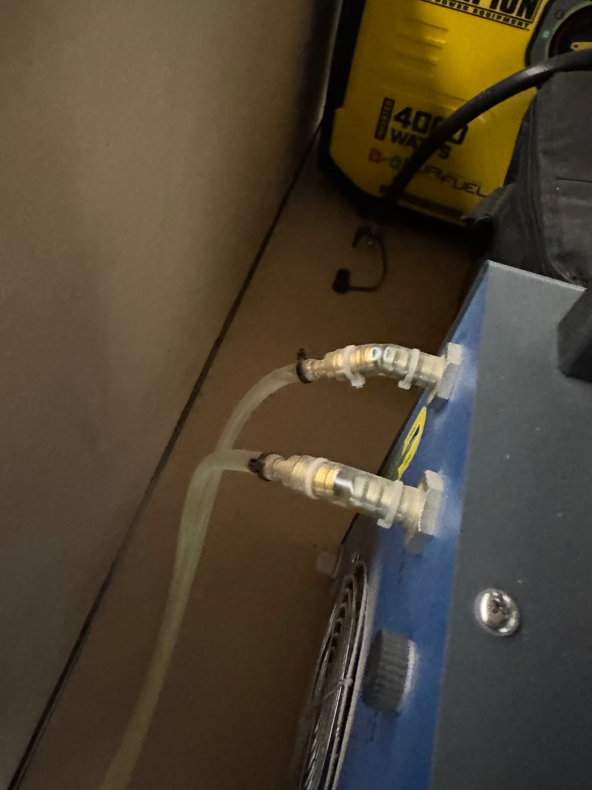

Im looking at chillers because I really like the idea of a closed looped system as well as having an inline temperature gauge and flow alarm built in. You can pick up CW-3000 chillers for about $125 these days. Though the one problem I see is that their inlet/outlet nipples are all 10 mm which is .39” Of course the ID of the tubing we use on water cooled spindles are 1/4” . I’d rather not go through the hassle of trying to change out the fittings on the back of the chiller (finding the metric thread size and smaller nipple size would probably be a nightmare) Obviously people are getting around this as chillers are being used on water cooled spindles every day. I did buy superthane tubing which is pretty flexible. I could probably stretch that over the nipples but if I couldn’t Id be going down the path I really didn’t want to go down by finding replacement hose end nipples. Curious as to what those that are using chillers experience has been

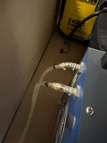

Here’s a photo of mine. I went to Lowe’s and got adapters from 10mm to 1/4” with some short pvc tube.
awesome.. ill look into that!
For the fitting side of this question, I’ve had luck warming up the tube with a heat gun and stretching it over the fitting, or using silicone tubing + band clamps or zip ties. It’s a pretty minor issue in the long run.
