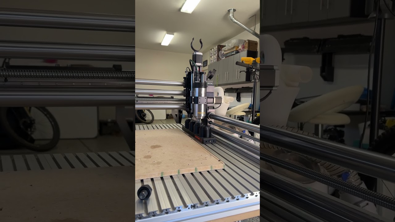

Awesome video. Which changer model did you purchase?
Thanks for the explanation.
The dust boot is another thing that was on my mind. At first I thought that I could just leave the boot on during the tool changes but then I realized that the ATC depends on seeing the spindle nut to recognize a completed (or whatever) tool change. This of course would not be possible with the dust boot mounted.
Tool recognition are now working too. Just completed the setup and testing. This is a safety feature of RCA to pause the job incase the loading and unloading failed.
The SD card you mention. What type micro sd card and size?
Also you say put it into the SLB+EXT (Alt Mill Controller).
Is there 2 types of SLB controllers?
Yes. Alt Mill is using different version of SLB, it’s called SLB-EXT. It doesn’t have integrated stepper driver as Alt Mill already have integrated stepper close loop driver in the motor itself. Also, it’s 48v system so it has more power.
I’m using U3 micro sd card, Samsung brand.

From their videos, it appears that Sienci is heading down the traditional ATC path with tool holders - a conservative approach that trades cost for reliability, track record and a bunch of other positive attributes. With no idea about what choices Sienci will make, a quick look for ER20 tool holders gives a range of $60 (Tormach) to $200 (Shopbot) for just the tool holders. You still will need collets and collet nuts for each tool holder. The good news is that the tool rack itself is so simple that it can be 3d printed and you can have as many tool holders as you have space for.
The RCATC makes different trade-offs in their quest to provide a lower cost solution by eliminating the tool holder and pneumatic drawbar mechanism. The RCATC system works by screwing and unscrewing the collet nuts from the spindle for each tool change.
As the meme goes, ā€œwhat can possibly go wrong?ā€ Things that come to mind include bit alignment, stickout, runout, consistent/sufficient clamping torque, reliability, etc…
The balancing consideration you/I need to provide is how much these differences matter to you based on how severe/frequent/significant you feel the failure modes might be. These, in turn, depend on your skill, your workload, your requirements and your budget.
An 8-position RCATC combined with Sienci’s spindle ($450 + 500 =$950) plus collets/nuts ((8 x 25) + (8 x 25) = $400) is about $1,400
A quick google search seems to show spindles with pneumatic tool changer in the ~2,000 to $3,000 range. This is double to triple the RCATC, and doesn’t include an additional $500 to $1,600 for the tool holders…
My evaluation of the questions above was that I was willing to invest an additional $500 for the RCATC and see if it worked - and if it didn’t, I was OK with manual tool changes. Because it was a ā€œnice to haveā€ for me, I didn’t feel it was worth doubling the cost of the base Altmill system to get a traditional ATC system…
I bought the 4 pocket RCATC. They were immensely helpful getting me set up, and I’ve been using it a few weeks. Fully satisfied. Sure it may not be accurate to a ten thousandth, but I’m cutting wood. My Z heights are within my paper test every time, and my two sided wing carve is translucent thin. My biggest concern was not tight enough, but I’m able to pause, and check that: it’s tight. And it checks height on every tool change. I can spend the few seconds, it’s worth the wait. Overall, I might even get another 6 pocket version and add to my set. 10/10, would do it again.
