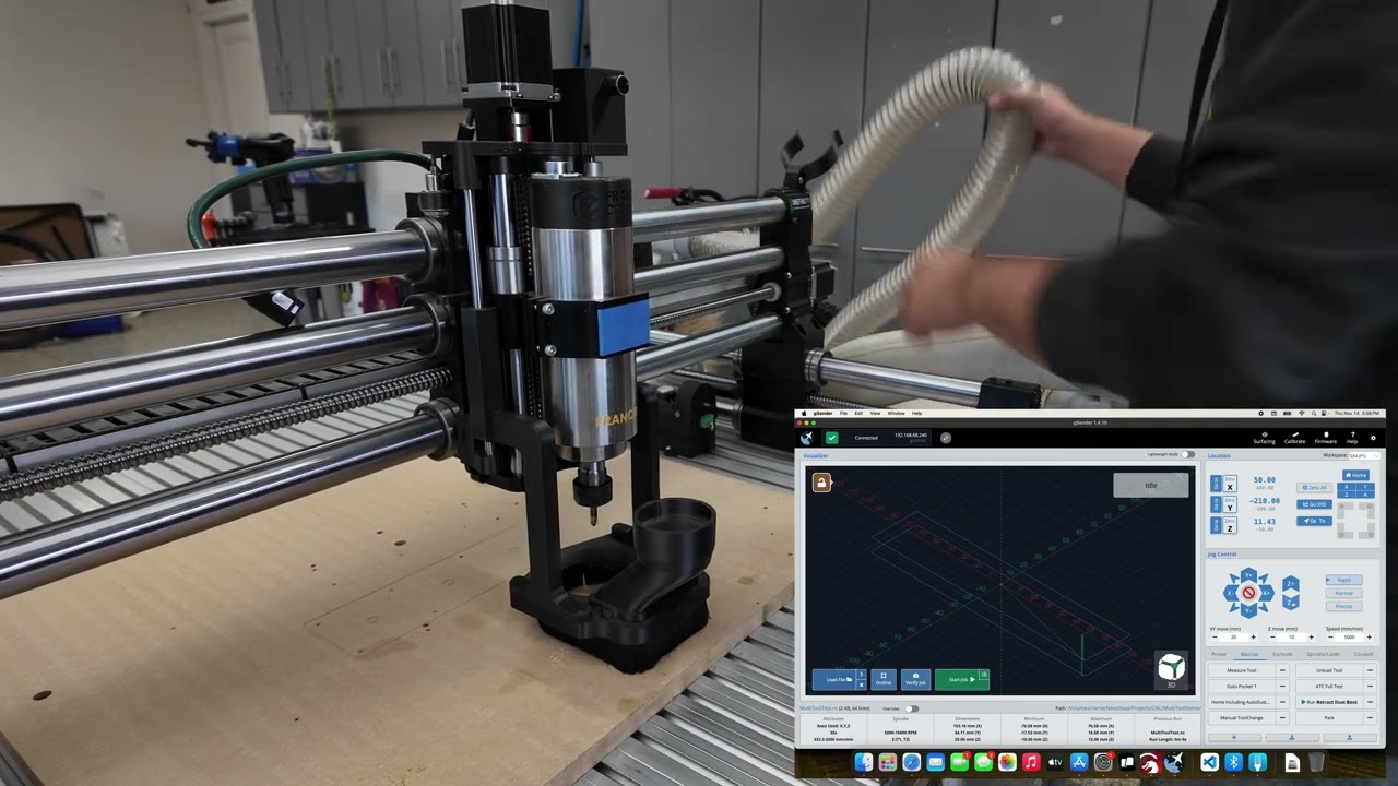

Here’s my SLB+gSender+RapidChangeATC+AutoDustBoot setup.
FYI, I’m using custom gSender version that I modified to make the M6 works with grblHal and skips the dialog confirmation window for M6.

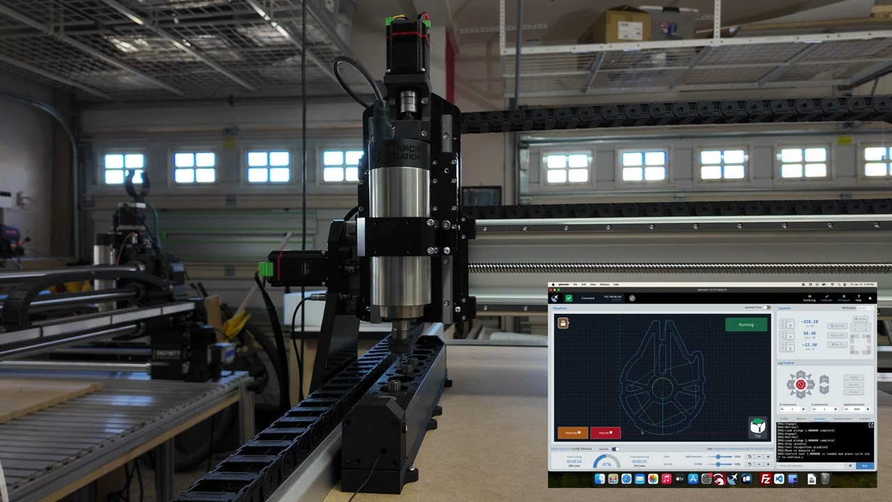

Here you go. First Alt Mill with RapidChange ATC fully working.

The only setting you need to adjust in the firmware is to allow a minimum speed ($31) down to 1200 RPM. I set mine to 500 RPM. You don’t need to keep changing this, as the spindle speed is dynamically controlled by your G-code during the job. The macros will also handle the spindle speed adjustment automatically.
Here’s how it works: In your CAM software, ensure it inserts the M6 Tx command for the toolchange, where x is the tool number. The firmware will automatically interpret the M6 G-code command and execute the tool change macros accordingly.
