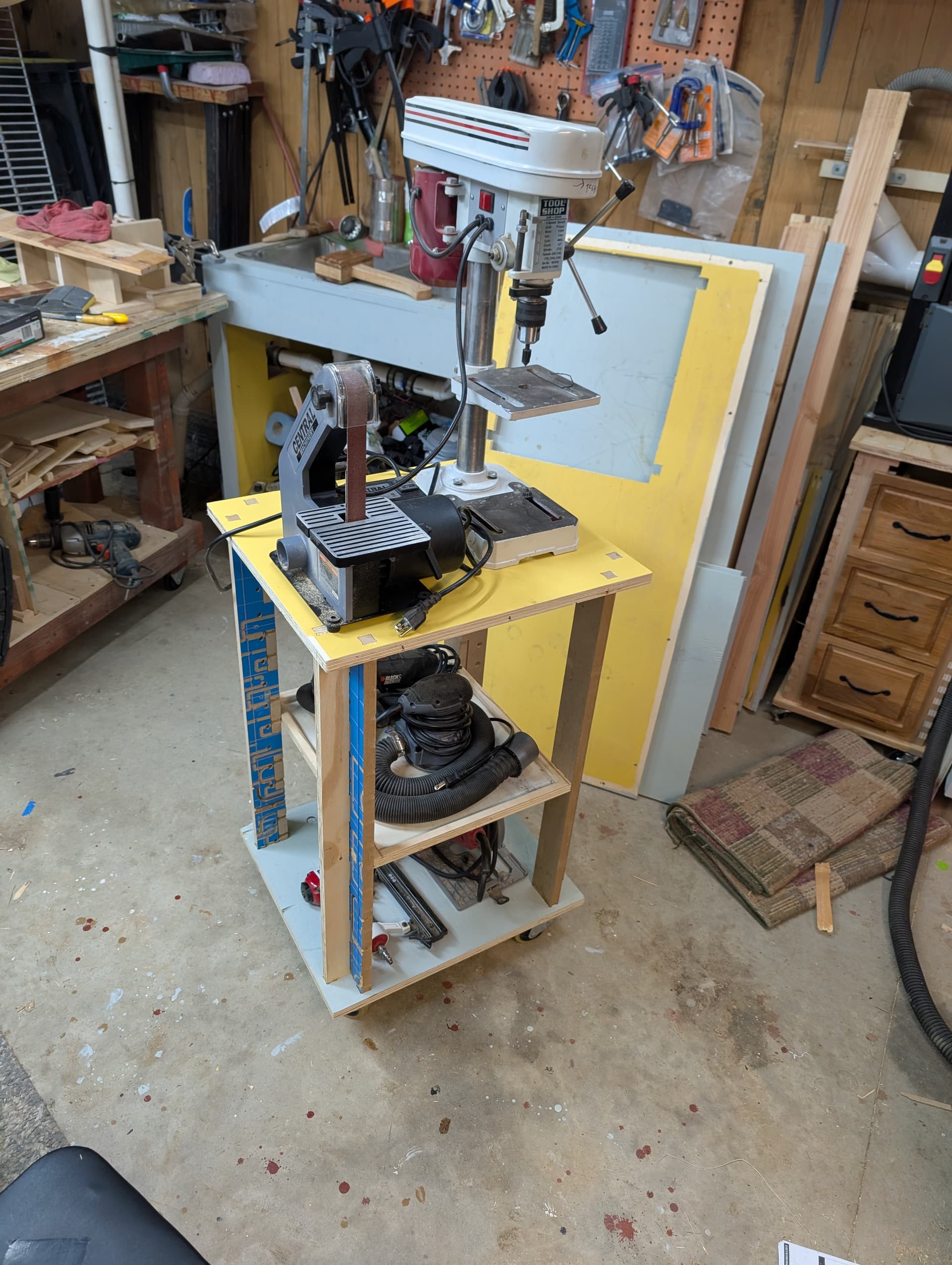

This is a great little table I’d like to put next to my Altmill for my laptop and all of my cutters and such. Do you have the files you can share?
Sorry for not getting back sooner. Not in an organized manner. Since it was a trial and error build I don’t have it easy to duplicate.
I should have an updated version in a couple of days that I will share here.
SandingStation.crv (3.4 MB)
With the exceptions on the Shelf all cuts are with an 1/8" up cut.
The WorkSheet is ideal sized and doesnt take actual wood depths into accoount
thus the corners don’t have fillets for example.
I consider the WorkSheet for display purposed only.
I made this tool stand using nothing but scrap pieces, this is why I have multiple cutsheets
instead of arranging everything onto one big sheet.
The Shelf I put extra work into mostly as pactice and to add a lip so parts don’t roll off.
The pocketing can be skipped which will save about 90 minutes of cutting.
On the actual cut sheets all corners have fillets for the 1/8" upcut. If you use a bigger
endmill they will need to be adjusted.
The TestSheet can used to check how tight the joints will be before making the larger cuts.
I usually use these type of sheets to adjust for wood thickness.
For my cart I used .76" pockets and had to file them slightly. I have since enlarged all pockets to .77"
you may notice the legs are a former spoiler board LOL i have a really hard time throwing
any wood away
Hi Lewis,
I just LOOOOOOOOVE the scrappy look on this one. Suuuure the bandsaw cart is amazing in its own right and believe me, if I love that one too, but this! This is what I think shop things should look. Reused scrap molded into something usefull. No care in the world for looks.
And that gives it thát “I am an effin shop cart, not a kitchen appliance your misses uses to arrange flowers on because I am such a cuuuuute cart, you moron” look.
The material Messy, smelly, greacey, old beyond believe, but good enough to be used into this useful thing.
The stories it tells by its scarrs alone! -Yeah I was a cnc spoilboard once-
Daaaaim!
-I like the whole feel your shop gives.- It gives the right fibes I feel a shop should give.. timelesness (?)
