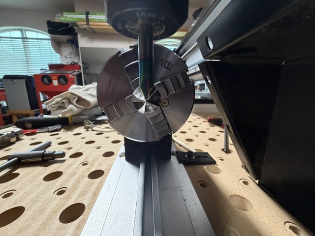

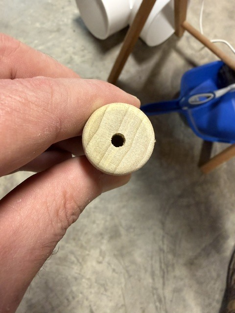

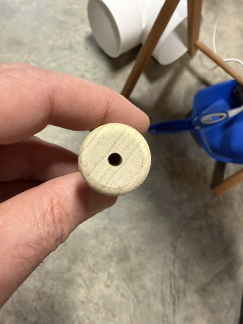

@cncConfusion How are you setting Y0? I can see by the pics that Z0 looks spot on. I can’t see how Y0 looks.

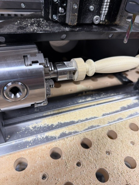

@gwilki Y is set with the rotary Y zero built in macro. It’s had to get a pic that shows it but I will will try again. It seems pretty much dead on to me. Stby
@gwilki Hopefully you can tell that it is pretty much dead on in these pics.

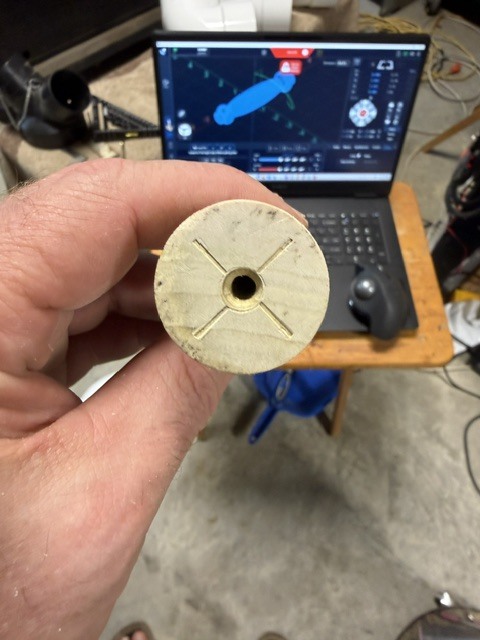

@cncConfusion I believe that I am stumped. The end-on pic of the left hand spindle in your most recent pic seems to show that neither the spindle nor the centre hole are round.
I want to go back a bit. You are chucking up a bolt in the headstock and it fits into the hole in the blank. How are you driving the blank?
At the tailstock, the live centre fits into the hole in the blank. Is the blank running on the cone end of the live centre?
Ideally, this is what you should have. You should have a dead centre in the headstock chuck. The cone at the end of the dead centre will pull the hole in the material the the centre of the axis. This pre-supposes that the cone in the tail stock is doing the same.

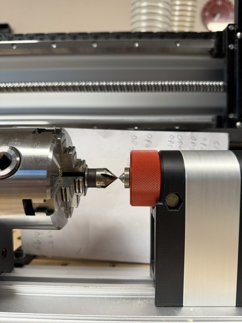

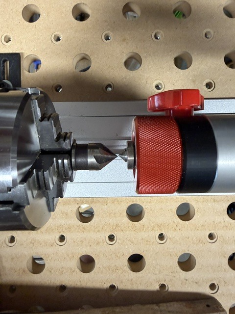

Last question: If you slide the tailstock up the the dead centre in the headstock, do they line up?
I’m not a turner so I refrained from responding to this post. But if I had to guess as to the cause of the problem, this would be the first thing I’d correct. The hole doesn’t seem circular and might not sit correctly on the cone. I’d suspect movement there during the carve.
@gwilki @Chucky_ott I think the hole not being round is just a trick of the camera, from what I can tell it is perfectly round.

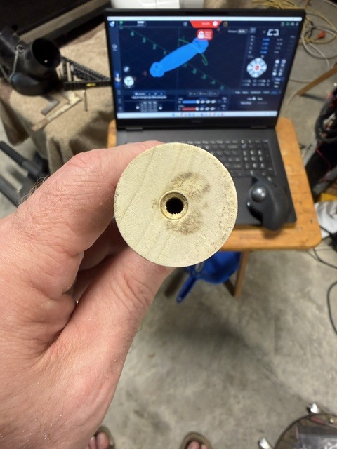

On the last two photos I uploaded on one I used a counter sink at the chuck centered in the predrilled hole and then the tailstock fits directly in to the hole as they are both 8mm.
The second one I used the new 4 prong center drive with the 8mm smooth shank and the same tailstock setup.

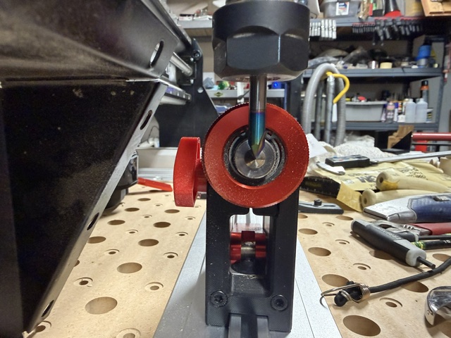

@cncConfusion The last pic seems to show that the headstock and tailstock do not line up in Y. Again, it may be a distortion in the pic but, if not, that is likely the cause of your issue.
It does seem to be a smidge off, not sure how I would correct that…
@cncConfusion IMHO, your issue is caused by your setup. I’ll try to clarify what I have said previously. Your best holding method would be a dead centre cone in the headstock and a live centre cone in the tailstock. The cones will automatically pull the spindle to center around the hole.
You seem to be using a rod and prong centre in the headstock. The rod must be smaller that the bore by a small amount. If it were exactly the same diameter, it could not fit into the bore. So, you have introduced some degree of slop at the headstock end. I can’t tell at the tailstock what is going on. If the tapered end of the live center is large enough to pull the material into centre, it should be fine. If, however, the straight part of the live centre is in the bore, again you have some slop.

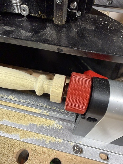

Some pics just for the hell of it.
@cncConfusion I would agree that it’s likely that it’s the tailstock end that is out because the 5/16" at that end it too big.
