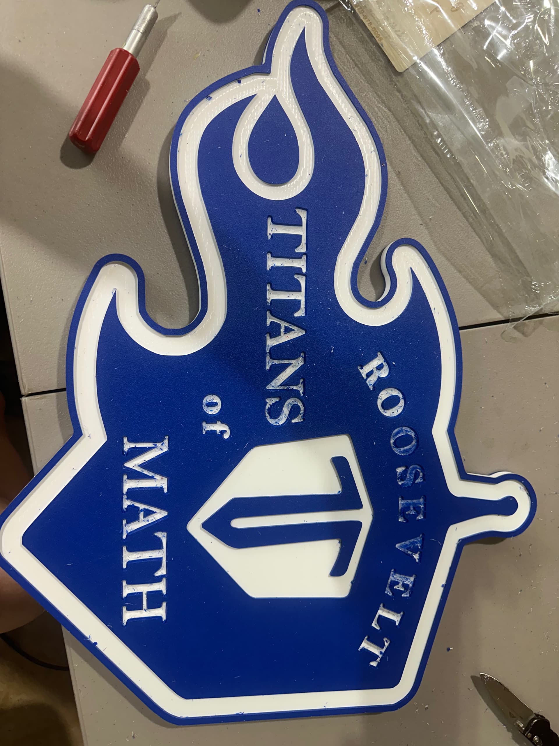

My daughter teaches 8th grade math at an underprivileged school. She goes all out to decorate the classroom. The school mascot is/are The Titans. I created this sign to hang in her classroom.
Color core is a neat product, but there is a lot of cleanup when using a V bit. (See the letters)
@BradGlock Looks very good. I’m sure the children will love it.
Two tips for future projects. First, if using a scraper style v-bit, run the same toolpath a second time to clean the cut up. Second, use a spiral v-bit for better cuts in anything.
Who makes a spiral up cut v bit?
@BradGlock I don’t know of any spiral up cut vbits. There are a few manufacturers of spiral down cut vbits though. Cadence manufacturing in the US has excellent ones. Pricey. SPEtools has good ones at a much lower price point. There are others out there, too. These are the only two that I have used.
Thanks. I’ll look for spiral down cut v bits.
