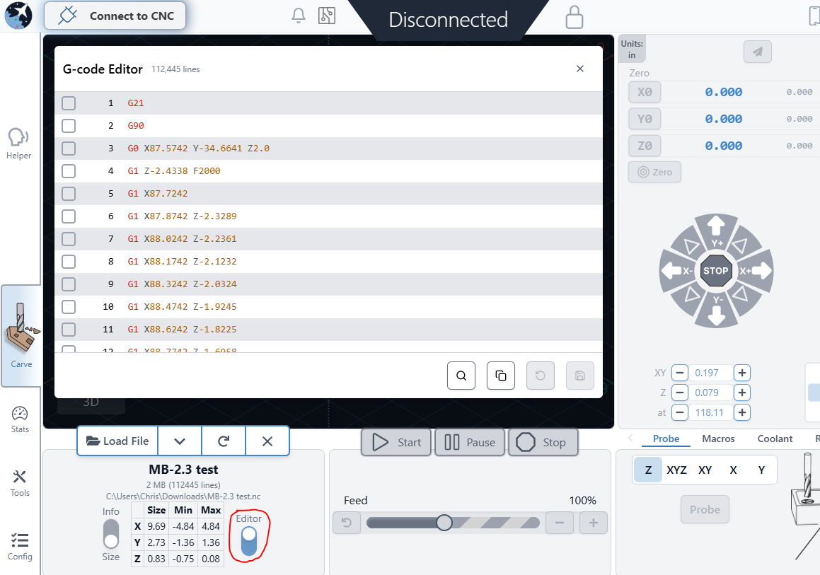

Simple gcode editor built in
this would be a great addition.
Agreed, I thought this was a good idea 18 months ago
Do you mean to edit the gcode after its loaded into gSender or to edit the gcode file and then reload the file after editing?
Simple feature to edit loaded gcode file before running it. I previously used BCNC and it had this feature. You could deselect entire section’s and lines, delete and edit. It would prompt you to save on file close. It came in really handy when a certain operation needed to be repeated for one reason or another or a tool was already loaded that would be requested on startup. Just uncheck a couple lines or a section and run it rather than going back to the other PC and posting another file or firing up a text editor.

It’s something we have in the backlog as a potential feature we’d like to add down the line. It won’t be in for 1.2.0 though, but will probably be on the docket for the next major release after that.

WHERE??? is the G Code viewer? There should be a code viewer where you can see for example if you need to start on a specific line you should be able to check the G Code and what line to start of from. I have NO WHERE where I can see the actual code???
Here’s a link to the one I use to review GCode.
Thx but what Im looking for is if there is an INTERNAL g code viewer in G Sender so you can see what line it’s on etc. Not external, any text viewer can view the g code.
Click the console tab in g-sender after you load a file, is that what you are looking for?
It would be really useful to be able to see the actual gcode currently being executed including any comments encountered on the console tab. The comments are actually more important to me than the gcode. Let me explain why:
My Fusion360 tool library has descriptions for each tool which automatically get posted as comments in the gcode file. Being able to look up and see them at each tool change it super handy. Coming from an industrial environment, I have always used this technique (with other CAM software as well and many many other CNCs). Even when you have a physical printed setup sheet in your hand that calls out each tool used by a job, the comment in the actual program confirms it thus further minimizing the chance of a wrong tool being loaded.

I just purchased an SLB and I am trying to reacclimate with Gsender, I sold my long mill 3 years ago to upgrade before the AltMill was a thing. The past few years I’ve been using OpenBuilds Control, one of the great features is you are able to access and edit the code directly from Control’s interface. Sometimes I may want to add a G4 for a pause to let the spindle ramp, a M6 or make some other quick adjustments. It would be nice to beable to view and edit your Gcode inside the tool and save the step of opening in a text tool
It would be nice to see this,
It’s definitely on the list as something we’d like to add (at least a viewer), but no timeline.
couldn’t agree more. I have worked with all sorts of industrial CNCs and I have never ever seen one where you cannot see the code that is being executed…including comments.

Hey all, not sure if you’ve seen but as of recent there is not a g-code editor in the new Edge versions of gSender! Try it out and thanks all for your initial comments, hope you enjoy
